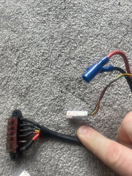

  3. I have been messing about with carrera ebikes for a while now and all the previous controllers had data lines but would work fine without them attached to the battery. I have come across a vengeance 2.0 setup and I don’t have the correct battery or harness and all I get is error thirty three. which is down to data lines to the battery. I do have carrera batterys with data pins and a older loom but the data lines are on a different plug and defo different colours. Do any of you chaps know what wires are the right ones to join to each colour. ? There’s a pic of the only two spare plugs im assuming the two wire one is the unused lighting option that’s on all their bikes and a pic of the loom off it’s predecessor. The torque sensors are different plugs too but identical. So these probs will work with the right colours joined lol

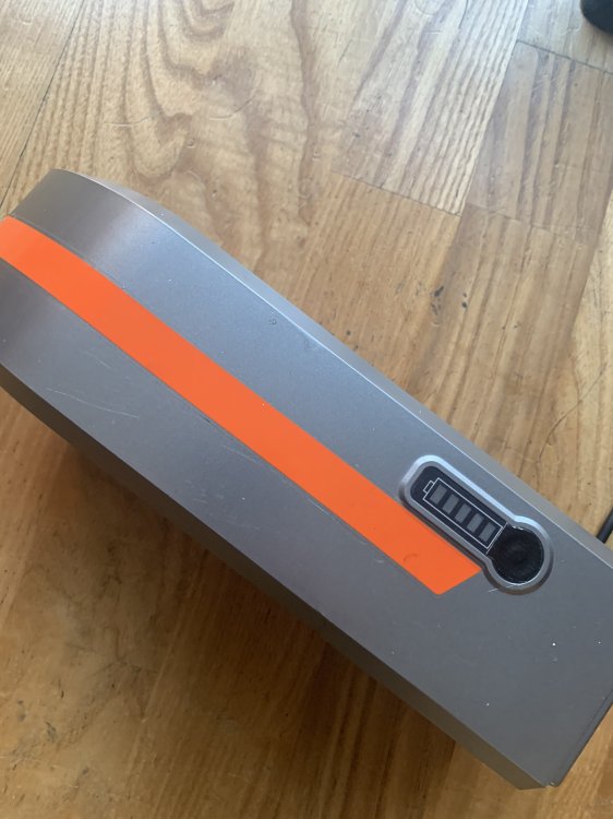

  6. Hi thanks for ur reply the battery wasn’t full the thing has water Ingress thru the button cover that breaks on all these batteries. The bms was a acting up keep going off etc too so the plan is to replace the bms with one off eBay will any 10s 30a 36v bms work and then just use a different charger not the 5 pin suntour one.... also do the bms off eBay have built in cut off if there’s a issue with the bike? Thanks for ur time

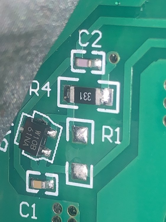

  12. Hi I will take some more pictures when I take it apart again or of the parts motor I have. It is a intermittent problem got me sick of it lol. I done 17 mile no error yesterday and i went over some nasty bumps then today done about a mile stopped waited 30 sec for my missus to catch up and bang e42. It’s a nitemare are them halls a direct replacement I mite just change all three of them I just ain’t sure it’s not some off the rest of the surface mount things on there that’s causing it.
  13. Here’s the picture I shudda attached the first time lol I have a spare motor but iv swapped that and it’s the same. Is there a way to test the three halls I must have 3 good chips on two motors to sort one out with.
