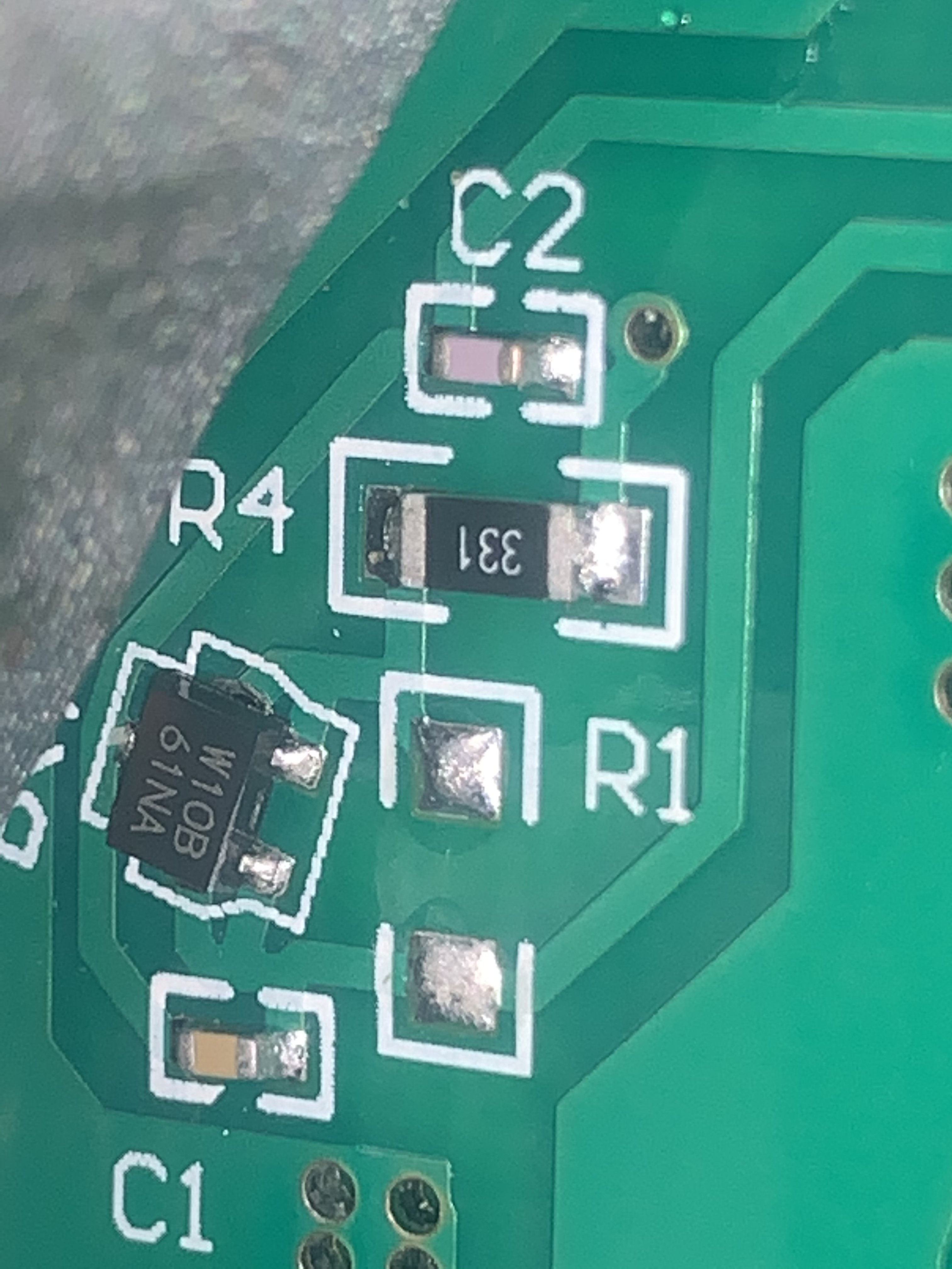

  12. Hi I will take some more pictures when I take it apart again or of the parts motor I have. It is a intermittent problem got me sick of it lol. I done 17 mile no error yesterday and i went over some nasty bumps then today done about a mile stopped waited 30 sec for my missus to catch up and bang e42. It’s a nitemare are them halls a direct replacement I mite just change all three of them I just ain’t sure it’s not some off the rest of the surface mount things on there that’s causing it.
  13. Here’s the picture I shudda attached the first time lol I have a spare motor but iv swapped that and it’s the same. Is there a way to test the three halls I must have 3 good chips on two motors to sort one out with.
  14. Hi i will test them like u say later on when I get back. I just thaught they should all be the same as the good bike there all the same cheers for you’re help
  15. Hi I have a Vulcan. And the thing e42 errors when it feels like it and works fine for 10/20 mile then away again. Iv made a lead to allow me to test cable on the bike and tested the voltages on the hall sensors and on a good motor I get around 2.5volts with walk button held in on all three colours and on the one that errors I get: Yellow 1.96/7v Blue 2.61/2v Green 1.25/6v. Iv attached a pic of the Hall circuit there’s Three of them any advice on what to change to fix this would be great.
  16. Hi I have a Vulcan. And the thing e42 errors when it feels like it and works fine for 10/20 mile then away again. Iv made a lead to allow me to test cable on the bike and tested the voltages on the hall sensors and on a good motor I get around 2.5volts with walk button held in on all three colours and on the one that errors I get: Yellow 1.96/7v Blue 2.61/2v Green 1.25/6v. Iv attached a pic of the Hall circuit there’s Three of them any advice on what to change to fix this would be great.
