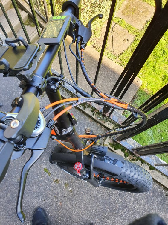

  5. Hi, I have a foldable fathweel 500W bafang geared hub motor Ebike, Id like to know if its possible to swap the controller for a KT 1000w as the KT's pedal assist is much smoother. this bike comes with a 48V battery but says 36V on the controller. it also doesnt have a PAS disc. so Im guessing its got like a bottom bracket sensor or something. pictures are below
