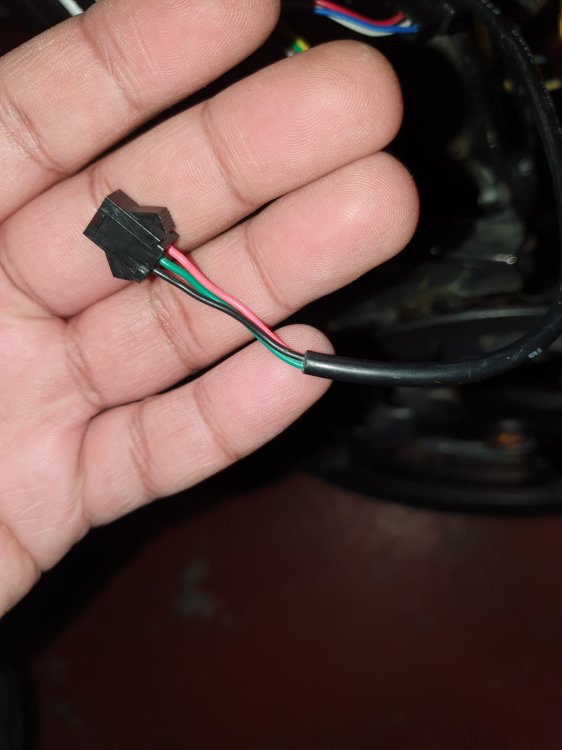

  16. this is throttle that came with the wheel kit its wires are the one i posted earlier on the red white blue. iv managed to swap the wires on the KT throttle wire and the PAS so they match. now everything is working. note: the wheel kit came with a different controller that doesnt support an lcd so i had to get a KT
  17. thanks alot. one more thing, the ebike kit came with a throttle that has a button and screen built in, can I also use that on this kt controller and which colours go with which? ikno the other green yellow grey is for the screen so dont need it.
  18. Alright so thr colours on the throttle must match? For the pedal sensor red with brown, black with black and green with yellow?
  19. Hi,just got a KT 1500w controller, the walk mode works but the throttle and PAS dont. here is the wiring. the first pic are the wires frm the controller. the second is the wire from the throttle and the last is from the pas sensor. i connect the throttle red black blue to the controllers red black blue but nothing. I have also configured the lcd3 for the throttle to work without Pedalling.
