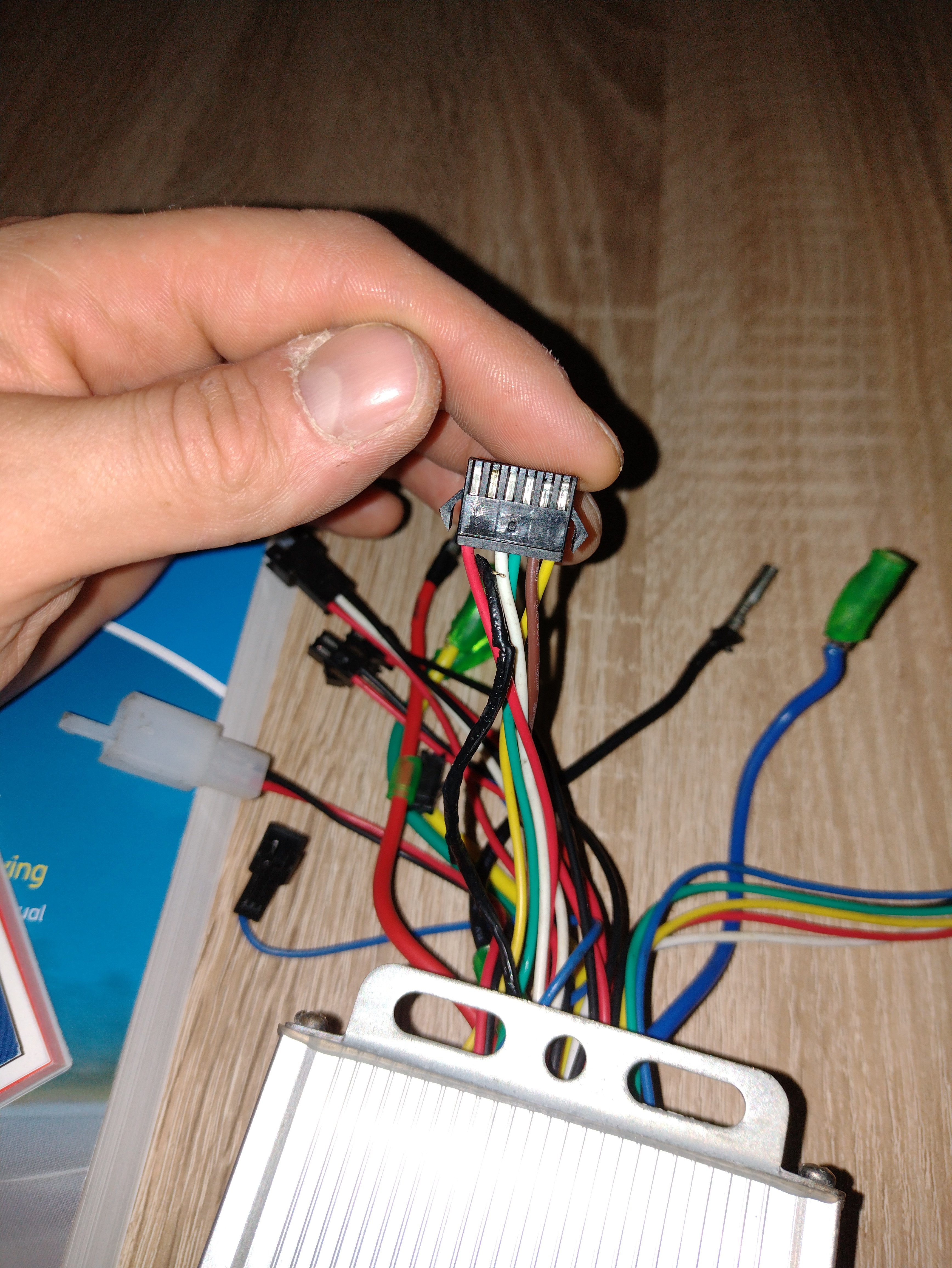

  6. It did not unlock. I was riding uphill with throttle at 20-30% turned to cruise next to a walking person. It cut power for a moment and came back 2 times. I thought it was my finger slipping, but now i know it was already shorting. Finally it simply stopped and i saw smoke come from controller pouch ( it's half open for ventilation ). I cut battery power, put bike aside to see if anything else might happen and then inspected to find controller only mildly warm so i thought i might have blown a mosfet. I had to pedal home and it was as if i was pedaling my road bike on highest gear up 10% hill. I had to use all my weight standing to pedal and the wheel was making clicking sounds constantly. I knew that something was terribly wrong with hub, but it was hard to push it as if with brakes for 2kms. At home i dismantled all controller and checked every single cable. It was one of the six throttle cables, black which melted completely. Did not find signs of damage anywhere else on the bike including motor cable.

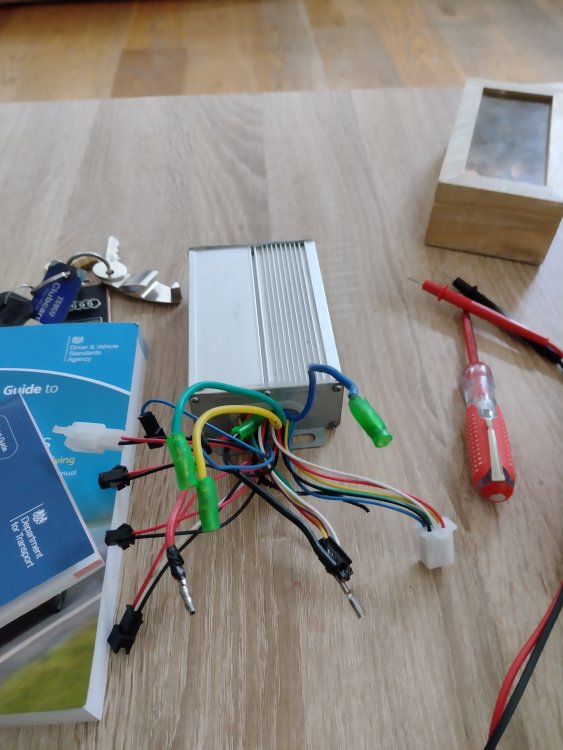

  7. I have dismantled the controller, none of the mosfets are imploded, no blackness anywhere, cables completely fine except the throttle black cable. But chip and everything looks absolutely fine. I had everything disconnected to check every single cable and the wheel is locked. I am able to force spin it, but if you push it with force and let go it goes maximum 1/10th of a rotation and halts. Yes it is a dual mode controller. I assume i have no chance to change the hub wire myself, or it would cost nearly as a new hub?... Looking at it from outside it is the same as always, i assume damage is done inside ....
  8. Hello, Long story short. My 36V throttle, black cable literally went up in smokes while i was cruising uphill. The problem is it fried on controller side. I normally never use it so it does not matter to me, however i have no way to turn my bike on(motor on ). Sensor is not working if i put battery in place and switch it on. Also on top of everything the rear hub "locked" it is very hard to pedal now and it makes clicking noise as if big gears were turning if that makes sense. I fear the short circuit told controller to do something like lock electrical break or something ( which i do not have ). Do any of you think that buying an lcd display would help me fix the problems, by being able to thun on motor etc? Thanks. PS : i have a soldering kit and multimeter and no experience , i could attempt to change the black wire? Bike stats "23a and 36v controller" and 48v battery ( 13amp).

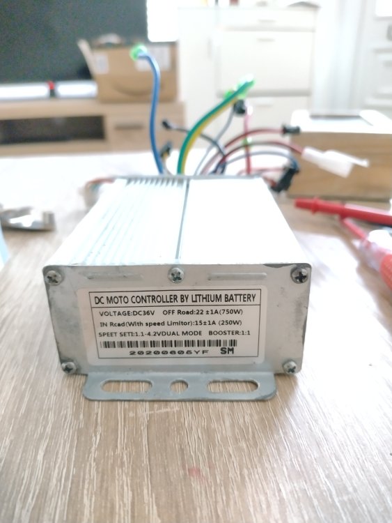

  12. Can you elaborate regarding regarding the 22a at 48V? Since controller is 22 and battery is 48, that means controller voltage is not important?. I have close to zero knowledge about electronics sorry
  13. Okay i assume what you mean is acceleration is harder on controller than staying at high speed. I red in another thread that having different Voltages between controller and battery/motor will cause damage. I guess i red wrong.
