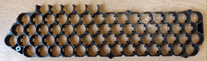

  4. Yes I take your point about the positive and negative connections being close together, but the beauty of doing drawings first and then posting them on forums like this is that I can get feedback. I'm pretty certain I can re-design the layout so that the terminals aren't so close together or even at opposite ends of the battery... I'm on it.
  5. Maybe I'm asking too much but, it would be nice if the manufacturers of cell holders be it for 18650, 21700 or 26650 cells etc, would at least provide a diagram of how one would typically configure some cells into their products. Because of the shape of many bicycle frames it's not always easy to just install a square or rectangular battery pack which makes for a simple X,Y matrix layout I know that there are a few combinations possible for a given cell holder but it can't be that taxing to just at least have an online link with a page of battery cell combination graphics say for 36v, 48v or 52v batteries, (for e-bikes) I think those voltages are the most common although I know there are others. I have put just one set together here on my computer with a picture of the cell holder in question but it took me absolutely ages. Hopefully I haven't made any errors. Correct me if the pictures are wrong.
