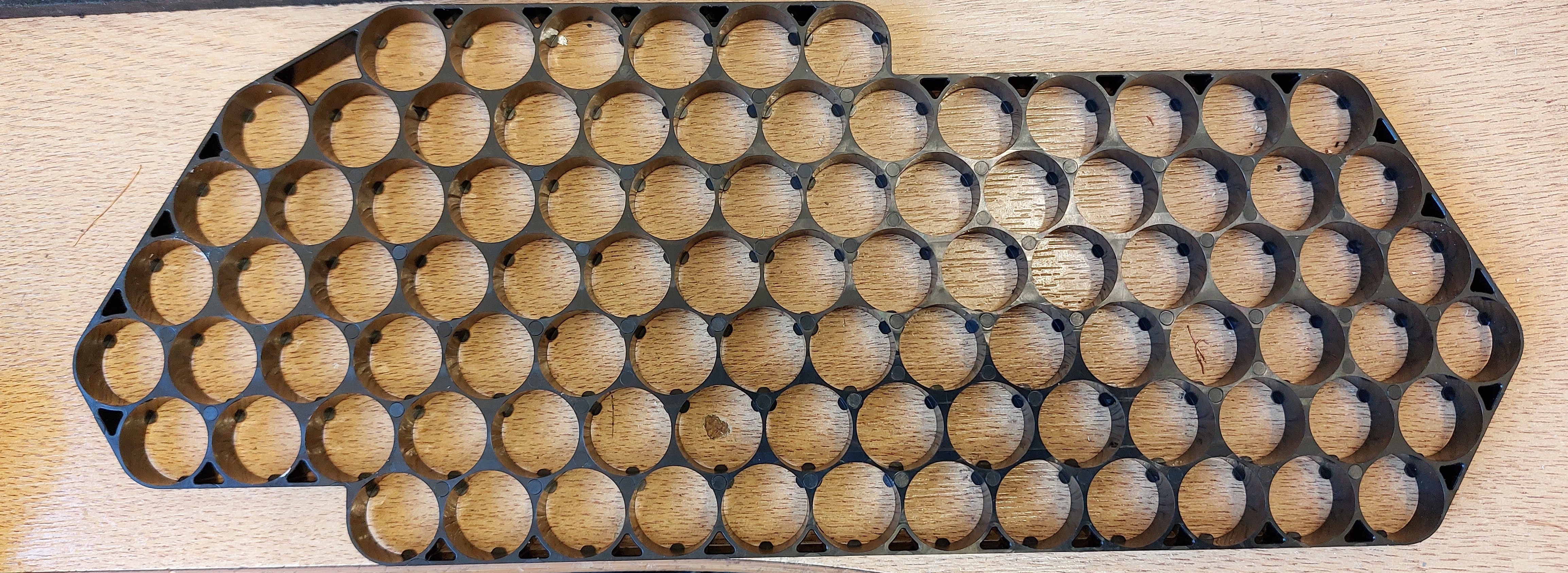

Hi everyone, I've recently bought a battery case, but i don't know the best way to arrange the cells into the two cell holders that came with it. Is there an app that can arrange them for me or is there someone that has the same or similar cell holder? As the title says, I need a 13s7p, 52v battery pack. Please see the picture. Thank you in advance. Any help I can get would be greatly appreciated.

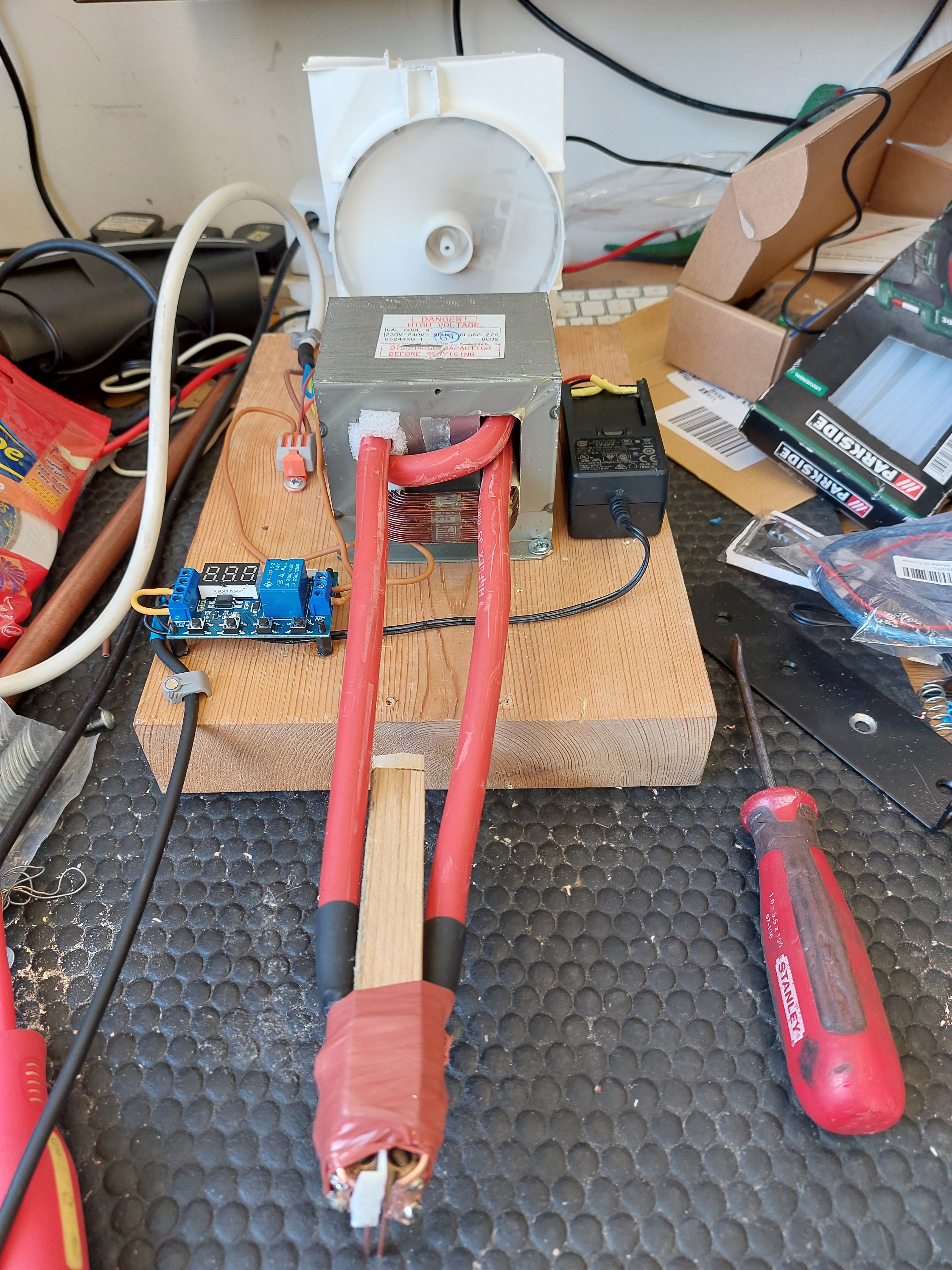

Thank you for your reply, I have about six months experience spot welding cells together , which probably isn't very long in the scheme of things, but I am confident enough to 'go there'. I understand that there may be serious implications if 18650 lithium ion cell battery packs are not assembled or treated with care. And I acknowledge your concern when it comes to welding equipment, I have to admit that I did build my spot welder myself but it has worked flawlessly since I adjusted the duty cycle timing.

Hi, Thanks for your reply. I fully understand the relationship between cells in series and cells in parallel, or a combination of the two. My cell holder is of an irregular shape and I just need to know the best way to create a 13s 7p battery pack with the cell holder I had. (see picture). I was ok with the first few cell groups but things became more awkward towards completing the pack.

It wouldn't surprise me if some people considered me a novice, as I've only been building batteries for about 6 months now. The spot welder I used was one I built myself out of microwave oven parts and a few additional components from amazon and ebay.
I really wouldn't know what to recommend for a novice because I've only ever used my own diy spot welder, but there are plenty of commercial ones out there. I would probably start with reviews on youtube first and then take it from there. I just thought it would be more fun to build one myself.
My that does look complicated. I don't know whether this large image is in any way helpful.
Thank you so very much for what appears to be the solution to my problem. This is exactly what I've been looking for. I have tried so many different cell combinations myself without being totally satisfied with the layout.
Once again, you have my sincere gratitude and have possibly saved me many more hours of trawling the Internet. Fantastic.
Yes, the home-made spot welder looks a little complicated, but it really isn't. Planning and research is the key I guess. There are lots of examples and variants of what I've built. Especially on Youtube.

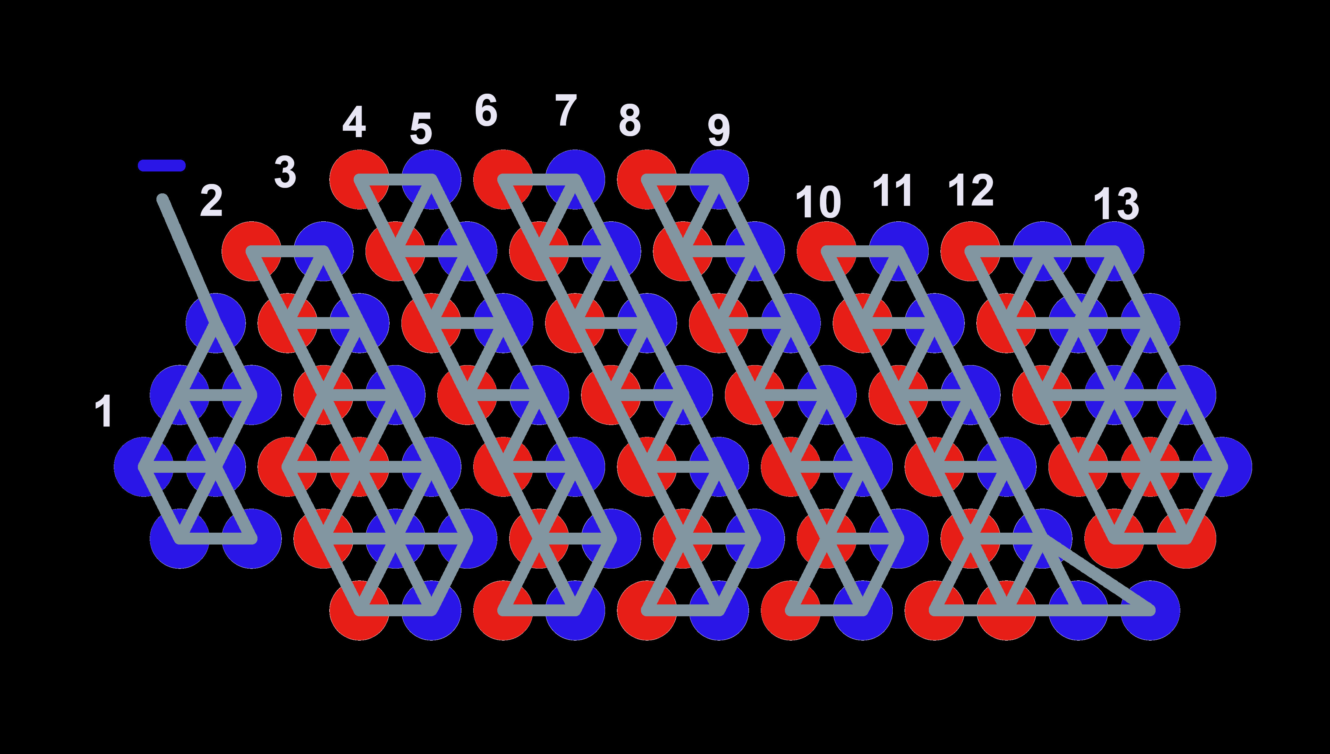

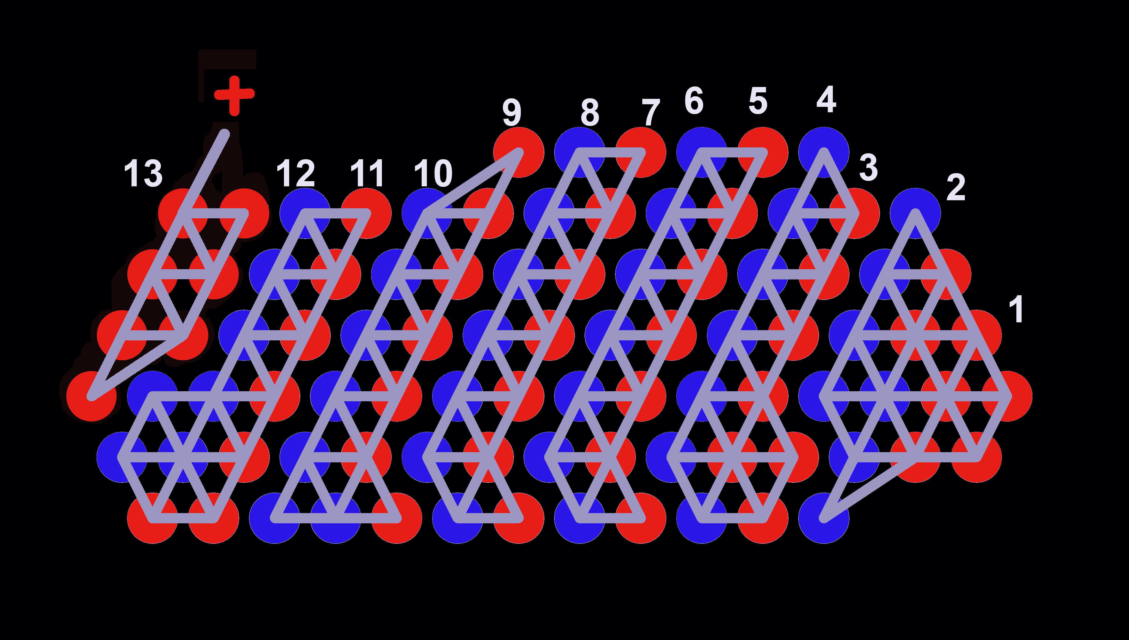

Hi, I put together these drawings on my computer to illustrate how I plan to spot weld the cell groups together based on the photo John Jones posted recently on this forum. I would be grateful for your comments. Hopefully I haven't made any mistakes. Any improvements or corrections to my battery pack would be welcome. If all is well then I will put together a graphic for the BMS wiring as well.
I saw that you have now coloured both positive and negative ends of the cells and added the welding strips, it's very clear that you take great care. Congrats.

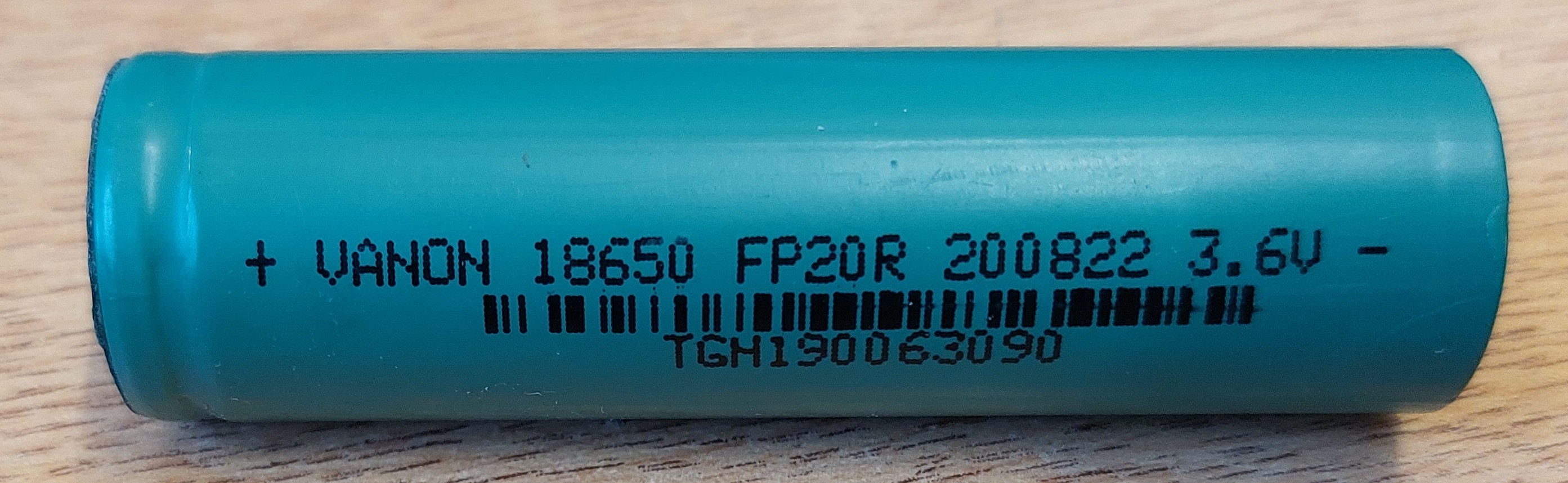

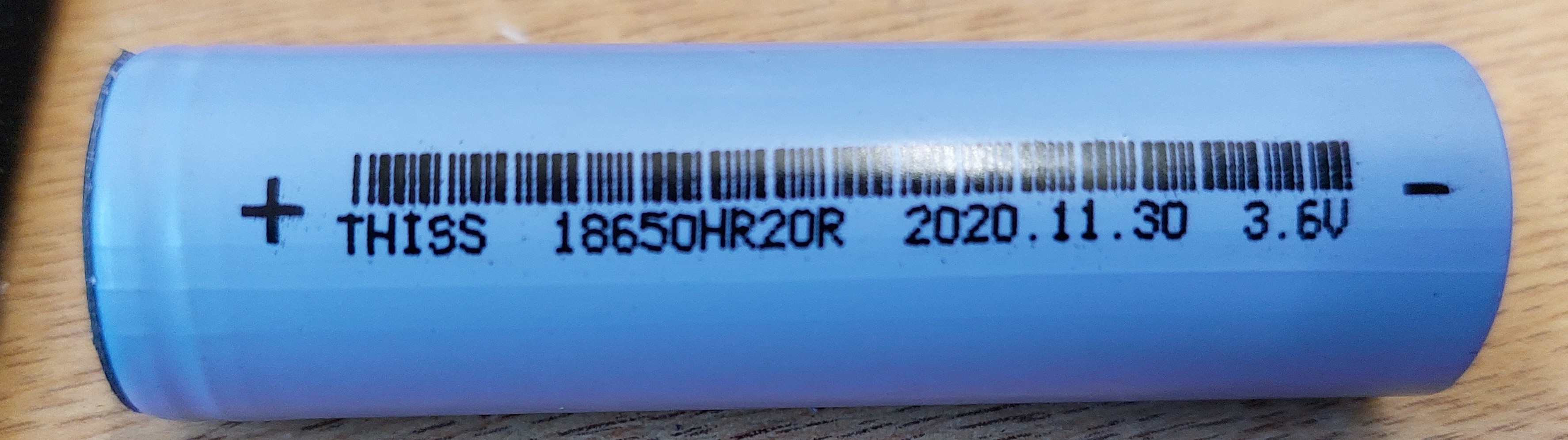

These are the battery cells that I currently plan to use in my battery packs. I have two sets:-
VANON 18650 FP20R 200822 3.6V / THG190063090
THISS 18650HR20R 2020. 11. 30 3.6V
As I understand it, these cells should be suitable for my battery packs because they were intended to be used in high current drain power tools.
