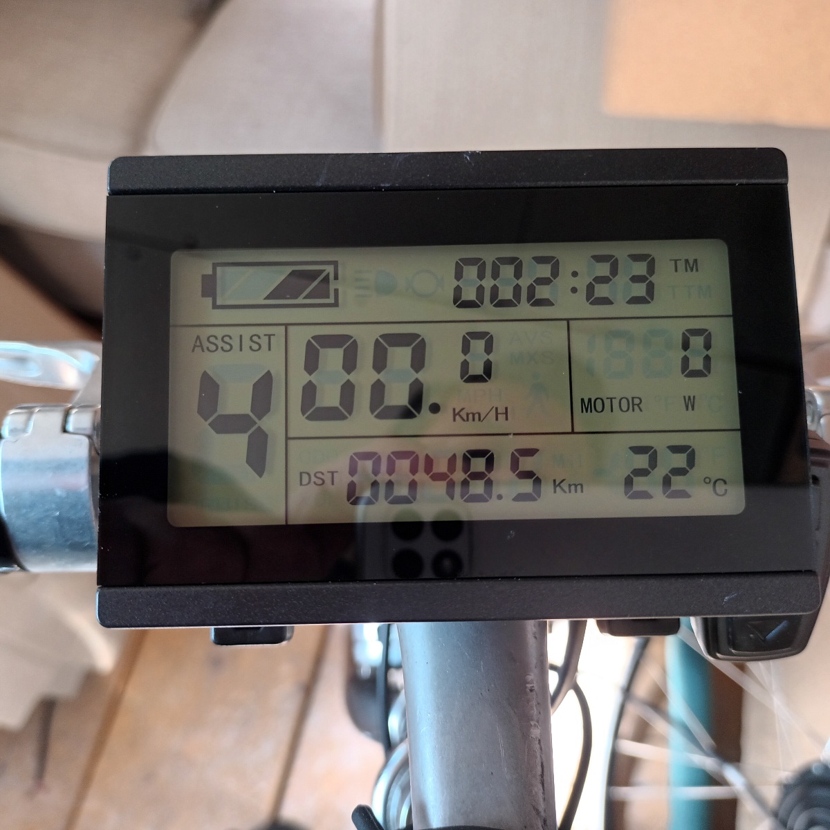

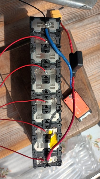

  4. I've been testing the battery on my commute. Range and reliability are my two main needs. Running through the miles so far with over 30 miles and half battery remaining. This is on 4 as standard and 5 on hills. I'm one who doesn't see the point in using pedal power if you've got a battery. So I want to test properly on real world usage. I chose LCD3 as I anecdotally believed that this would tell me some power info that my trusty little LCD4 won't. I'm yet to see it so am I missing something? I can see the watts drawn (typically 220W and higher at start) and that it is 36V. I was hoping it would tell me something else, say how efficient the battery build is? Sandwich method aside, am I safe with my 0.15 nickel 10S2P 10A little build? Thank you

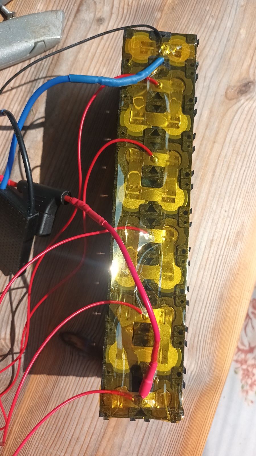

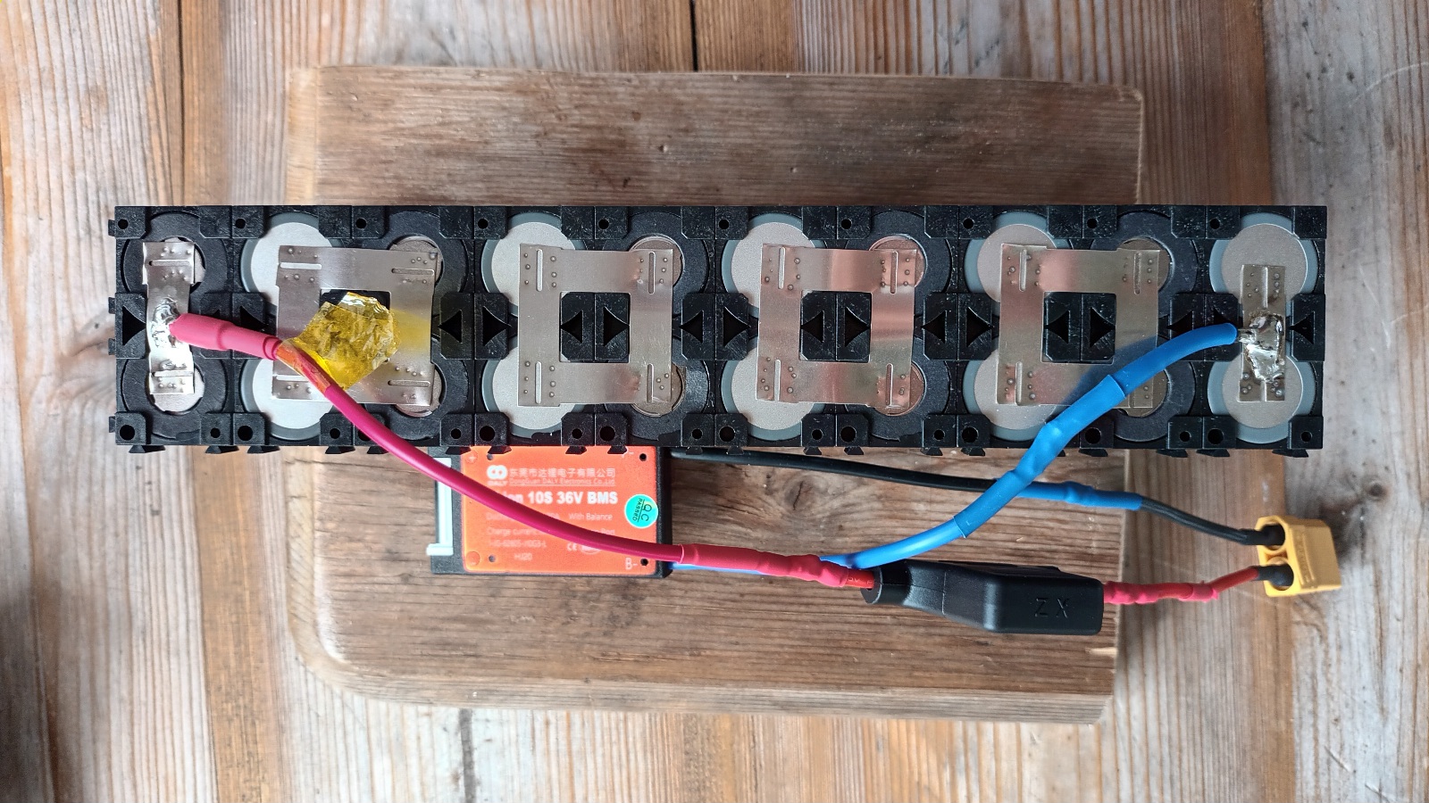

  5. These are LG M50LT 21700 with 5Ah and max discharge 10A I've attempted the copper/ nickel plated sandwich and will need a more expensive welder. Also, have read through the forum thread (thanks) and it seems that, even with a KWeld, many are having hit and miss with the strength of the weld (my main concern). So, I'm wondering if 0.15 nickel is just fine for my 10S2P 10Ah? I don't know the maths of it all. But I get good welds and my battery is working so far. Also, my controller is continuous 7A but max 14A. So assuming that's sufficient? Any sticky thread on the maths of battery making would be appreciated. Thanks

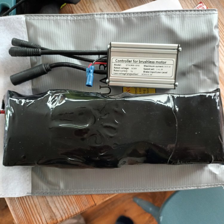

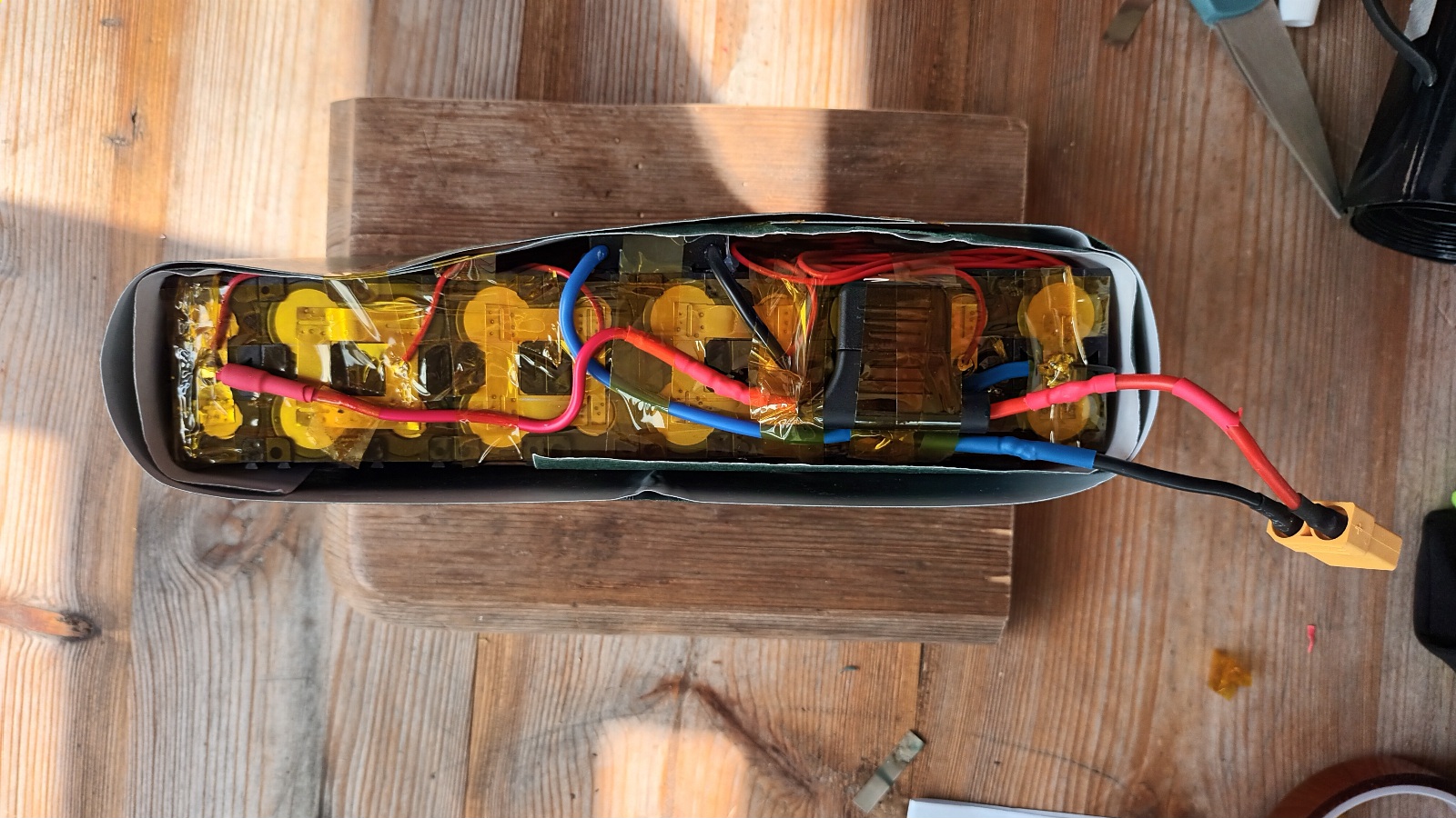

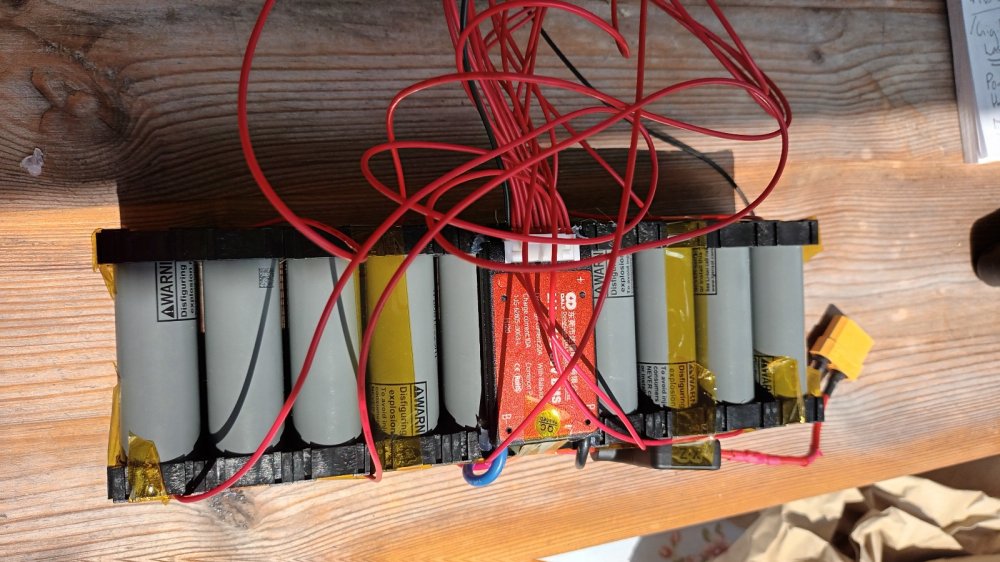

  8. Hi, I have completed a 10 Ah battery and, as well as my own learning, would appreciate thoughts and improvement suggestions relating to safety, performance and electrical maths. Key points: 10S2P using branded 5mAh cells Daly 20A BMS Waterproof Common Port 30A Internal Fuse 0.15mm nickel strips 17A 200W Cables XT90 connector 7A KT controller BMS wiring *will need to lengthen wiring to house fuse outside heatshrink battery wrap Spot welds of 0.15mm nickel using SEQURE SQ-SW2 welder *ok but could upgrade welder* BMS soldering Covered all points with heat resistant tape Hot glued BMS. *Far too much length on BMS wiring. Thinking will cut to size? Surrounded with battery insulation paper Wrapped in heatshrink and will house in LIPO bag. * Thinking upgrade to 14A controller with XT connectors Thank you for your time

  12. So I sourced a Daly as I wanted the waterproofing and now realise it is common port. Regarding the charge, what connection are you using to go from XT60 to a common charger? I am using XT90 but can only find this with a male charging connector. I would have thought that it would need to be a female connection and a common charger plugs the male connector into a female port which is wired to the XT60/90? Thank you

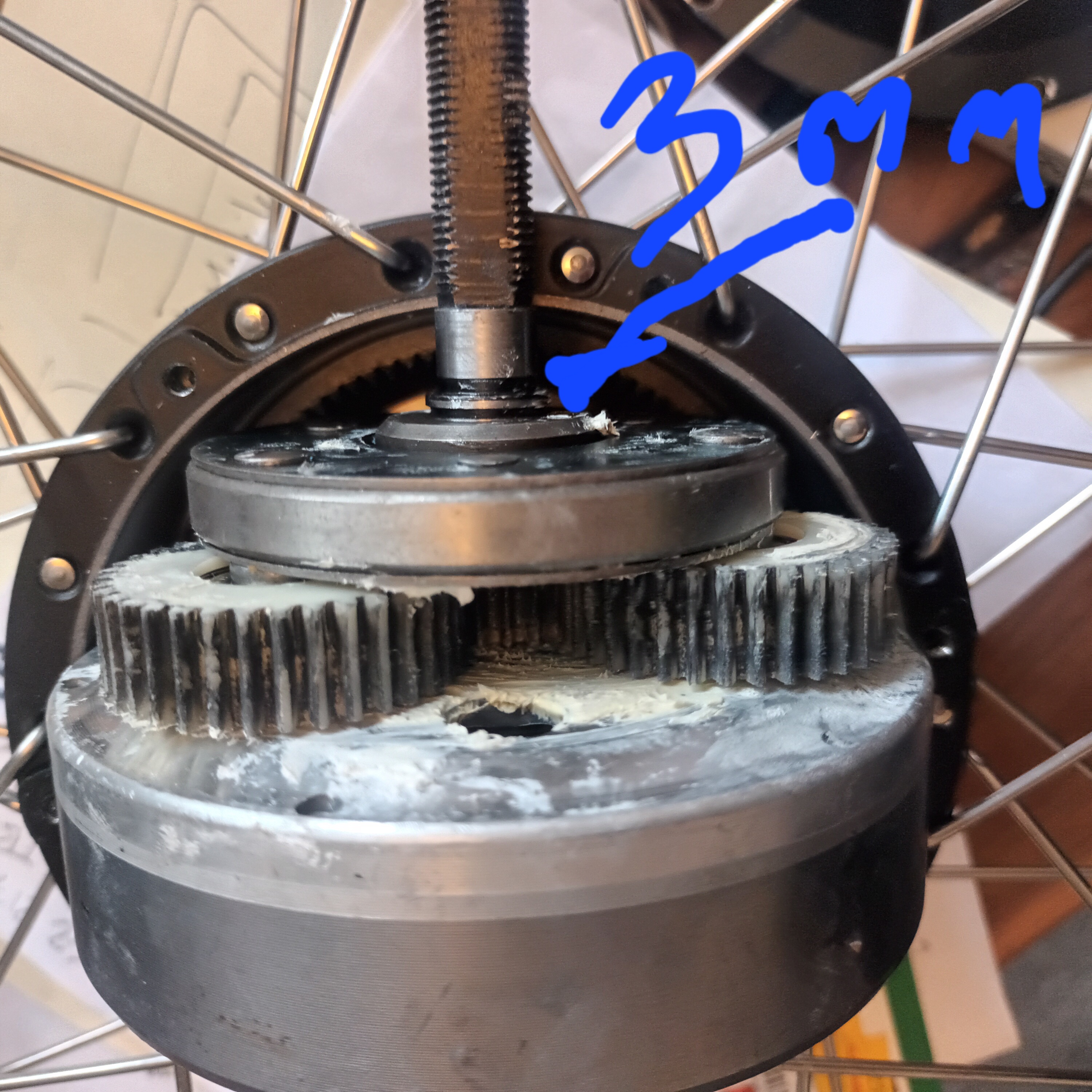

  16. Hi pedelecs, Anyone with experience of hub motor noise? It sounds like a consistent but relatively quiet rattle. I've removed the motor out and the gear cogs could be more flush. There is a 2-3mm gap near the circlip which allows the gearing to give across the axle a little. See image attached. I'm wondering if that could be doing it? Will a thicker circlip do the trick? Your thoughts appreciated, as always. Best wishes
