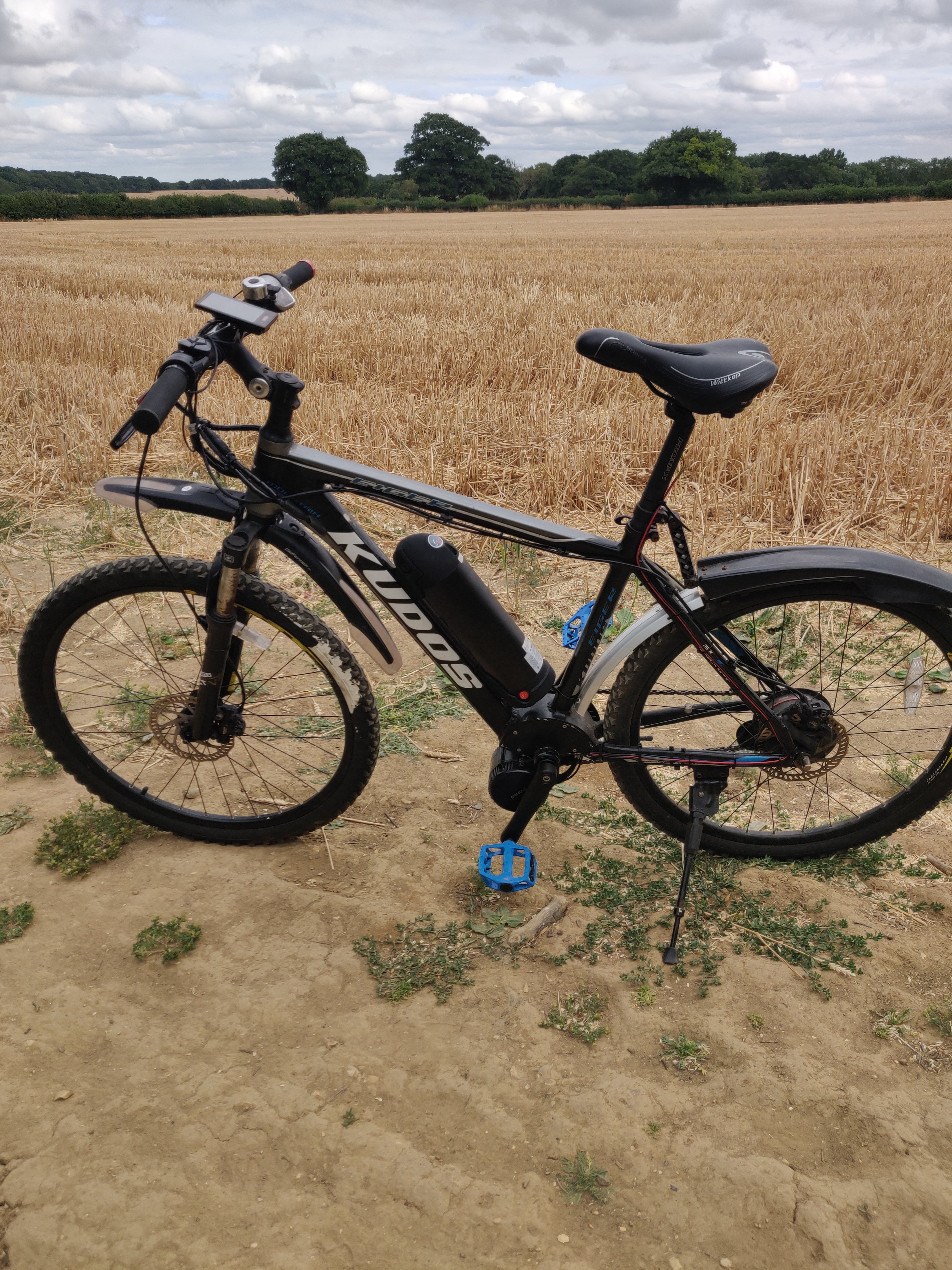

  1. Finally finished the Eiger, rides great , solid assist and throttle. [ATTACH type=full" alt="48483]48483[/ATTACH]
  2. Finally finished the Eiger, rides great , solid assist and throttle.

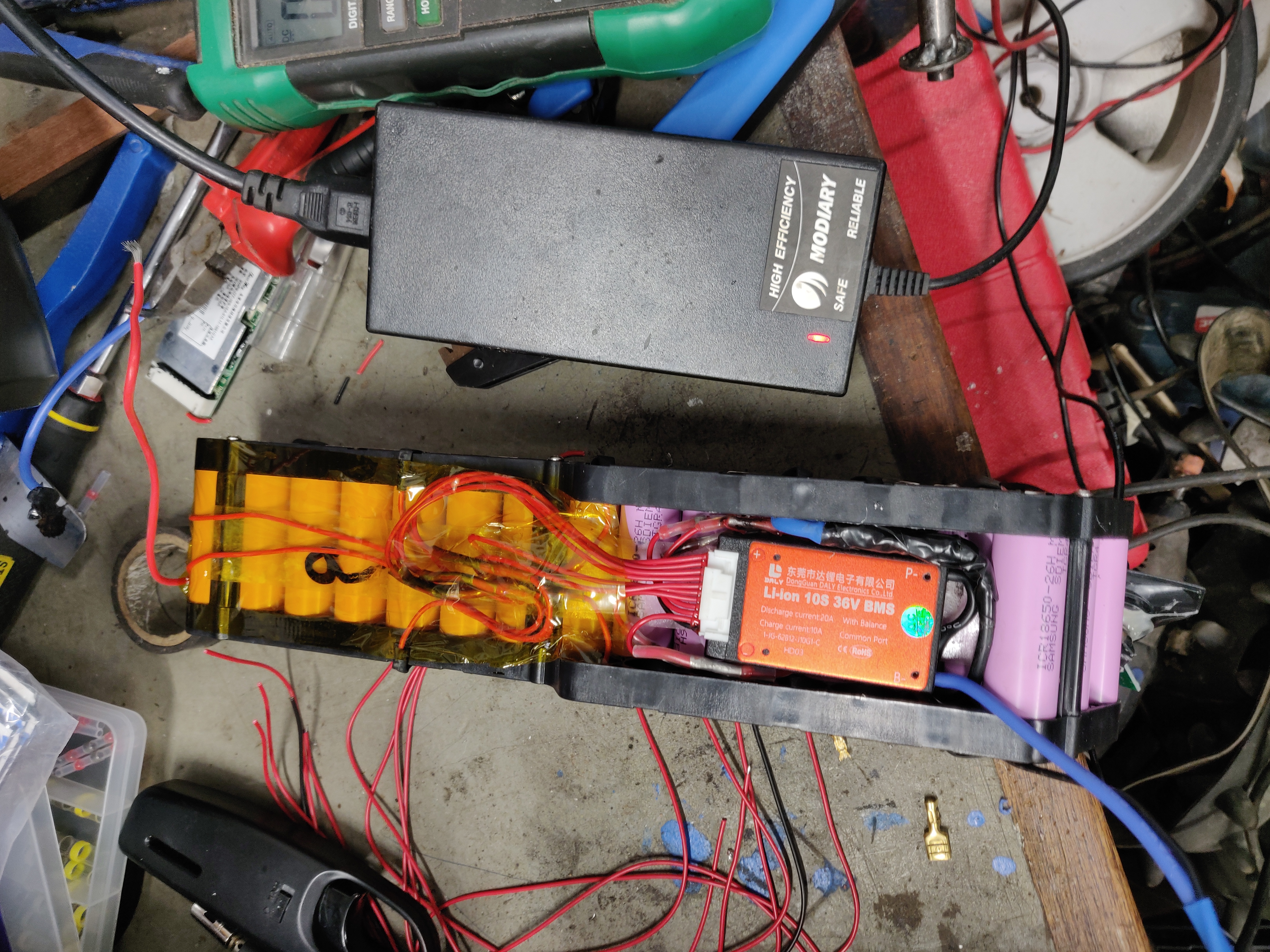

  4. It was the BMS, both input and output, , fully charged to 42.4v , I now know the BMS was stopping me taking charge off of the battery, I e using the motor. The thumb control works as expected and I get movement woop, time for a test ride tomorrow hopefully
  5. Good news, fitted a new Daly BMS and it's charging past its original 41.1 and the BMS no longer restricting the thru put , both +/- of battery and +BMS to - read the same value . Cells up to 4.16 and still charging
  6. Cool, this is exactly what I was after, thanks

  9. So I took the battery apart just now, all cell groups between 4.10 and 4.12 and a total + to - on the cells of 41.1 , there is a definite 0.5 to 0.7 loss coming through the BMS negative cable, I also wonder if the BMS is cutting out too soon given 4.1 seems low across each cell group £14 for a replacement BMS seems like a worthwhile test to see if they'll charge to 4.20 across each bank

  11. The weird thing is even at 40.6 it used to turn the display on at least and now it doesn't do that, like something else is faulty, even plugging in the charger whilst the battery is on the so there's 42.6, and the display doesnt work , I'll try and dig into the battery this week.
  12. Yeah my next step is to open it up and take some cell by cell readings and see if it's an easyish fix, I've got a bench power supply, so I can try to bypass the BMS and charge an individual cell if it's down on charge and see if it recovers as a whole , or maybe I can swap out some 18650 cells if it's not beyond my expertise.
  13. Ah right good to know thx for the quick reply , I'll stick it back on the charger, but sounds like that might be the culprit, might need to get a replacement or see if I can get it fixed

  15. I'm guessing the bafang is still preferred quality over the tongsheng tsdz2? There's only about £60 price difference £265 Vs £330, I'm guessing forum members use both with equal satisfaction?
