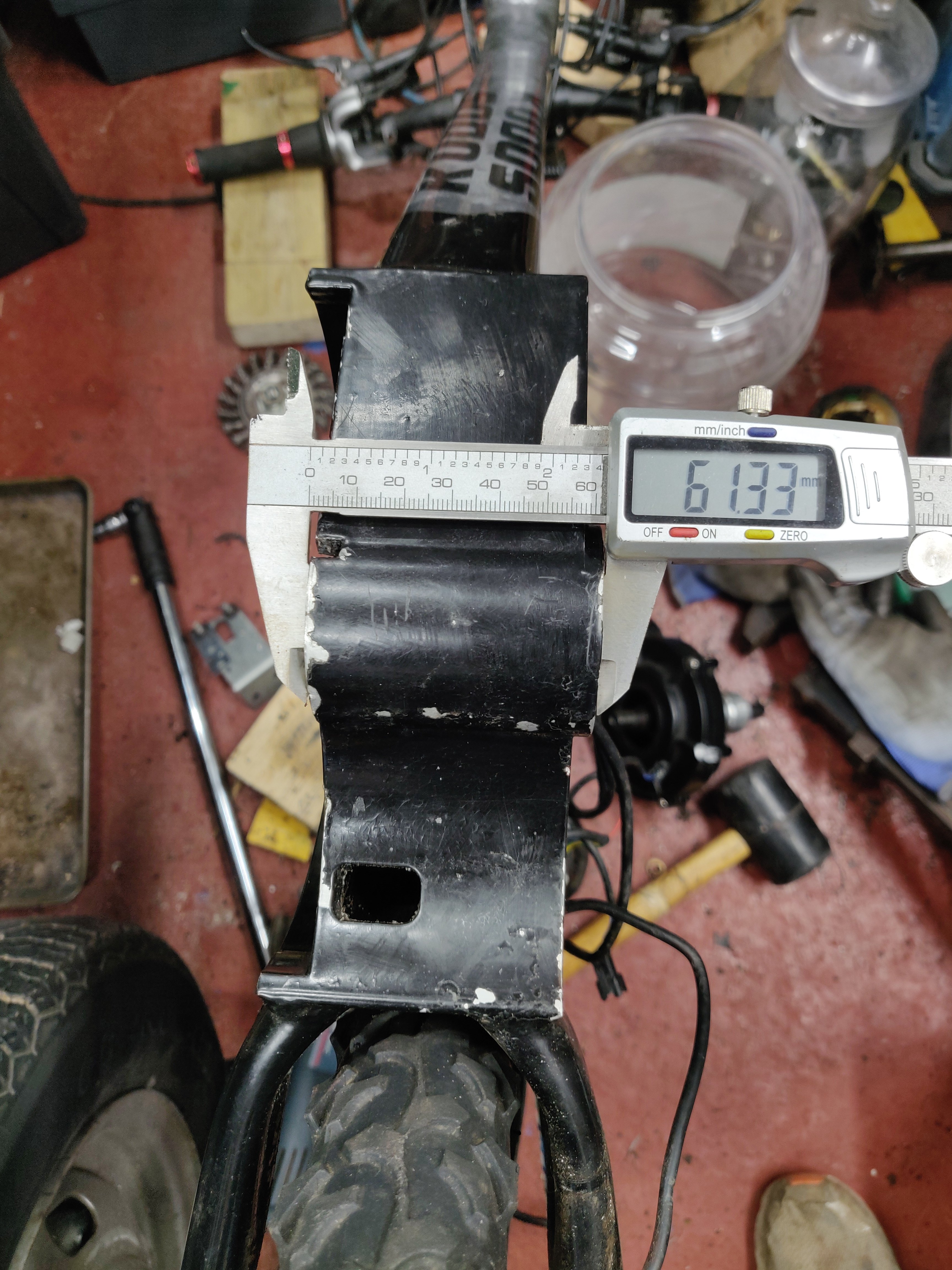

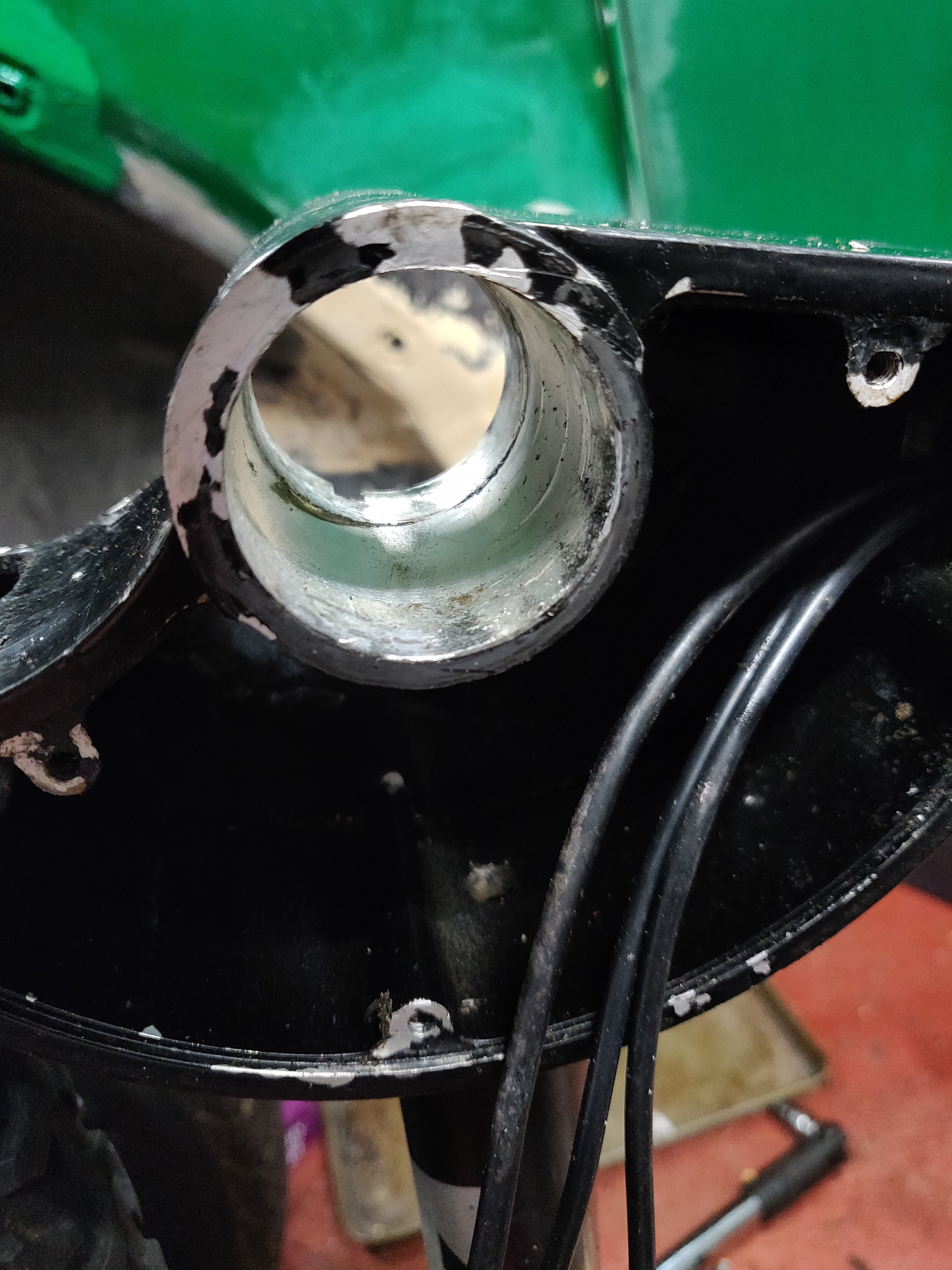

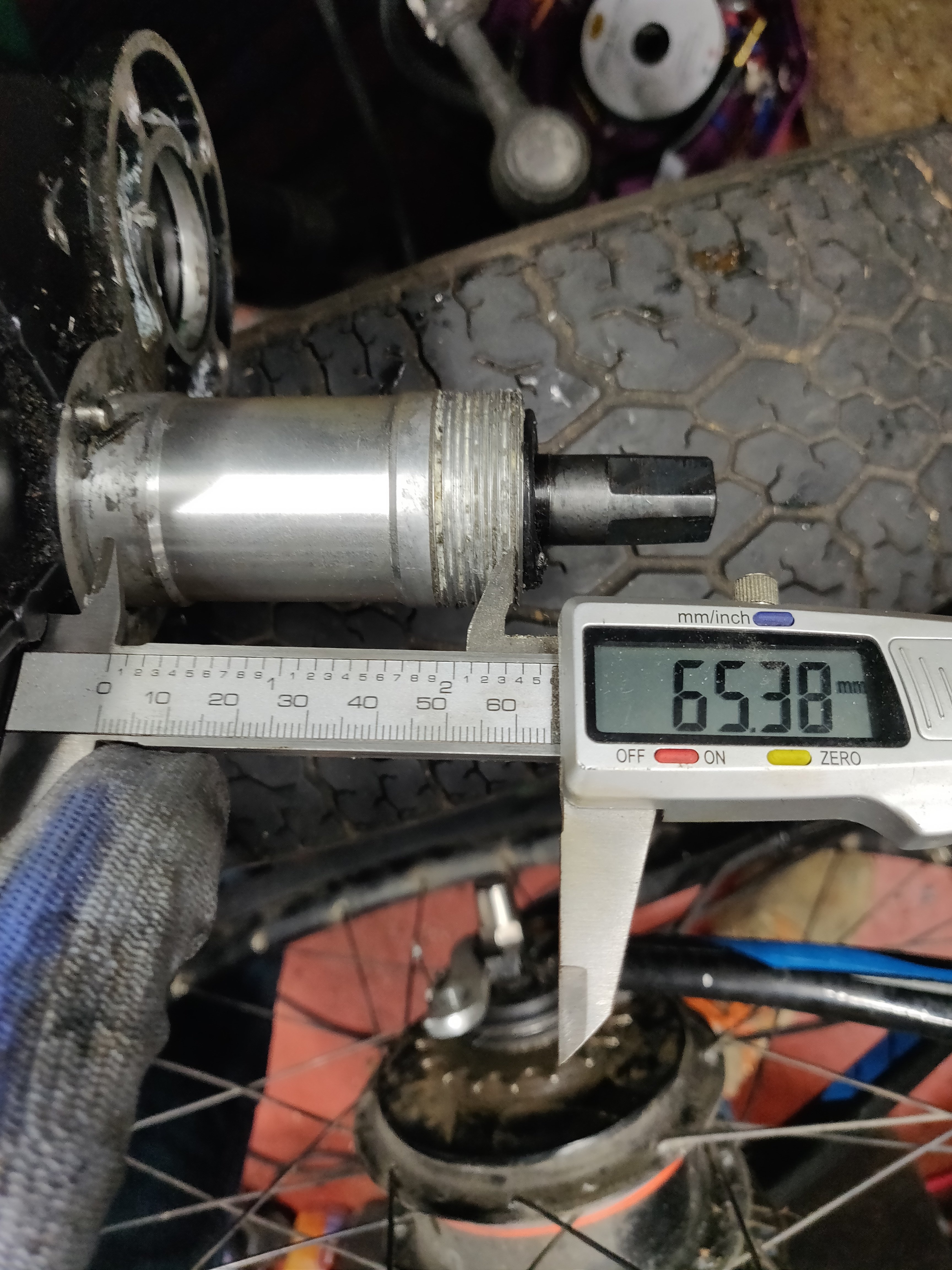

  16. Yeah good shout, I hadn't thought of that, id kind of like to reuse the kudos if I can , but I like the idea
  17. Obviously from the last pic it looks like the old motor was a 68mm with a locking ring but I wondered if newer ones don't include the lock ring distance in the BB measurement of the cartridge?
