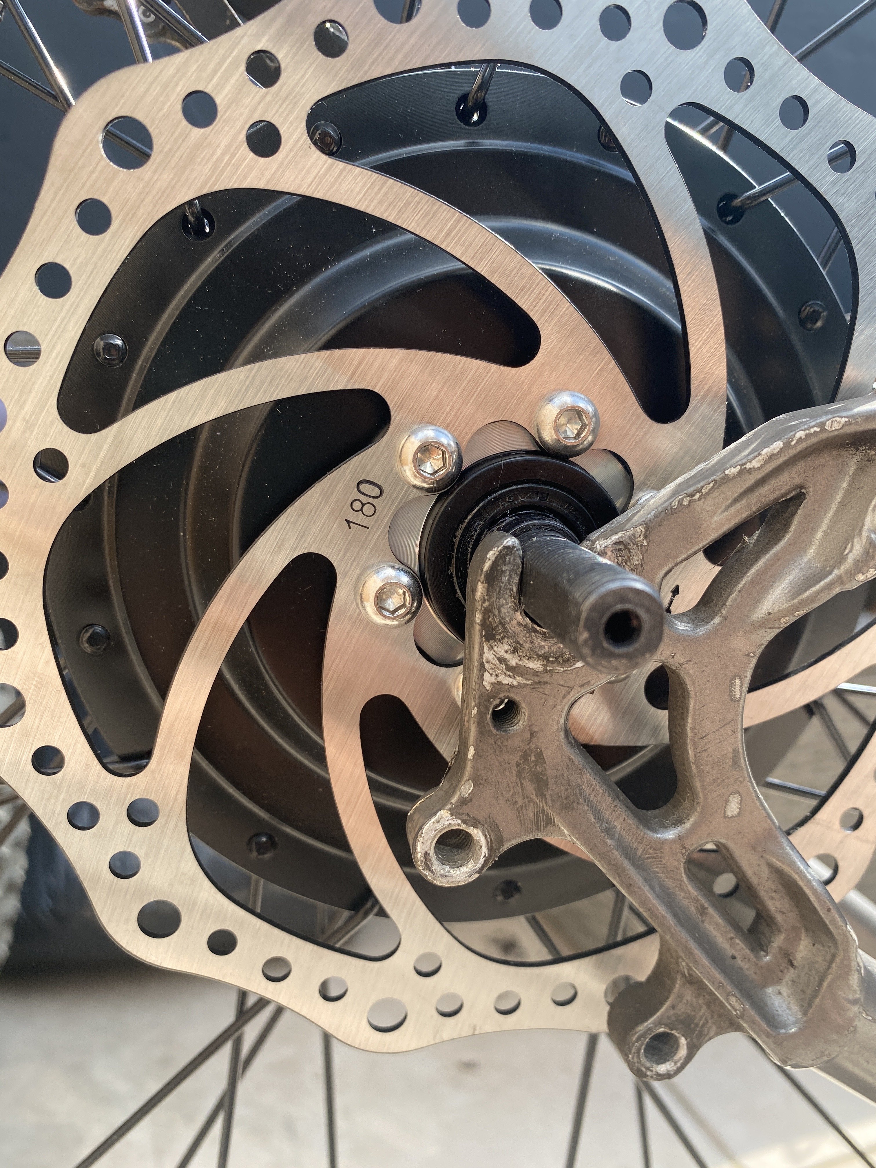

  1. Thanks so essentially it's either file the dropout or add torque arms. Filings sounds doable
  2. Thanks! Added some better picks. The axle drops right in but I've seen people go deeper so the anti rotation lock washer is fully within the dropout, then again I've seen people go a bit shallower too.
  3. Do I need to file before final fitting or can I get away with as-is?

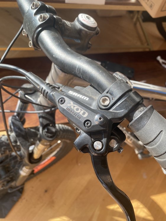

  6. I think I'm going to avoid Aliexpress purely due to shipping times. If I can get a suitable 8 speed cassette I can get started right away. Do I need an 11-28 cassette or 12-32?
  7. Ok so list of random parts - Shifters - Sram X4 8 speed Front Brake - Clarks Lever and Meroca M800 piston Hydraulic Rear Brake - XOD e-bike hydraulic (has cutoff built in if I buy the wire) Front Dérailleur - Shimano Tourney 7/8 speed Rear Dérailleur - SRAM X4

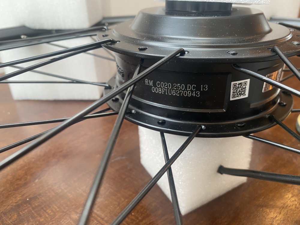

  13. Yeah that LCD8H looks amazing. Shame it wasn't in the kit I bought but maybe I'll get one once everything is up and running
