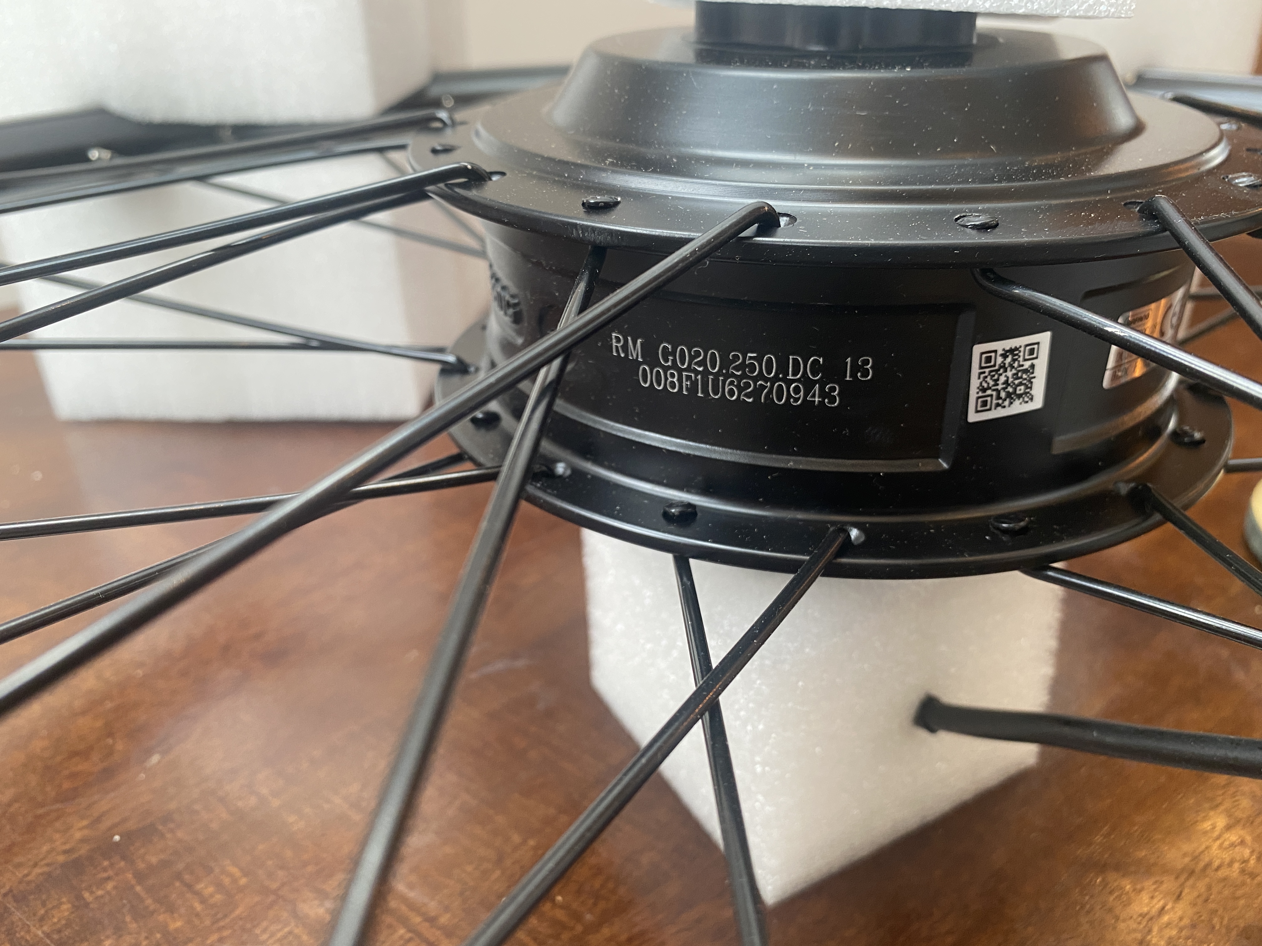

  12. Like a few others on the forum I just picked up this rear hub. Bafang G020.250.DC 13. I'm trying to figure out some basic numbers regarding speed. Purely interested in the numbers. I found an equation on YouTube - RPM x Wheel Size x 0.003 I assume you use the Load RPM and not the No Load number? For this motor that would be 205 (or 245) so in its original guise 205RPM x 27.5" x 0.003 = 16.9mph Then if run at 48V - 16.9 x 48/36 = 22.55mph I'm assuming this number is at the original 15A which seems to be the norm for UK Ebikes. Other ratings give; 17A = 25.4mph = 816W 20A = 30mph = 960W Are these all about right or am I messing something up here? I've just watched a video of someone pulling to 30mph on a 250W 36V motor with 48V battery but only pulling 600W. He doesn't mention The controller Amps but how is that possible? Shouldn't the watts be way higher?

  14. I've got a Bafang G020.250.D/DC 13 pictured below and a 13ah 48V battery. Bike is a Carrera with Hydraulics. I believe the 2nd kit with the hydraulic break sensor is what I need. KT-17A controller. Can anyone confirm this is what I need? Can't find any UK suppliers without buying all the parts separately and hoping for the best! https://www.aliexpress.com/item/1005002001938081.html?spm=a2g0o.store_pc_groupList.8148356.11.34b76bdcODo0sC&pdp_npi=2%40dis%21GBP%21£58.47%21£44.44%21%21%21%21%21%402100bb4916546148856424383e4acf%2112000019332666620%21sh

  17. And it’s here! G020.250.DC 13 Very nice find! Thank god it’s on a rim too
