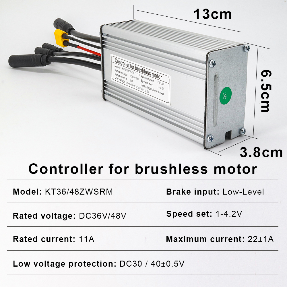

  1. Hi, following on from my previous post I have looked the existing PAS sensor and see no reason for the half turn to get a motor signal so I wonder as I have a KT36/48ZWSRM controller and LCD3 and am having issues with the traditional right side pas sensor only sending a signal after 1/2 turn of the crank. this is a10 magnet one and spaced correctly. I was wondering if a new left side KT 12l would work with this controller? and do you need sizes? thank you Alistair Bristol uk
  2. I am utterly confused by this c4 settings options wording. I am trying the “imitation” torque setting P4 =1 but not sure if that’s the best choice. C4 value P4=0 # 0 zero = startup throttle P4=1 # 0 Non-zero startup throttle WHAT IS ZERO START UP please? setting 3 and 5 in my book has retain printed what does that mean? Depending which online version of the kt3 manual I look at , the C4 parameter choices seem to vary. I live in the U.K. and do not want ,if stopped, trouble , so I’m looking for the best solution to the throttle rules and the fact that to start my trike by pedal power only is a non starter. It takes, even with the C5 setting on = 10 and c14 = 3 , about half a turn with a 10 magnet pas sensor to get the motor running. Ideally I should like to get a quick boost up to the 4 mph throttle only speed, giving me time to start pedalling and if in pas level 5 will get then full throttle with the throttle lever on full if I stop pedalling the throttle revers to the max 4 mph setting. I hope this makes some kind of sense to you i’m sure give the choices between using P4 setting of 1 or 0 and the C 4 option this should achievable or nearly achievable ? thank you for reading this post.

  8. Thanks I have tried hard to only use pas 1 or 2 and reduced the chain wheel by 4 teeth to get a better hill and pull away with pedals, but either of my batteries go flat long before my wife‘s one do , she gets far more range on a identical etrike. we have swopped bikes and batteries around but makes no difference.the only difference is hers still has has the original 11 amp max Lishui controller and mine got changed to kt 18 amp.
  9. Thank you , Nealh, for the reply. So if I know my battery is 48 volt 17 amp hour capacity is there a formula to set the controller to a lower power setting with out sacrificing to much of the uphill grunt that having C5 at 10 gives. if memory serves me right the controller is a 18 or 20 amp max output controller .
