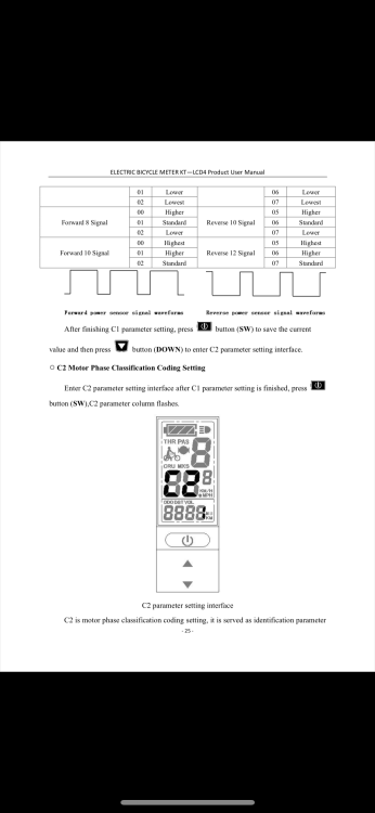

  2. Hi I have been unable to get my new KT controller to operate other than to provide power assist at walking pace mode. I am sure that I have overlooked one of the parameter settings. Here’s the kit 1x kt36 brushless controller 1x ktlcd display 1x 12 magnet PAS sensor (this works on my other lishuj controller) 1x front wheel motor frame my Yoshi e-bike conversion kit See photos attached. I am unable to get any PAS other than walking mode (by holding down arrow on display unit) I have attached photos of part of the controller manual as I was not sure what setting to choose. I have made an assumption that the PAS sensor would work with a KT controller. It does work perfectly with my lishui controller (on the same bicycle). . I wanted to swap the controller so that I could use the lovely ktlcd4 display rather than the large C500 display that came with the lishui conversion kit. I hope someone can advise on the settings. thank you!
