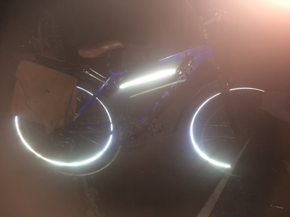

  12. I take that as greatest compliment, especially as I thought it was “arty” of course I looked at it, shows the battery size for az, just clarifying re his “massive” comment, not fishing for praise or somesuch. some people like all the beseenbesafe stuff too
  13. pictures may be deceiving, it’s actually the “small “ triangle , fits most hardtail mtb’s and duallies of 10 years ago Here it is in my Kona hardtail, didn’t mean to be arty but flash shows the be seen be safe reflective stripe, peer past that for battery. illegal,? Not where I am, other posters question the uk rules, I won’t be there till June so not really relevant to me. For others whose local bobby demand 13S battery, same size can be bought so configured. If you meant capacity, I’d have thought that obvious, RANGE, think multi day trip through Wales or Scotland, not commuting or going out for Sunday ride. I’ve taken 2 (13S) x 720watters and only just made last orders, this is more for less weight. Hope that helps AFAIK, all UPP triangle bats are hard case, at least all those I’ve seen in real life and on the net. I prefer soft but take your own choice by all means. This bag is proper tough, picture in first post shows huge velcro strap over crossbar, others smaller but very well attached. of course anyone that rides with loose or broken straps may have a problem, likewise their wheels and brakes etc, we used to have bicycle maintenance lessons at school, I guess those days are gone, blame the manufacturer. Yes, sent from China but not to uk, I may send one there too, it is too high capacity to fly, I’m thinking of flying my dually for some big trips, possibly sell the battery in September (and fly bike home again )
