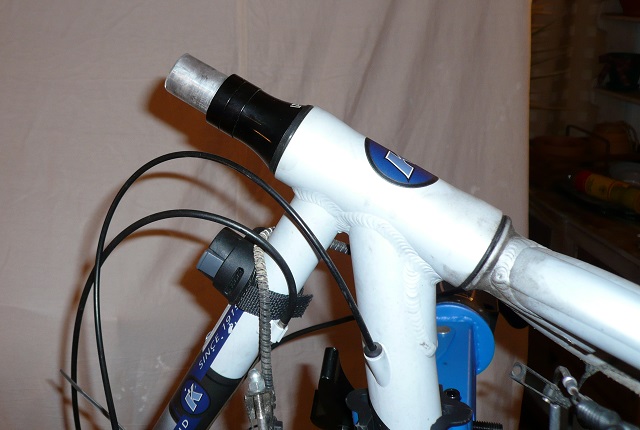

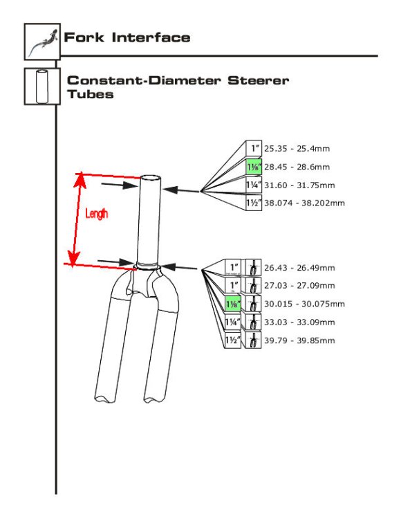

  14. Hi Mike d8veh has covered pretty much all you need, but I am adding a few pics from doing the work on a 2008 ProConnect diamond frame. I am assuming that Mrs O's stepthru uses the same headset. The ProConnect head tube The head tube is for a Semi-Integrated, Zero Stack, Cane Creek style 1 1/8th inch headset The original headset is by VP componets, VP-A41AC The top and bottom bearings (shown at either end of the bottom row) are identical and are the cartridge type with the ball bearings contained within. These are pressed into the head tube. The "crown race" is the ring in the centre of the bottom row (shown upside down). This is a tight fit at the bottom of the steerer tube which rises up from the fork. You can just see the black crown race on the steerer tube in this pic of the grey ProConnect fork. The "crown race" provides a centralising taper that locates into a matching taper in the head tube bearing. If you purchase the original headset bearings, you won't need to replace the crown race as there is no wear taking place. For reference, the crown race is a tight fit on the short section of 30mm diameter at the base of the steerer tube. You will probably be able to get the original headsets from 50cycles. Alternatively on ebay from HongKong but it takes 15 days or so. VP-A41AC. The taper ring shown in the headset pic with the cut in it slides down the steerer tube into the top head bearing, and is pressed down into position when the head bolt is tightened down at the end of assembly. James
