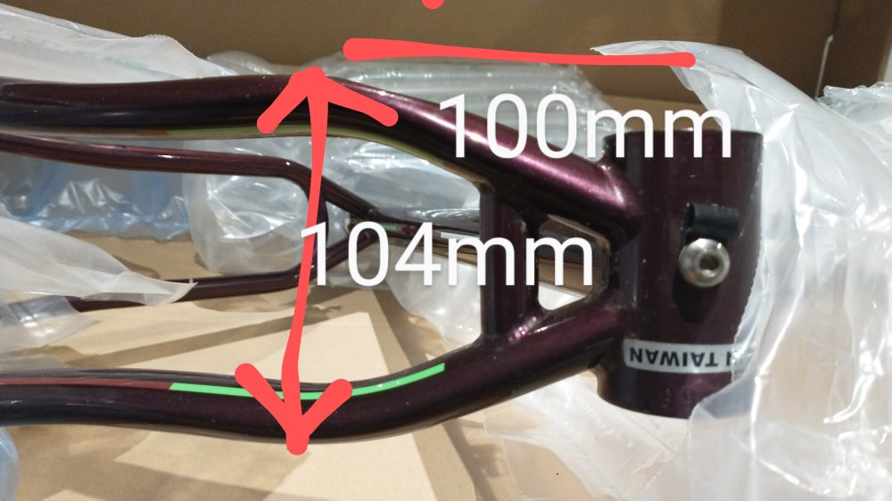

Looking closer at the BBS01B drawings in pretty sure it won't fit, can't find the gearbox diameter for the tsdz8 or tsdz2 but I imagine it's probably similar. My chainstays flare out quite a lot near the BB. So probably looking at a hub motor or no conversion at all.

Now leaning towards the tsdz8 from Woosh, but having trouble working out whether it will fit my frame. Are there any sure fire methods to work out whether fitting will work prior to ordering, or if I'll have a horrible chainline? The bike is 68mm bb. Just over 100mm wide at 100mm out from the BB centre with a small dimple in the drive side stay. I'm most concerned about the gearbox clearance as I can always go smaller on the chainring, though that might involve adapters and such.
