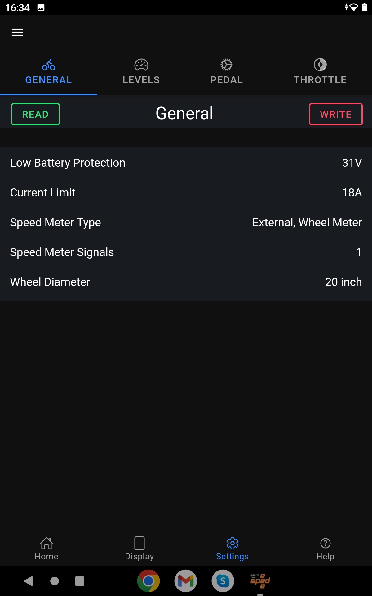

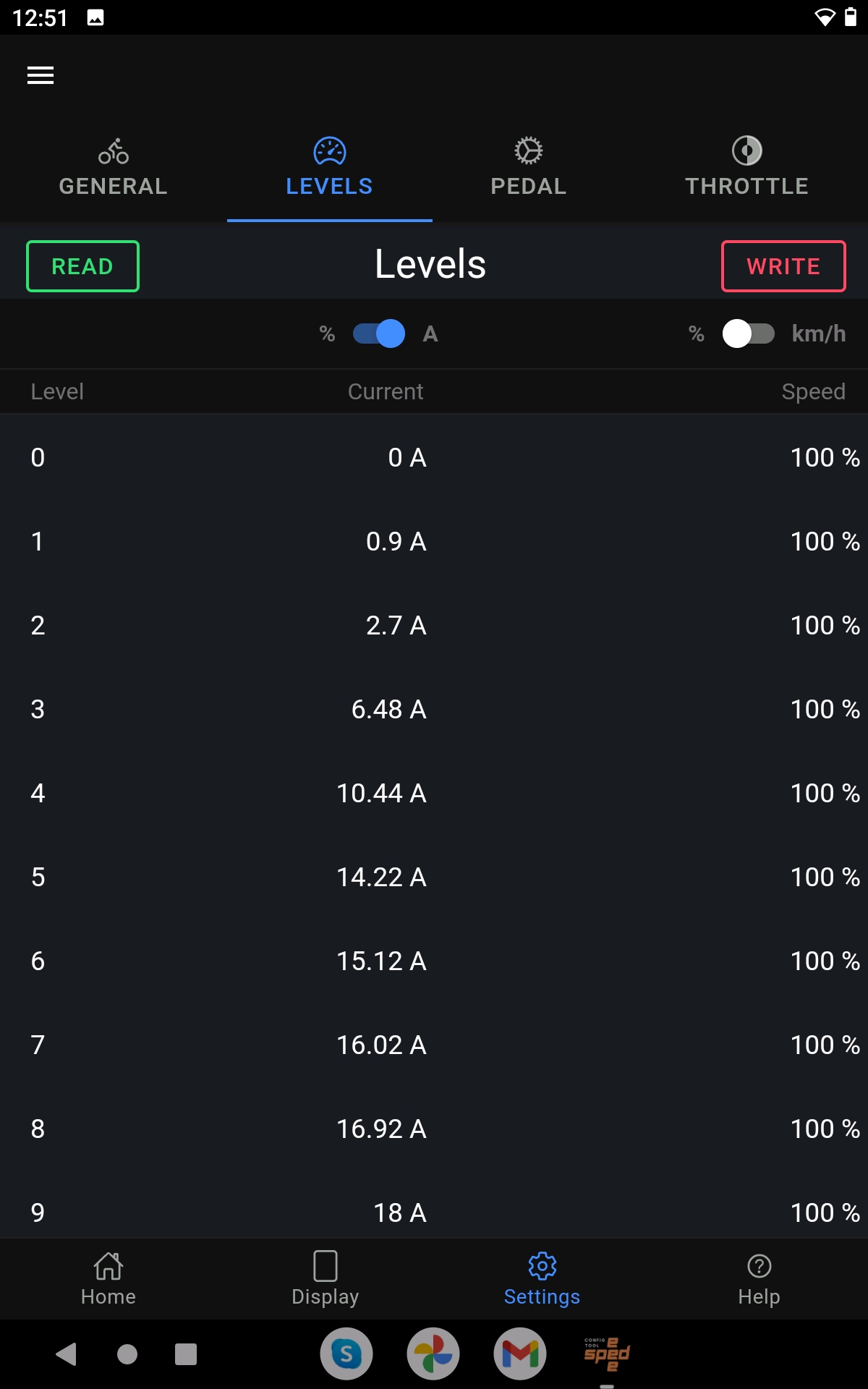

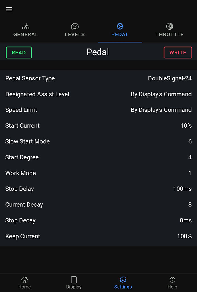

https://edrivenet.com/bafang-programming/
...and take a look at my firmware parameter settings.
I haven't installed a throttle and there's nothing illegal, yet my particular 20" wheeled folding bike conversion is extremely easy to pedal about all over the place. I'm not fat.
If you do buy a 36V BBS01B kit, there are several BBSXXX owners on this forum - I suggest you try your conversion, and post a question should you encounter a niggle.
