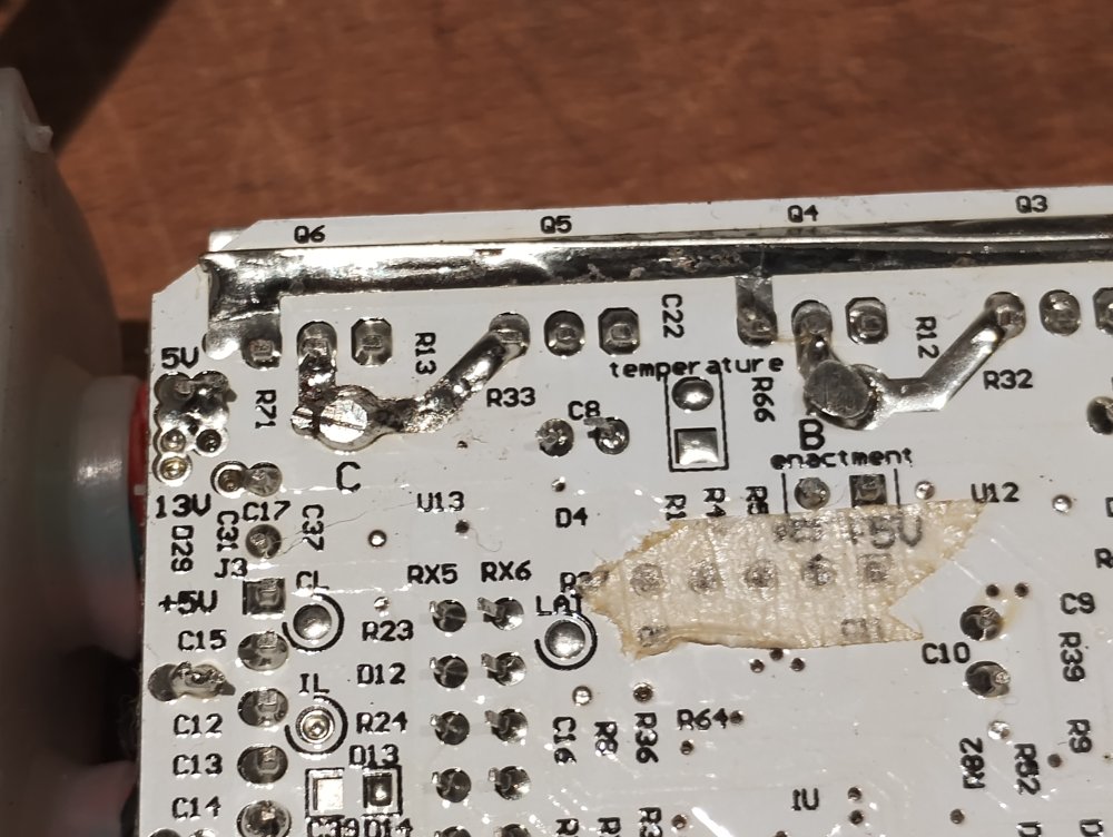

  9. I volunteer at a charity that refurbishes bicycles and recently rescued some bits from a stolen/recovered 20" wheel folder with a view to converting a previously rescued Dahon folder. Unfortunately because a lot of the wiring was inside the frame and had to be drawn out through small holes I wasn't able to record what connected where. Other bits had plugs missing and twisted wire connections. So what I have is a Bafang 8Fun rear wheel with 3 pin connector. Minimalist handlebar controller with On button, 3 assist levels, battery monitor and light switch. Twist throttle, and one brake, motor cutout switch. I will need to get a pedal crank sensor and wheel speed sensor in due course but want to establish that the motor runs before getting in too deep so first thing is to get it to run on the throttle, which has 3 wires, red white and black. I have opened up the control box, a CE G3M20211-1592-16 to trace continuity from the various plugs to points on the PCB. Most of the red wires connect to a point mrke 5v, so presumably the 5 volt supplies apart from one that is connected to the point where the red 36v supply from the battery is connected. All the blacks connect to various grounds. There are two points BK1 and BK2 which I am guessing are the brake motor cutouts. The battery input wires and three motor wires are obvious. This leaves some mystery wires. The red that connects to 36v is paired with a blue that connects to a PCB point marked MS A set of three, Red 5v, Black to ground. Green to HV (or HU?) A set of three, Red 5v, Black to ground.Yellow to VP (or UP?) A pair, Black ground, Green to POR. Does anyone know what MS HV VP and POR stand for? Thanks for reading , If you got this far :-) Tony
