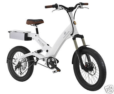

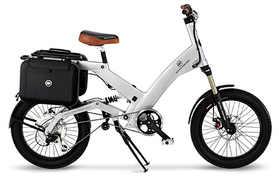

  4. This bike is starting to appear on the US market; Ebay price - $2599 (US). Evidently they've been in business for awhile and currently sold in India with lead acid batteries. I have little knowledge except the following: The A2B is a new light electric vehicle from British startup Ultra Motor specifically geared for urban transport. It is set to go on sale in the U.S. this summer and in Europe later this year. Priced at $2,200 and available through specialty retailers, it runs at speeds up to 32 km per hour (20 mph) and goes up to 70 km (43.5 miles) on a single charge. It comes with a tissue-box-sized removable lithium ion battery that can be charged in a normal electric outlet, just like a mobile phone. Sturdier than a bicycle but lighter than a motorscooter, it weighs just 32 kg (70.5 lbs.). Options include a "dashboard" with a charge indicator and saddlebags to store laptops and other personal effects
