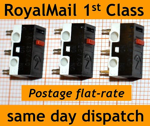

  12. I needed some way of adding switches to the hydraulic disk brakes on my rockhopper 8Fun conversion to cut the motor. The kit was supplied with brake levers with a cable and built in switch for cable operated brakes, which plugs into the controller, no use for hydraulic brakes. I went onto Ebay and bought a pack of 3 mini micro switches for 99p + 70p p&p. [ATTACH]5237.vB[/ATTACH] I cut the cable from the supplied brake lever and soldered the wires to the microswitch normally closed contact (open when the switch is pressed). I then wedged the switch into the brake lever (see pics) so that the switch button was pressed. When the brake lever is operated the button is released. I had to file a small amount of plastic off the switch to make it fit. The switch is now a really tight fit, plugged the cable into the controller and it works fine. I think the switch would stay wedged in place on its own but I added a couple of drops of epoxy just to make sure it wouldn't move. [ATTACH]5238.vB[/ATTACH] [ATTACH]5239.vB[/ATTACH] [ATTACH]5240.vB[/ATTACH] The photos show the lever in the normal position and then pulled, releasing the button. [ATTACH]5241.vB[/ATTACH] I just needed to bend the soldered pins to refit the handebar grip and then tidy the cable. It looks neater in reality than it does in the close up pics and you don't even notice it's there. I have no idea how reliable or durable these switches are or how many operations they can do but after testing and a ride yesterday they have had at least 30 ops and are still working, only time will tell. Not water proof but they could be coated with tape, silicon sealant or epoxy.
