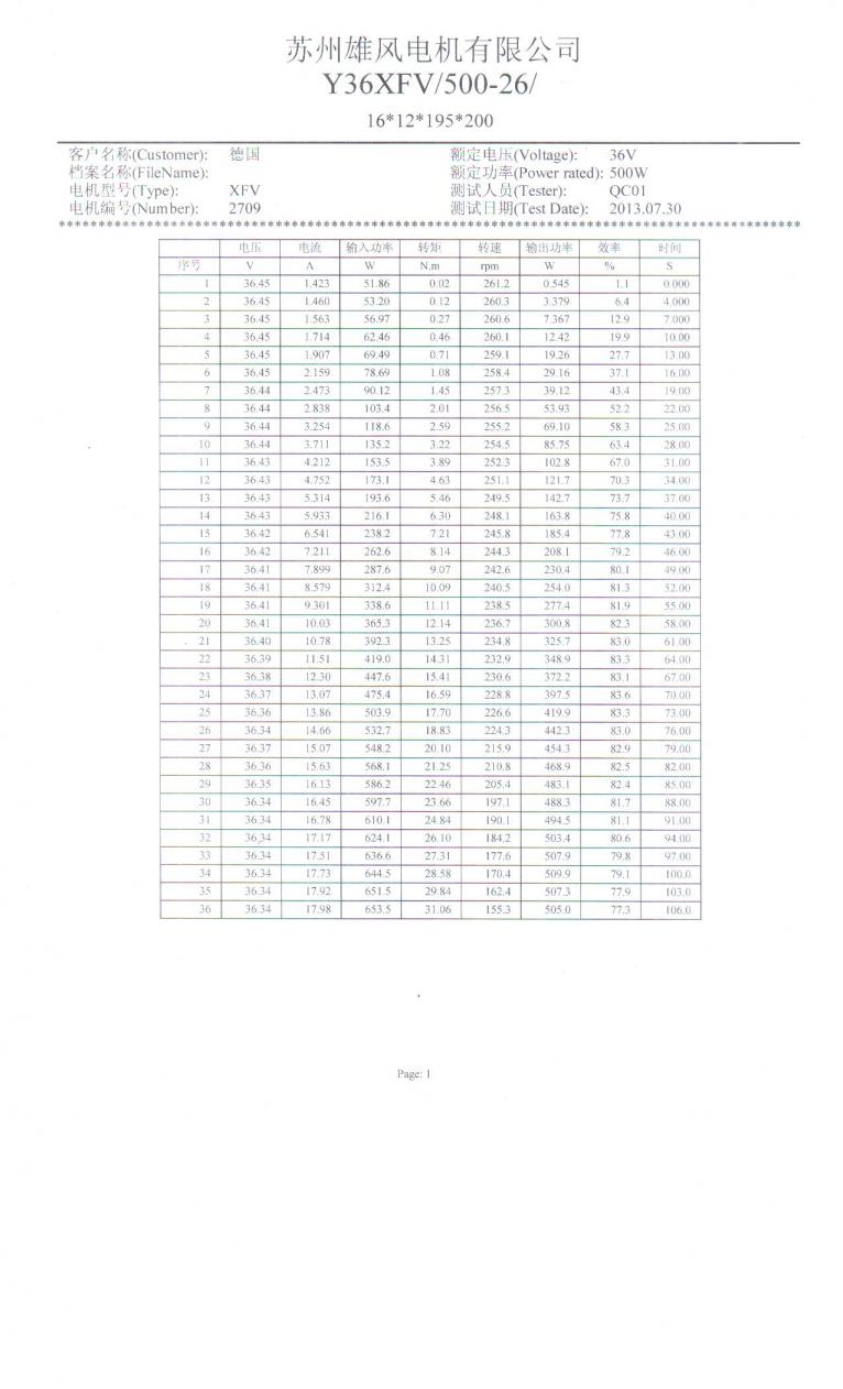

  17. Latest e-mail from Colin Sheng: "Dear Magnus, For sure, 260rpm is based on 36V 26 inches. I promise for 260RPM at 36V.. Please kindly see the attachment for the curve which will give you more clear about RPM." [ATTACH]6765.vB[/ATTACH][ATTACH]6766.vB[/ATTACH]

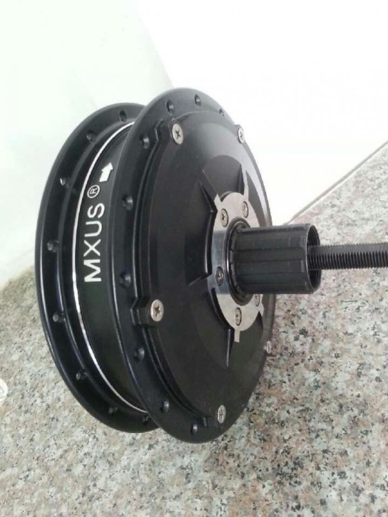

  22. This project will probably be slow in progress. Some info from e-mail that I have received so far. Xofo: "Re this 350W -500W geared motor with cassette, its price is 130 USD . I would like propose you buy 2 pcs , which can save the shipping cost. The shipping cost for 2 pcs is 130 USD ( if you buy 1 pcs, the shipping cost is 100 USD )" MXUS MX01A: "Actually MX01 can reach faster speed, but so far we just manufactured the first batch. And the speed is fixed, only can reach 30km/h for 700c rim (36V)." other mail: "With reference to your email, The speed is around 28km/h on 36v (26"). The price for the only motor:150$ shipping cost for 5 sets: The price for the kit :210$(With the LCD display), the kit including the motor in wheel, controller, throttle, brake, PAS,LCD display. The delivery cost is about 600$(5 sets 26' kit)." "We have the sine wave controller for 36-48v controller for the motor, but the price is little expensive, 10 $ more than normal. In the kit, there are motor in wheel, controller, throttle, e-brake, PAS, LCD screen." The mx01a might be a little slower than I want, 35-40 km/h at 48V. [ATTACH]6745.vB[/ATTACH] [ATTACH]6741.vB[/ATTACH][ATTACH]6742.vB[/ATTACH][ATTACH]6743.vB[/ATTACH]
