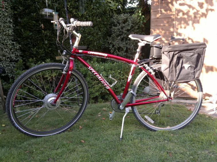

  5. [ATTACH]6740.vB[/ATTACH][ATTACH]6739.vB[/ATTACH][ATTACH]6738.vB[/ATTACH]Well I've taken the plunge and have fitted a cyclotricity kit. Did not want a whole new bike when I've got a good bike allready. Went for the pedal assist with LCD and pannier battery. Had a few problems fitting I.e had to make the forks wider file the drop outs deeper busted the bottom braket lock washer only plastic so had to get a whole new bottom bracket so what I thought would take a weekend has taken 3 weekends and a lot of back and fourth to the bike shop. With the LCD pedal assist you can ajust what speed the motor cuts out at I.e factory preset is 15 MPH I've managed to do it so it doesn't cut out until 19mph won't go any higher though but pritty good though.the pannier battery is good as you can hide it under a pannier bag done 25miles and the battery is reading half full.
  6. cyclotricity kit Well I went with the cyclotricity with pannier battery and lcd pedal assist just tried it out and it goes like a rocket got 19 MPH on the flat and nice fast acceleration. Had a few problems with fitting, the fork drop outs had to be made deeper and forks wider. Broke the plastic locking washer on the bottom braket when fiting the pedal assist so had to get a whole new bottom braket. The good thing with the pannier battery is you can hide it with a pannier bag and fit a padlock to the battery handle and the rack to stop it getting Niked. The motor is noisier than I thought it would be but hopefuly once it wears in it will be better. But as a whole I'm glad that ive gone the kit route.
