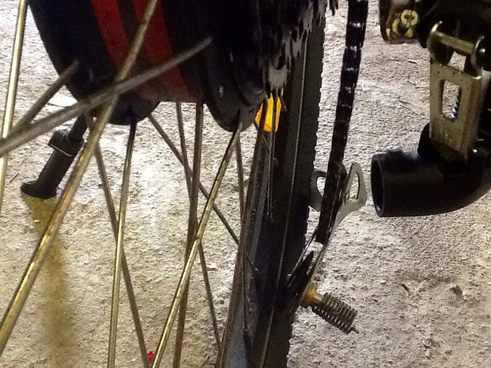

  4. Had a look at the wheel and it seems to be spinning freely. Maybe slightly off. The mech hanger is definitely bent. Thanks for that pointer Rob. The only other thing my OH forgot to mention is that the rear mudguard practically bent over double when this happened and the stay cord is bent. He adjusted that mudguard very slightly last week as there was a scraping/rattling noise and the adjustment seemed to solve it. No idea if that had anything to do with it. Can't say enough good things about Oxygen after service (I'm out of warranty). They're sending the replacement parts free (P&P only) and it turns out our local bike shop is more than happy to fit it for £20. They actually sell a few ebikes so might see if they can give it a full service. It's coming up to three years old. Appreciate the help & fingers crossed the bike can be easily fixed...

  6. Thank you Rob. You are a star. That info is so helpful, including the approximate cost of a bike shop repair (if we can find one that will touch an ebike!). It confirms what my husband thought had happened. He just isn't sure how the cage attaches to the rest of the derailer. The cage has a prong/arm & combined with the spring it looks like this just sort of 'slots' into the other part. But you're right - we need to find a bike shop to do this. And a full new part.

  8. Hi guys, Excuse the non technical description. I'll try to add a photo to show what's happened... My OH was just out on the Diva taking it for a spin when he heard a clattering noise. Seems like part of the rear derailleur (think it's a shimano acera) came loose and is just hanging down dragging on the ground. The plate holding the two pulleys has come away from the rest of the mechanism and is now bent out of use. He found the spring that goes from the plate into the other part somewhere up the road. Can I assume that I need to replace the whole derailleur mechanism or just the plate? Does anyone have any idea how the plate fixes to the other part - is it likely to have snapped or is it a screw in? Any idea if this a standard bike repair or is it specific to an ebike?
