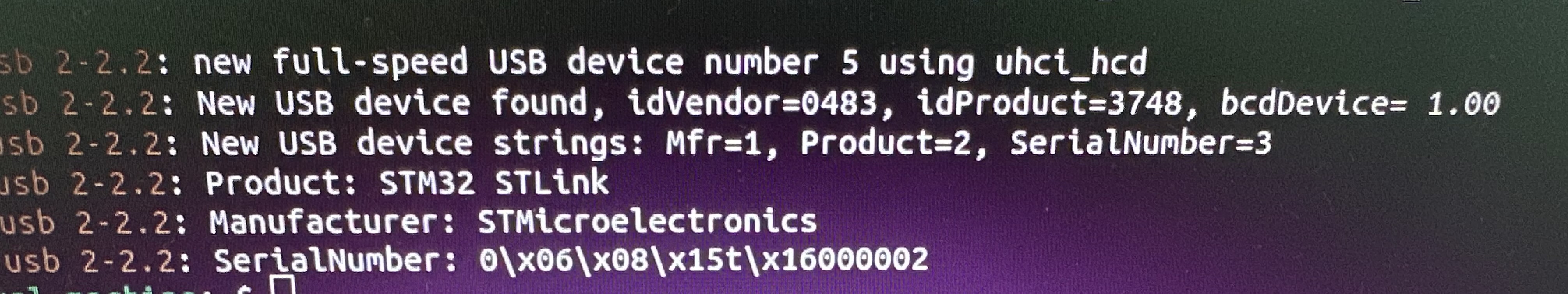

  10. Issue resolved. The STlink dongle needed a firmware update. Once updated it now connects ok and I've flashed the motor.
  11. yes it shows 5v and Java is fully installed and working
  12. I don’t have the bike here atm but I get the following output when the stlink is connected on Linux. The other Stlink I have outputs the same values but the serial number is just showing ‘Y’
  13. I've tried both Linux and Windows 10 on 2 different PCs desktop and laptop. Java is working all ok. Assume it's a hardware issue or incompatibility with the motor.
  14. Tbh I'm a bit reluctant to spend any more money on clones as 2 different ones from different sellers haven't worked. I could buy a genuine one e.g. from CPC farnell but there is no guarantee this will work either. https://cpc.farnell.com/stmicroelectronics/st-link-v2/programmer-icd-for-stm8-stm32/dp/SC12550?ost=stlink
