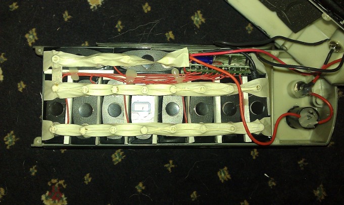

  4. Each individual block is 28mm x 70mm The whole area for the full pack to fit is 100mm wide x 243mm long and 70 mm deep although the depth could be increased as there is a dense foam protection on the outer case for the pack about 23mm deep. I did try to remove the pack but it is fixed solid in place, i assume it is glued so i did not want to try and force it. Electrics are definitely not my strong point so this looks like it would be beyond my capabilities if there is any complicated wiring procedure.
  5. Hi and thank you. I will have a look when i finish work tomorrow morning.
  6. Thanks Rog. A bit of a dilemma, yes the bike is still not in too bad a condition so maybe a replacement battery may be the best option. Then again i could get a new Cyclamatic for not much more, the people who have this bike seem quite happy with their bike for the money. Maybe just flip a coin to decide lol.
  7. Hi, i have a Wisper works 905e bought in 2007 with the 36v 10ah lion battery. Due to illness i have been unable to ride the bike for the past couple of years and with one thing and another the battery was not charged during this time. I did not expect it to work but tried charging it anyway, went back to work for a few hours and when i came back the light had gone green, but as expected the battery would not power the bike. I have tried putting some power briefly to the bike, it powered up and the motor turns fine. The fuse on the battery is also ok so i would assume that the battery is shot. Reconnecting the charger and the light goes green immediately. Is there a cheaper alternative than buying a replacement from Wisper as with the price of a replacement for a 4 year old bike it would probably be as well to buy a new bike. Thanks.
