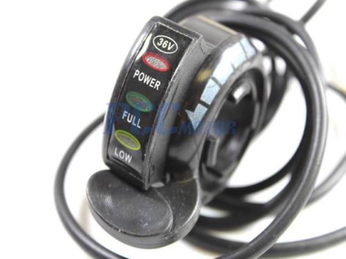

  18. Ok all back together, No flailing wires, Bike seems to work fine but only the Power on (RED) led works and not the others. No idea why. I can live with it as I know the power of my battery and it has an indicator on it but I'm just curious why it wouldn't light up ?
  19. Cheers d8veh. In the inspection process the red has detached too, So I'm popping it back where it should be. Any ideas where I can get a replacement throttle? I think i'd like to have a spare to hand. This site is fab. Thankyou
  20. OK second attempt. Thanks so far d8veh. Red and black soldered to the same pad & intact. Blue wire was the one floating around. Numbered all the pads for clarity.
  21. Hi, Recently got some help on here with relocating the spring in my throttle & now I need some wiring info.The Blue Wire has become disconnected and the 3 leds do no light up anymore. I can live with them not working but don't really want that wire flapping around. I can't see where the wire has come from. Any ideas ? Thanks in advance.
  22. Just logged in to thank you & the instructions are there! Once you said it could be dismantled i tried again & and it fell apart in my hands. I was certainly less tentative knowing it could be dismantled. Thanks for the help. Will be on again soon for tips & tweaks for a 36v 8funSWXK motor twinned with an ecrazyman controller. Thanks again.
  23. I was going to but it seems very delicate & thought if I screwed it up I'd be stranded. Will take a closer look later.
  24. Currently using a butchered / modified (depends on how you look at it ) Momentum Upstart. It has a thumb throttle but the spring is slack so I want to replace it. I've attached a picture. I need to know where the best place to source one is? Happy to order from china if necessary. Thanks in advance.
