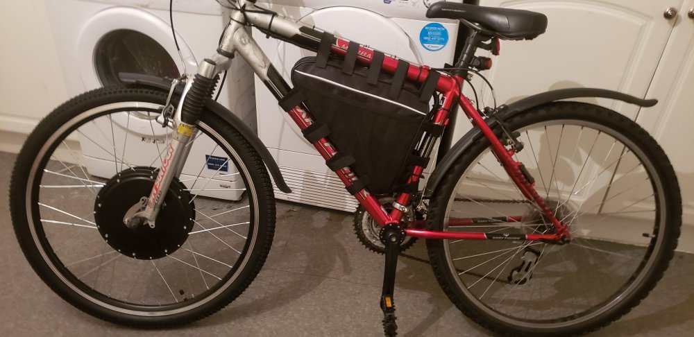

  8. I tried pedaling backwards.. no difference..
  9. Its riding on a flat surface.. and yes im a bit tubby.. Also what im not sure about is why with wire attached or not attached istill get the same mph. I have both pedal sensor and thumb throttle attached.. but when i pedal i get no help from the motor,only thumb throttle seems to work.
  10. Hi, i bought a voilimart front wheel 500w conversion via ebay. It seems to work fine. With a 36v 15ah battery. But i have had the two blue wires arrached thinking thats the restriction, it went about 17mph. But when i unplug this wire.. no difference in speed, the same 17mph. Any ideas, Or is that it speed wise?
  11. Hi.. well after doing the dabbling in this forum a while ago and forgetting about it, i decided to turn my old Gary Fisher Mamba in to an Ebike. I bought a voilamart 500 front wheel conversion. It took me most of the day on and off as i also changed the front v brakes, cables, gear shifters. At the minute it seems legal, doing 16mph. But im going to try pulling wires for full power. Its all worked via the thumb throttle The pedal sensors are attached but for some reason are not doing anything when i peddle.im guessing the magnet is not close enough. I will look into this. Im using a 36v 15ah battery I also added two torque arms for safety.
