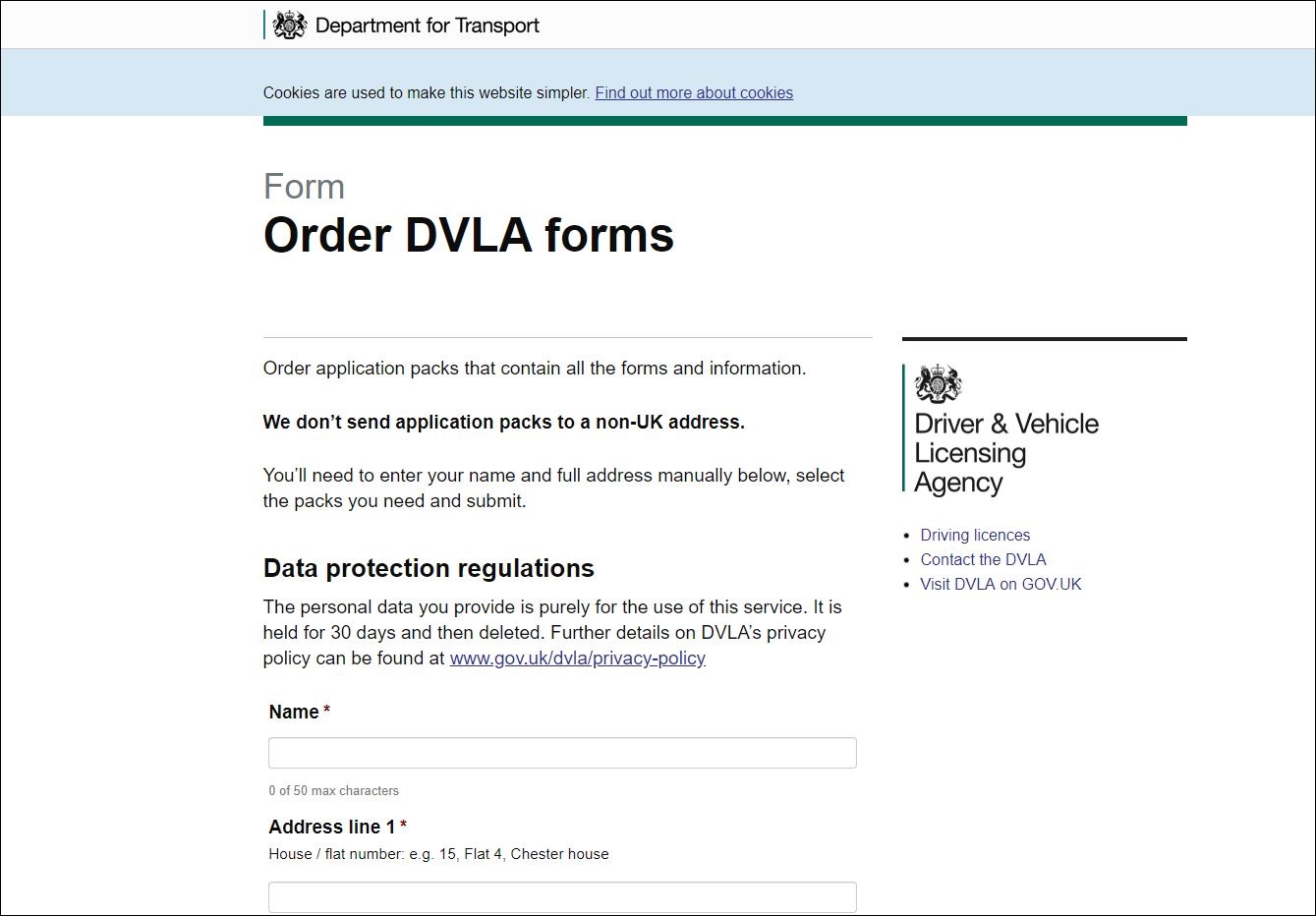

Where to obtain the form
The V55/4 can be ordered directly from the DLVA website (https://forms.dft.gov.uk/order-dvla-forms/). The website will ask for an address to send the form(s) to. When we requested ours, they arrived within a few days.
