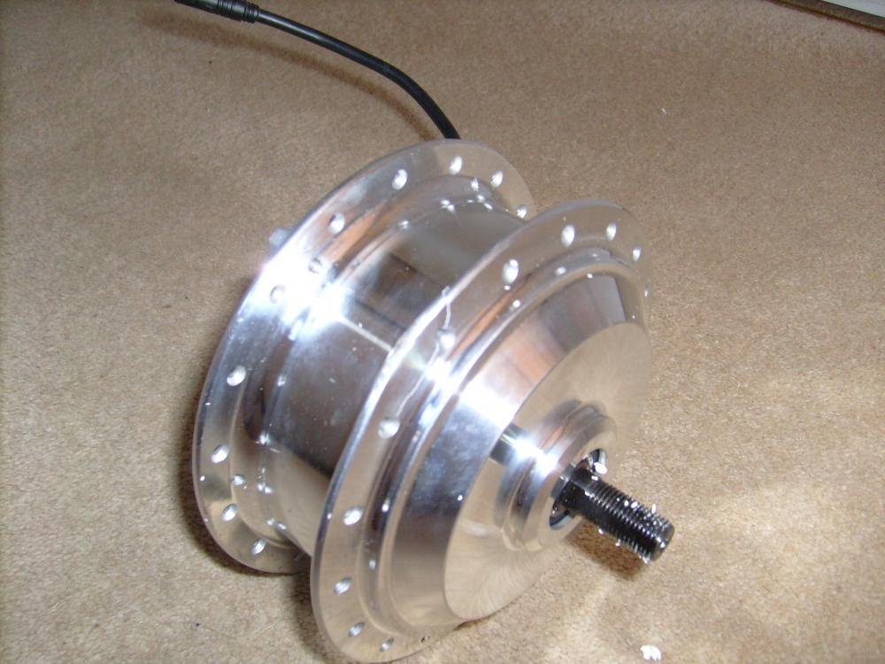

Good news / Bad news
The motor from China arrived today via Fedex, unfortunately it has been damaged in transit.
The motor has been dropped and the casing around the spoke holes is cracked.
It must have been dropped when being inspected as there are signs that the parcel had been opened and then resealed.
Jane is in the process of sending a replacement shell, this time via DHL. She has been very helpful and understanding.
So the review will be delayed but I can get on with the fitting and maybe run it up at the weekend.

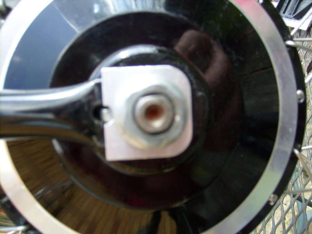

Managed to fit the motor into the forks today - all good news- plenty of clearance on both sides of the forks using only the spacers provided.
The bonus is the cable exit is on the right side of the bike so no folding problems.
The speed readout under no load was 16.8mph on my bike computer.
[ATTACH]4220.vB[/ATTACH]
[ATTACH]4221.vB[/ATTACH]
[ATTACH]4222.vB[/ATTACH]
What are those retaining washers/brackets that seems to cover the front of the dropouts ?
Can we have a side on view please ?
Jerry
They were designed and supplied by The Electric Transport Shop TETS in Cambridge. They are CNCed out of aluminium recessed to the shape of the fork ends with a slot milled in to fit tight on the flat of the motor spindle. When installed they stop the fork ends from spreading under load, effectively a torque washer.
Call Matt Widgery he might be able to supply them if you need some.
