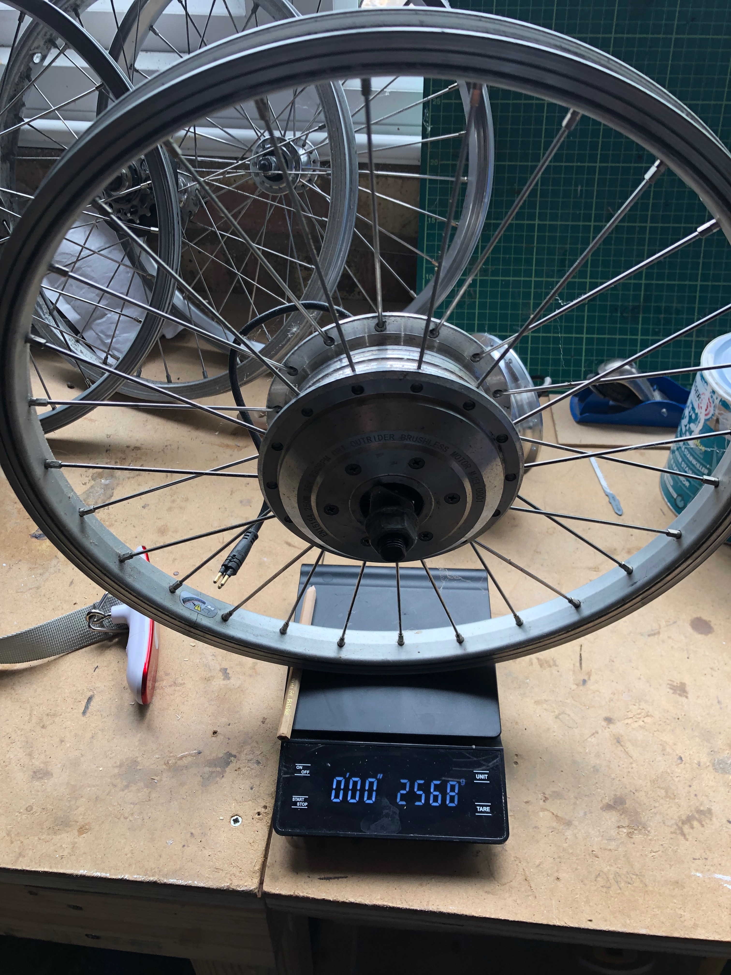

  1. This is my wheel. On the TopBikeKit website it says their motor is 1.6kg which is impressive. Are they quiet ?
