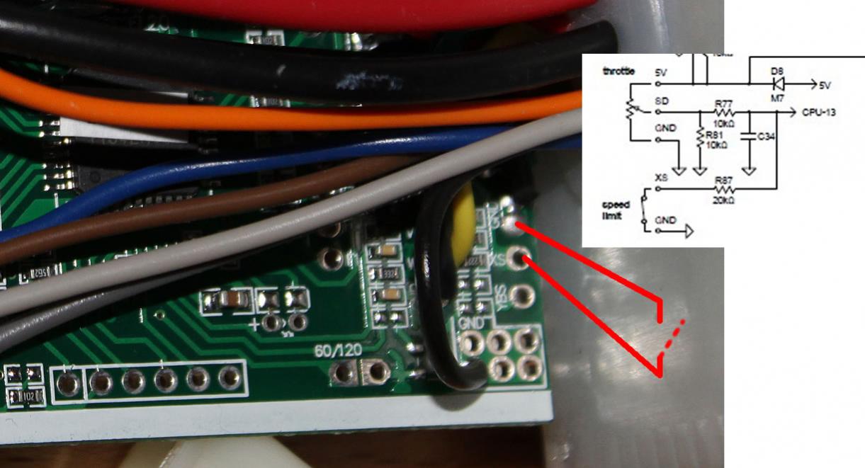

I have the X8M06-c chip in my controller, running a 1000w 48v motor at 36v (which is running nicely, thanks to the help I had from here). Is there a "restricter" pin on there that I could enable, or is that a feature not available on that chip ?
Have alook round the circuit board for a pad marked "XS".
Thanks again,
I've found the XS on the board, it's a vacant solder point. I'll try a switch between that and the adjacent earth point. Am I right in thinking that the 20k ohm resistor on cpu pin 13 then limits the pos voltage and therefore power to the motor ? I can't see how it would be able to regulate at 15 mph, would it just limit the output power ?
If so, what do you think about the idea of just linking xs to ground and replacing R87 with a variable resistor ?
[ATTACH]4523.vB[/ATTACH]
Should be fine, providing a stand off resistor is added in series to prevent taking the rest of that part of the circuit down to 0 if the pot is fully turned
Sent from my iPhone using Tapatalk
To operate the speed limit, you connect XS to ground through a switch or jumper.
The throttle controls the speed, not the power, so the resistor just reduces the throttle voltage that the CPU sees.
20k will limit it to 12 or 15mph. If you want higher speed, you'll need a higher resistor. If you go down from 20k, your speed will go down too. You might want to put a fixed resistor in series with a variable one, with you minimum speed set by the fixed one.
The switch sounds fine then, nice and simple, just to be able to keep it down to 15mph when necessary.
