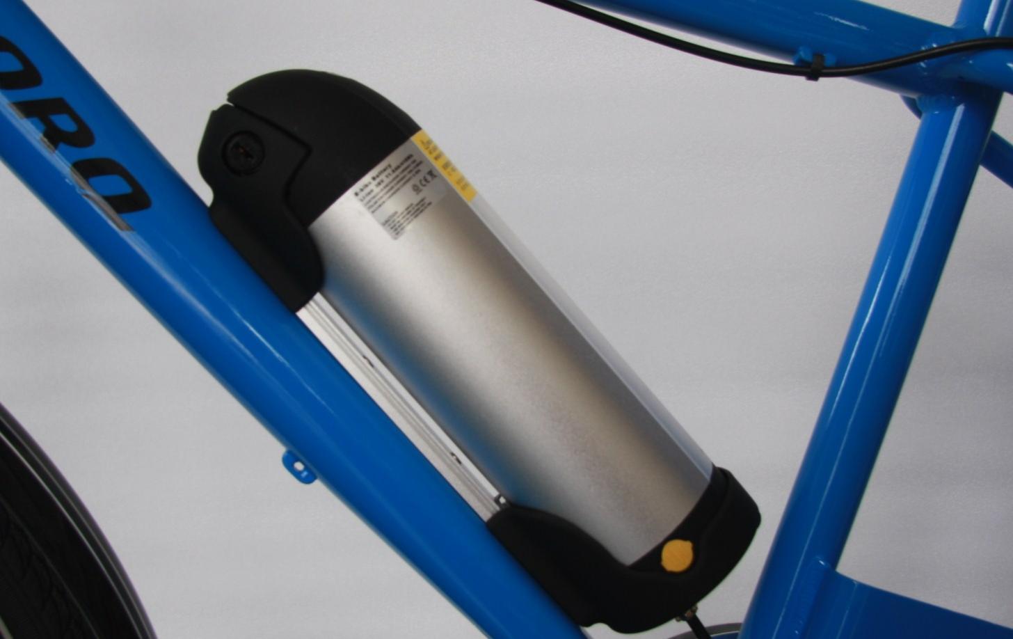

February 10, 201313 yr In addition the the eZee rear mounting FP (flat pack) and the VP (vertical pack) batteries we also have a 37v 11.6Ah LiPo BT (down tube mounting battery) as shown below, which can be fitted in addition to either the FP or VP batteries or supplied with an eZee conversion kit. In theory, it would be possible to have 3 eZee batteries, 20Ah VP, 14Ah FP and 11.6Ah BT mounted on an eZee bike and wired in parallel giving a total of 45Ah. The obvious downside is it would be heavy, but capable of a long range. [ATTACH]5084.vB[/ATTACH]

February 10, 201313 yr In addition the the eZee rear mounting FP (flat pack) and the VP (vertical pack) batteries we also have a 37v 11.6Ah LiPo BT (down tube mounting battery) as shown below, which can be fitted in addition to either the FP or VP batteries or supplied with an eZee conversion kit. In theory, it would be possible to have 3 eZee batteries, 20Ah VP, 14Ah FP and 11.6Ah BT mounted on an eZee bike and wired in parallel giving a total of 45Ah. The obvious downside is it would be heavy, but capable of a long range. [ATTACH=CONFIG]5084[/ATTACH] What is the life span of these bottle battery's, 1-2 years or longer.? and the cost please. Thanks

February 10, 201313 yr What is the life span of these bottle battery's, 1-2 years or longer.? and the cost please. Thanks Hi Jebb, The bottle batteries supplied by eZee come with a 2 year warranty and the cost is £475 including charger and delivery within the UK. The cases my may look like cheap generic type, but the cells and BMS are not. A newer version is now available with a different case as shown below. [ATTACH]5087.vB[/ATTACH]

February 10, 201313 yr Hi Jebb, The bottle batteries supplied by eZee come with a 2 year warranty and the cost is £475 including charger and delivery within the UK. The cases my may look like cheap generic type, but the cells and BMS are not. A newer version is now available with a different case as shown below. Thank you.
