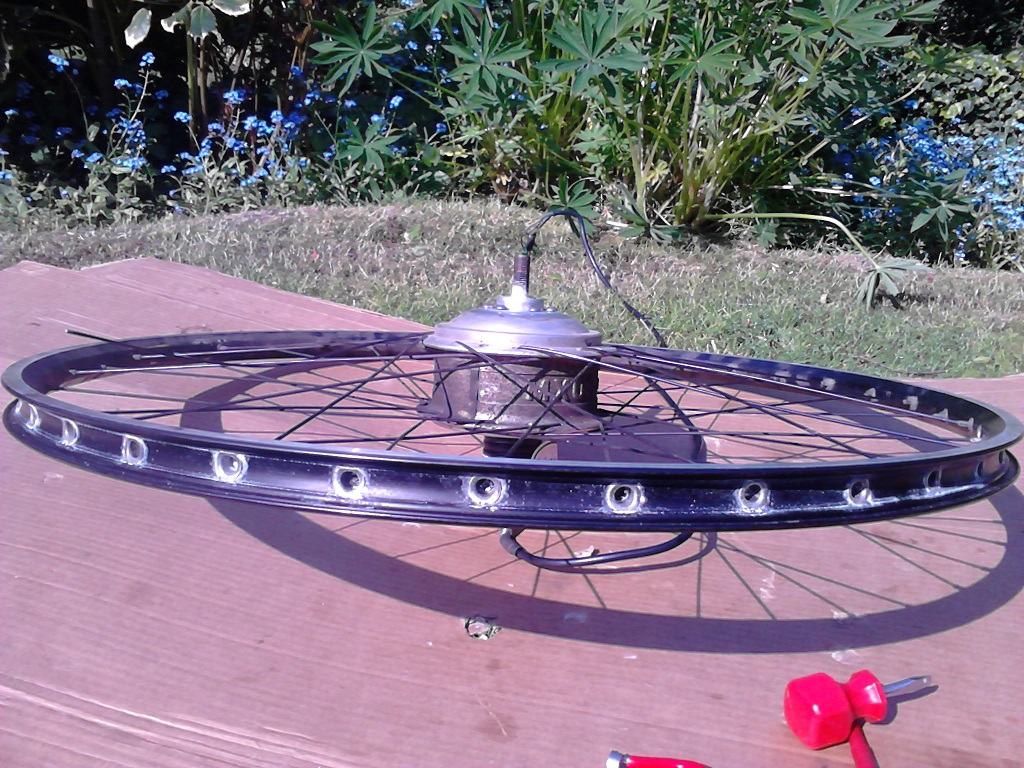

So 2500 miles and a fourth snapped spoke means it's time for some maintenance on my first wheel build as I've run out of spare spokes. I am pleased with what it has done but time to build and fit the backup wheel, this time with heavier gauge spokes and a 2x pattern instead of 3x using a bafang 250w CST motor, this will then give me time to strip down/clean/grease and rebuild a wheel with the MXUS motor with the same heavier gauge spokes when I get time.

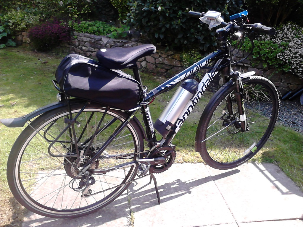

New bafang 250w CST wheel built and fitted in the easter sunshine, very similar to the MXUS in terms of power but I think the MXUS is a bit quieter and lighter. The ride feels more solid which gives me confidence in that my second wheel is better built. Also the gears got a good degreasing/refitting adjusting so pedaling and changing gears is smooth and quiet. Notice I've used d8veh's football boot bag idea on the rear shelf to house the controller and space for a future shrink wrap battery if needed. Cheap gel seat cover from Lidl fitted and added spd pedals which I think gains 1mph themselves.
Much more comfortable and pretty much feels like a new bike again. Bring on the next 2500 miles !!

The brakes needed more power so have upgraded the calipers for avid BB7 which have helped alot.

Just enjoyed reading this thread. I too built a commuter e-bike. Based on full suspension hybrid. Was surprised about broken spokes, can they be over tightened?
I am new to building wheels and I believe it was caused by uneven spoke tension.
oh, ok.
I used the "tapping tone" method to try and equal the tension. No problems so far.
I have started using that 'pinging the spokes' sound idea to check the wheel every couple of weeks or so and so far my latest wheel appears to be doing ok
I've seen a tension measuring device but I'm sure pinging is just as good.
How "true" were you able to get the wheel? I cannot seem to get better than 2 or 3mm. I think this is where the skill comes in.
The ghost of Sheldon Brown is screaming "The perfect is the enemy of the good." If I remember right, in a motorcycle MOT you are allowed 2 mm wobble, and remember that motorcycle achieve some pretty high speeds. I would guess that the pinging technique is good enough.
I would also say that wheel building follows nature`s 80 / 20 rule. It will take 20% of the time to achieve only 3 mm wobble, and 80% to get it down to 2 mm. Whatever method you use to measure tension, always remember that in a dished wheel, the tension will be higher on the drive side.
Also consider this. Think of an engine cylinder head. To ensure a gas tight seal, all the head bolts need to be tightened to the same tension. How do we measure this? We use a torque wrench. So why are we not using a miniature torque wrench to check our spoke tension?
Here is another theory. If we have a perfect hub, a perfect rim and perfect spokes, we could achieve a perfectly true wheel with all the spokes at the same tension. All these components are mass produced. Variations are inevitable. How round is that rim, to start with. If you placed it on a surface plate, would it touch all the way round? Is the tensile strength of the metal uniform throughout? I doubt it.
Therefore, to achieve a perfectly round true wheel, the spokes will need slightly different tensions to hold it in shape. We are looking at a good old British compromise. Part science, yes, but importantly part art.

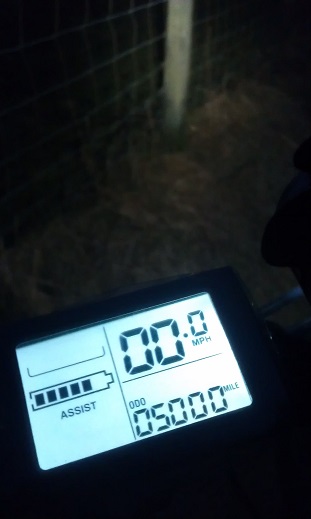

---Happy 5k miles----
Look what I spotted the other day, lucky I looked at the display just when I did.
Could I now consider the whole project paid for it's self by now?
My main battery is still the original 'cheapest at the time' 10ah bottle from BMSB doing me proud and although I've used others every so often (to keep them cycled) I am still using this charged more or less every day for 20 miles and it is still going strong lasting longer than I anticipated.
How many miles could I be likely to see out of it?

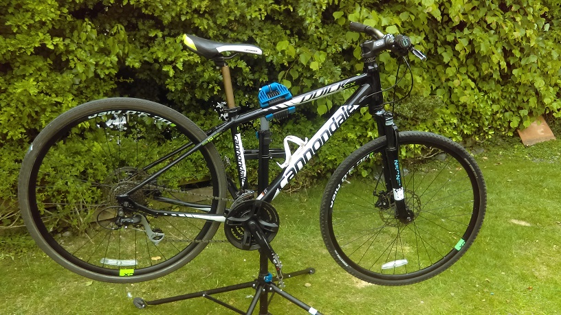

After spending over an hour and a half everyday in all weathers on the bike, here is the same bike over 6 years and 25'000 miles later transported back to a normal bicycle.
If you start a conversion with a good-quality bike, you can’t go far wrong. And you get the added benefit of being able to sell the standard bike at a reasonable price if and when it is decommissioned or you upgrade.
