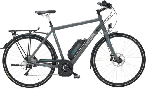

I'm very tempted by this Kettler Traveller E-Light, weighing under 20kg and for 1700euro inc shipping it looks pretty good! Could fit chunkier tyres and do the solder trick to eliminate the 25kph limit :)
What type of battery is that? Where do I get one?
Sent from my GT-I9300 using Tapatalk

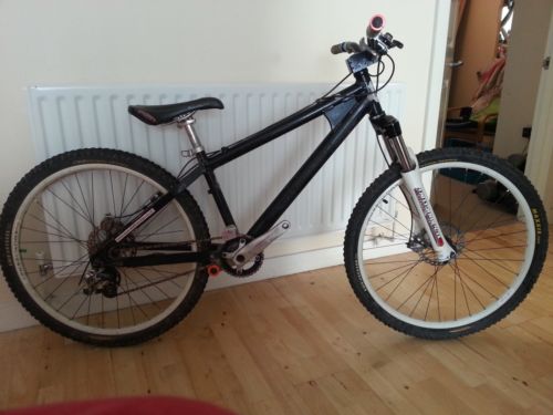

Are you intending to do much 'jumping' on the jump bike ? If so, your battery needs to be very well secured , protected and housed. Looking at the basic geometry of the bike in your photo (albeit there is no rear suspension) I'd take inspiration from the housing on this ...
