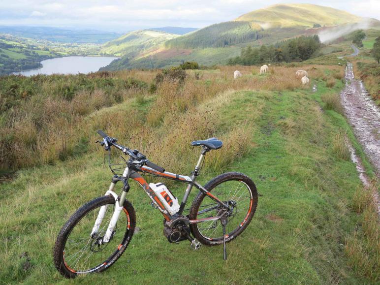

Hi everyone, the name's Peter Furlong and as the recent purchaser of our first electric bike I thought some of you might be interested in a short review on the new KTM.
To put things into context a few personal details might be useful, particularly as there seem to be degree of antipathy such machines in the wider (MTB) biking world. Maybe I can redress the balance a little. The bike will be shared by my wife, 62, and myself at 66. I'm in good shape and have ridden cycles and motorcycles off-road for 50 years, but the legs and lungs are not what they used to be and a long ride is not as enjoyable as it once was. On selling my Husqvarna 250 enduro a couple of years ago I bought a Giant Anthem full-sus MTB, a truly superb all-rounder, with a view to riding the my favourite trails somewhat slower and a lot more quietly. My wife has a more mundane Raleigh and we ride together occasionaly, but not as much as I would like. I recently noted that 'proper' MTBs are now available e-powered and hatched a cunning plan, namely that Marysia could use an e-bike and keep up more easily on rides, and I would see if I liked it well enough to fork out for one for myself. So we looked out for either a KTM or a Haibike and eventually sourced a second-hand Macina Race. So here we go with a 'first-impressions' review.
Sizing. We are luckily much the same 5'10” height but the bike was the smallest in the range at 43cm and bought unseen, so a little concerned. Well, even the 43cm model is not that small, and we are both happy with it, especially as I tend to have the saddle a lot higher.
Components, as expected, are top class. The finish seems powder coated and semi-matte, and should be tough, though dirt tends to stick a bit. Saddle far too flat, but easily changed. Now fitted a Charge Ladle ladies model, which suits us both. Brakes are very sharp, one finger at most!
Riding, on road, is much as expected. Being heavier than a standard bike, and on fat tyres, one needs a little assistance much of the time. Ours is the 2012 model with 4 power modes, each with 3 further variations. On the road Eco 1 or 2 is fine most of the time. Battery seemed to go on forever- certainly good for 70-80 k's on flattish roads.
However, living in the Welsh borders we were soon trying it off-road around the Brecon Beacons. Absolutely superb. Just put it into Tour mode and a middling gear, toggle between the 3 power settings and hills that had me sweating/pushing have ceased to exist. Handling is fine, in fact the weight makes it less skittish than an MTB, which suits M well. Being a hardtail a bit of leg-flexing is needed on the rougher stuff, but the extra power means we can lower tyre pressures a bit as well. Again, the extra mass tends to reduce hopping at the rear when seeking traction. And the smooth power delivery helps a lot here too, reducing the pulsing effect of pure human pedalling. In fact uphill traction is the biggest surprise when considering that my leg power is being doubled. I ought add that Marysia is mightily pleased too, and has found it easy to adapt. Trouble is I'm playing catch-up all the time on the Giant now.
Battery. We have the smaller capacity power pack (8Ah?) but I hate to admit that on rides so far the battery has out-lasted me. As an example I took a run up and over Hergest Ridge (any Mike Oldfield fans out there?) from Kington village, and down towards Gladestry. Vertical climb of 300 odd and mostly sheep-grazed turf. Started off with 90k range indicated, but this dropped like a stone on the climb. Lowest figure was 20k remaining. But battery still over half full. What the gauge was saying was that if I kept up this climbing malarkey I'd only have an hour or so left. But ups are usually followed by downs, and after the descent and a bit of road riding the estimated range went back up significantly. Recharge time on this one was under 2 hours. So pretty impressed to date.
Conclusions: I want one for myself, possibly a full-sus Haibike, but not too fussed. You still get a good work-out if you want a decent range, but I can go further, faster and with a grin rather that a grimace at the end. Any questions gladly answered, and if anyone wants a go on it I'm sure we can oblige. Especially if you make use of our B&B and make a weekend of it (arboynehouse.co.uk).

Nice bike ! Stunning pic. Reminds me of last year when me and some friends went to Wales green laning. Excellent fun!
