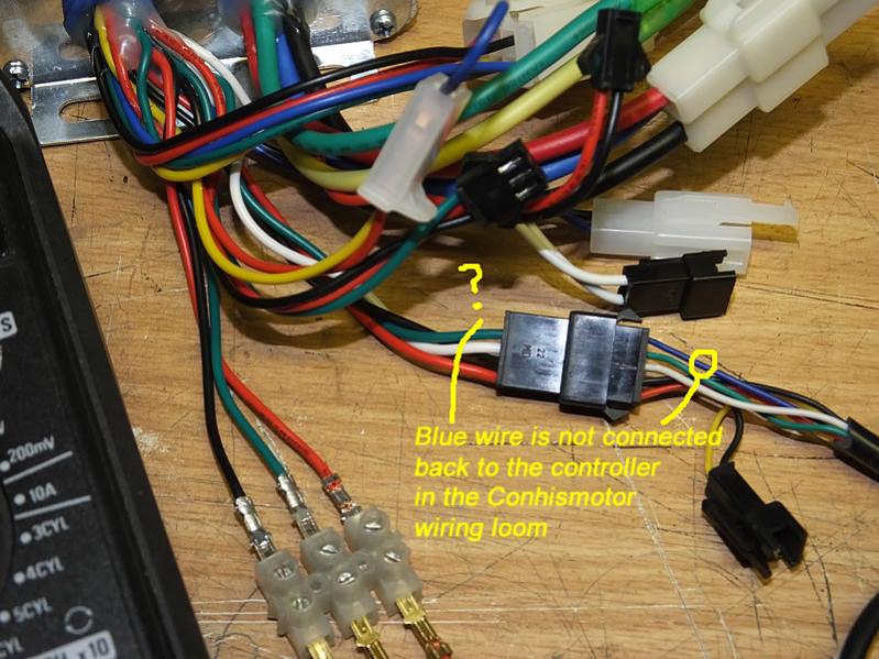

Now to the point of the thread title, on the Conhismotor site, they refer to the thin blue wire from the controller to the panel as "Blue Wire: Controller electric key lock wire" , and yet in the 5 wire connector, there is no corresponding wire linking it to the controller, it's just disconnected. When the controller is powered up and the display lit, there is full 36v battery voltage on it (around 41v), but that is not then connected back to anything.

The red wire going to the panel is 36v and is used to power the panel. When you press the power button, it's latched to the blue wire, which sends the 36v back down the blue wire to the controller to power it. All the Chinese LCD and LED panels work like that. I don't know why they call it the lock wire because it would be better to put an ignition switch on the red one.
You can test whether the 36v back to the controller is active by checking the 5v throttle or PAS supply (red and black). Once the 36v arrives back at the controller, it's cut down to 14v for the FET switching control and then again to 5V for the CPU and sensors.
The main battery wires go direct to the FETs that do nothing more than switch them on and off directly to the motor phase wires. The main CPU works at 5v, and fires out pulses of 5v to transistors, which then switch the 14v to the FETS, so the FETS fire at the same time with 36v as the controller does with 5v.

I've now been out to the garage and tested the voltages you mentioned, and also tried an interesting experiment !
Yes, when the panel is powered up, I get 4.5 volts on the red wires of the throttle and the pas connector.
I then had a thought, the Conhismotor lcd panel is identical to the one you sent me with the controller for the MXUS motor, so I swapped those over, to test the Conhismotor panel on it's own, and it worked fine.
I then looked at the wiring between the MXUS controller and the LCD panel, and that one did have a blue wire connecting the LCD's panel blue wire back to the controller.

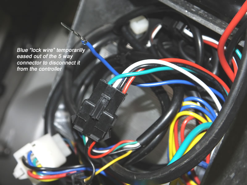

So I tried carefully easing the blue wire out of the 5 way connector, to disconnect it, as it is in the Conhismotor wiring.
I then got exactly the same result as with the apparently faulty Conhismotor controller. Everything appeared to work on the panel, but the motor doesn't spin.
I then tested for the red wires on the PAS and throttle, and I got 4.5v on them, just like on the Conhismotor controller.
So as the MXUS controller shows exactly the same readings and fault as the Conhismotor controller when the blue wire is disconnected, I'm still strongly suspecting that it should be connected back to the controller, as it may be some sort of signal that the bike is "unlocked" and ready to go.
I know it means that the connections that Conhismotor would be amazingly incorrect, and that no similar units would work without a blue wire running back to the controller, but what point would it be connected to in the controller ? It has 41 volts on it.

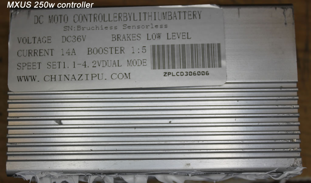

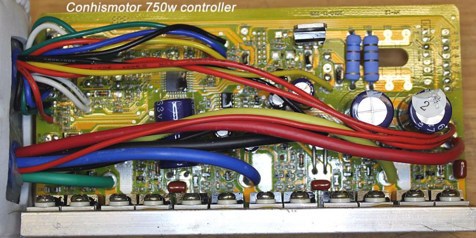

If you've still got them open, could you take some good photos of both sides of both controllers, so that we can see what's what - particularly where the blue wire goes on the small controller.

d8veh - I'll open both controllers and take detailed photos as suggested, it'd probably be quite interesting to compare them anyway, albeit one is for 350w and the other is for 750w.

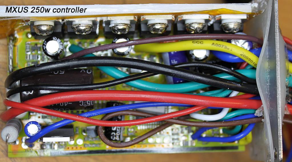

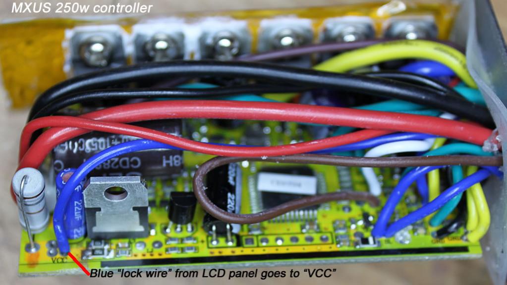

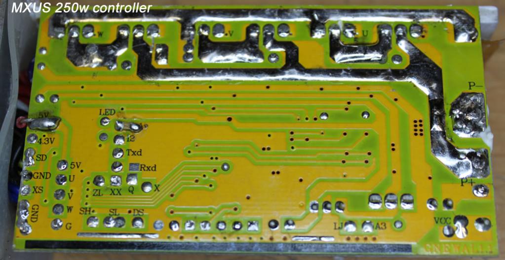

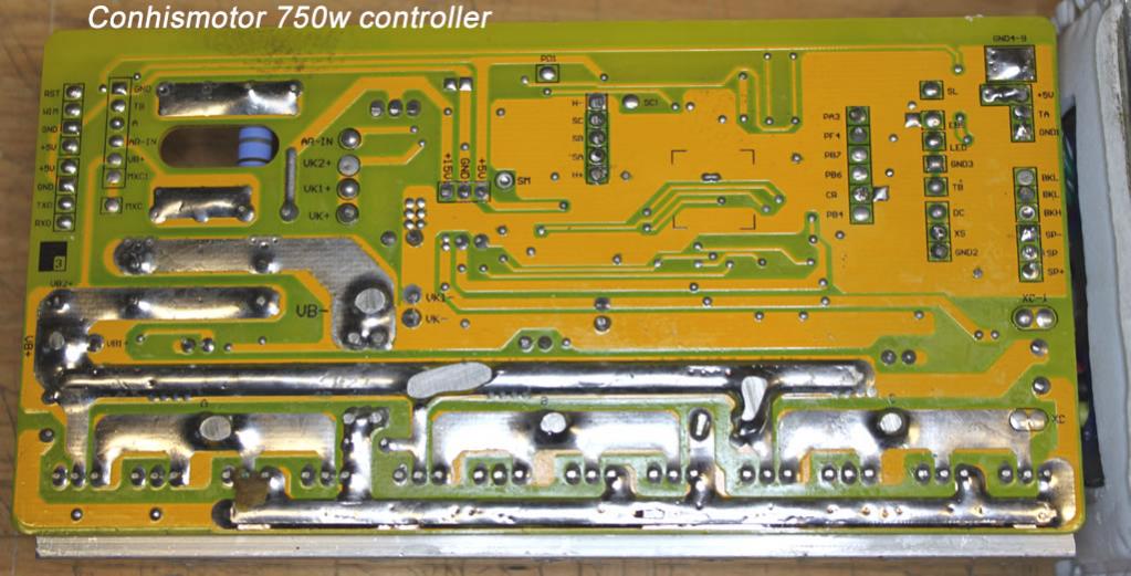

Here's the photos of the inside of the two controllers.
The blue wire from the LCD panel on the MXUS controller is connected to VCC on the board, and brings 41v back to it from the LCD panel. (When disconnected at the 5 wire connector, there's 41v on the panel end, and zero on the controller end.
There's no corresponding larger marker point on the Conhismotor controller.

Just to confirm:
- on the MXUS kit, the blue wire is connected to Vcc on the controller side, suppling 36V to the electric lock input of the LCD panel.
- when you unplug the blue wire on the controller side, the MXUS motor does not work
Question:
does the votage on the blue wire LCD side show 0V when you disconnect the blue wire controller side?
Suggestion:
If it does, then on the 750W controller, pull up the missing blue position (controller side) to 36V with some resitor.
It's the other way round. The blue wire is an output from the panel. It's latched on when you press the power button. Normally, it goes to the controller, through the big resistor to the 14v regulator, and then on to the 5v regulator.
It appears to do that on the small controller, in which case the 5v on the throttle will only be present when the blue wire is active.
The large controller is different. I can't follow the tracks from the photo, but there should still be 36v on the big resistors, 14v from the first regulator and 5v on the throttle.
Dave's answer is the result that I'm getting.
The blue wire from the LCD panel goes up to 41v when the panel is switched on, so it's trying to send it back to the controller. When the blue is disconnected, it leaves 41v on the panel wire, and nothing on the wire to the controller.
On the MXUS setup the blue is connected to VCC.
On the Conhismotor setup, the blue isn't connected back to the controller at all.

On the small controller, the 5v goes off when you disconnect the blue wire. It doesn't with the large one, so they're wired completely differently. The large one has the additional red and yellow wires, which Iused to think were also necessary to connect to bring the 36v to the controller, but I'm not sure now. The CPU must be sensing something else to prevent it from giving power. I have the same controller on my GNG, where it works perfectly. Geoff9 also has one (250w version), which worked straight out of the box.It has exactly the same wires.
......The CPU must be sensing something else to prevent it from giving power......
I think that's it, in a nutshell Dave.
As you say, the big controller has the red/yellow pair, whereas the small controller presumably monitors the blue wire back from the LCD to serve the same purpose.
It adds suspicion in my mind that the large controller and the LCD weren't originally designed for each other, unlike the small controller and identical LCD panel, which doesn't have the red/yellow lock switching.

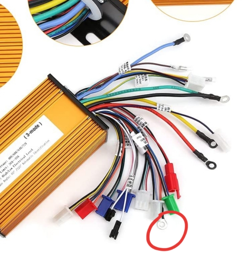

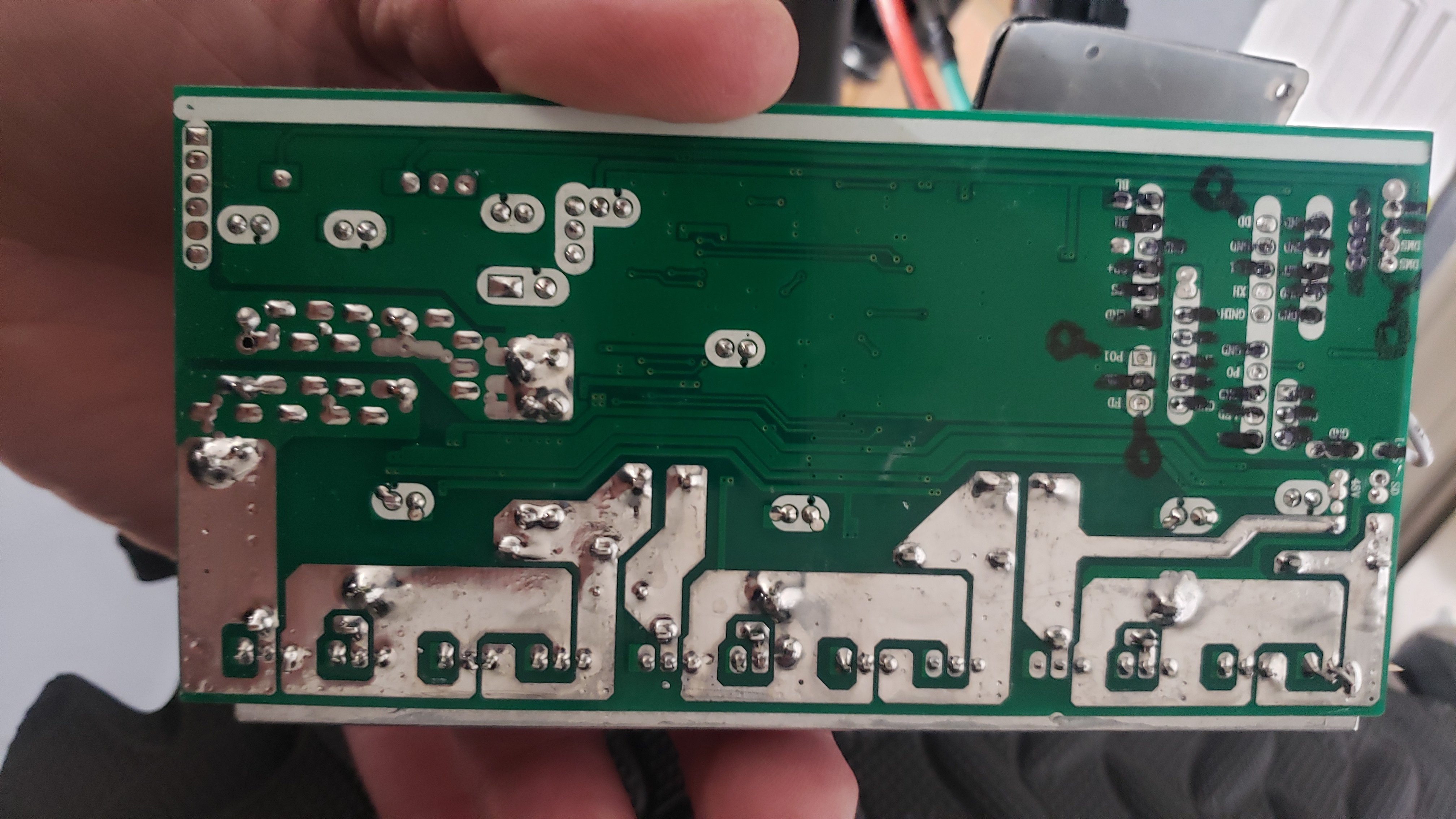

Im having a similar issue. Im rewiring a ebike controller and my dumb self assumed i didnt need a few of the wires, so i desoldered them from the controller...(one wire i took out labeled "electric door lock - must be connected).
I swore i took pics of the wire removals just in case i needed to resolder them. I checked everywhere for the pics but to no avail. I usually always video or pic out my electronics assembly/disassembly.

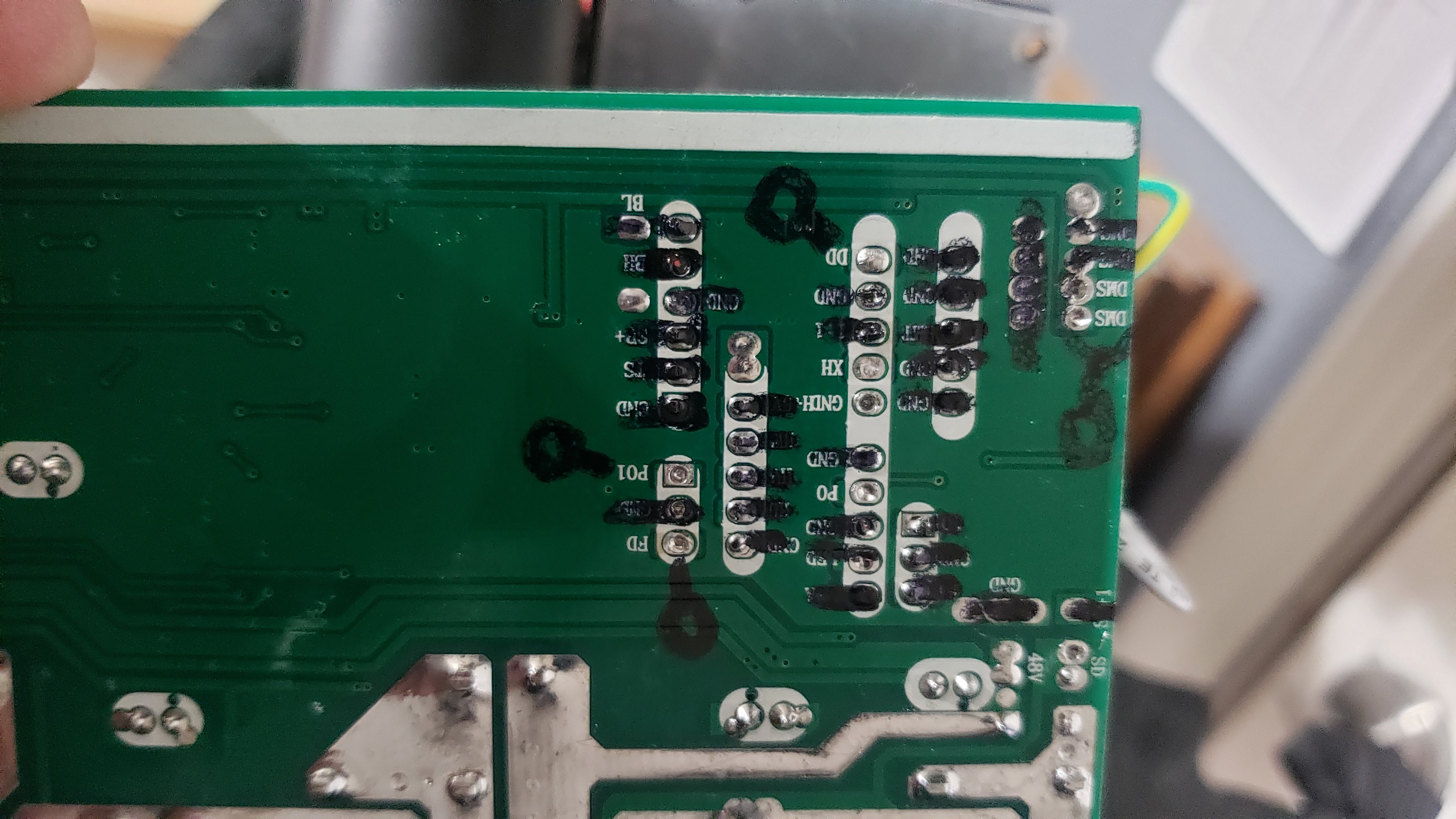

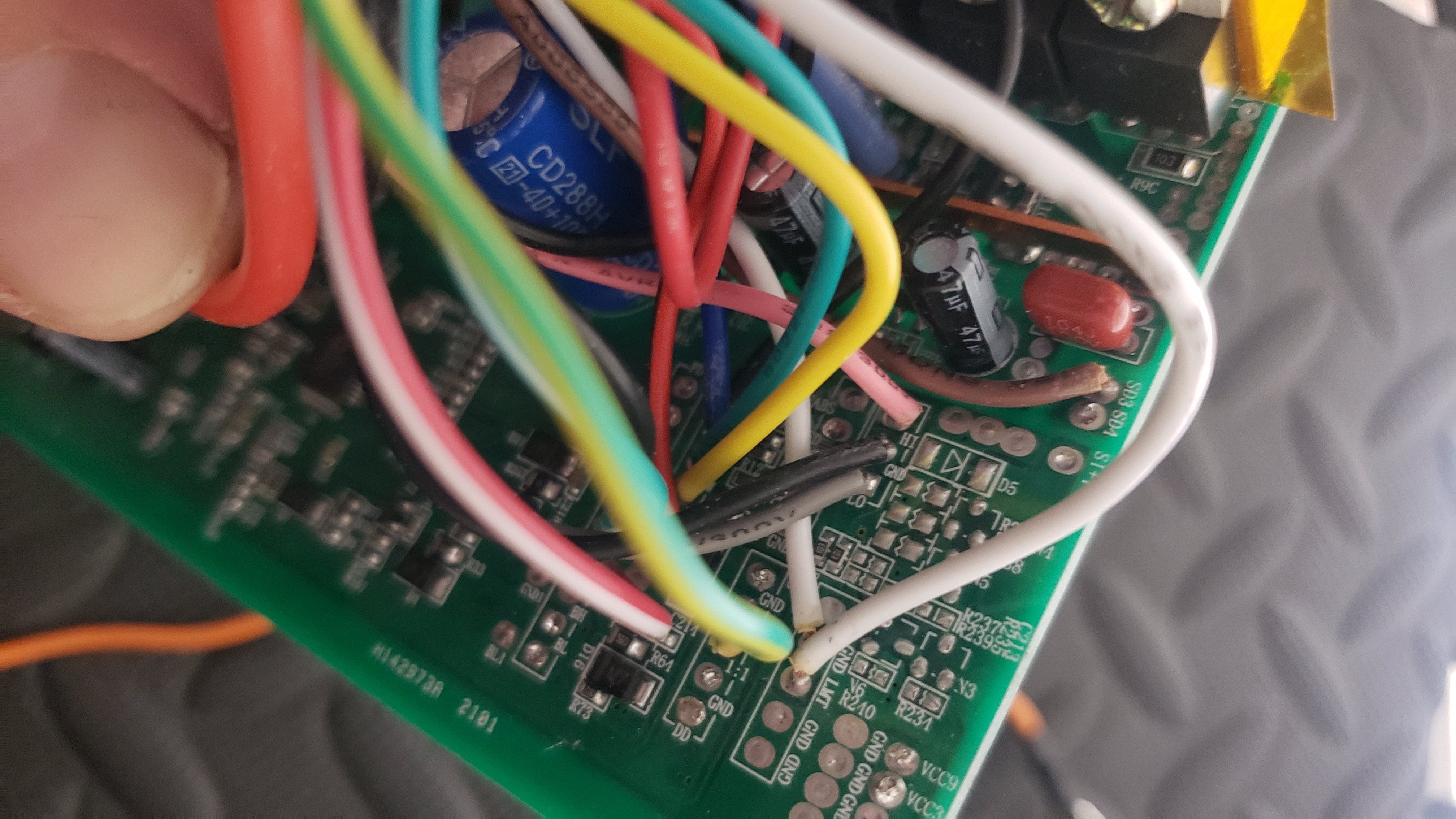

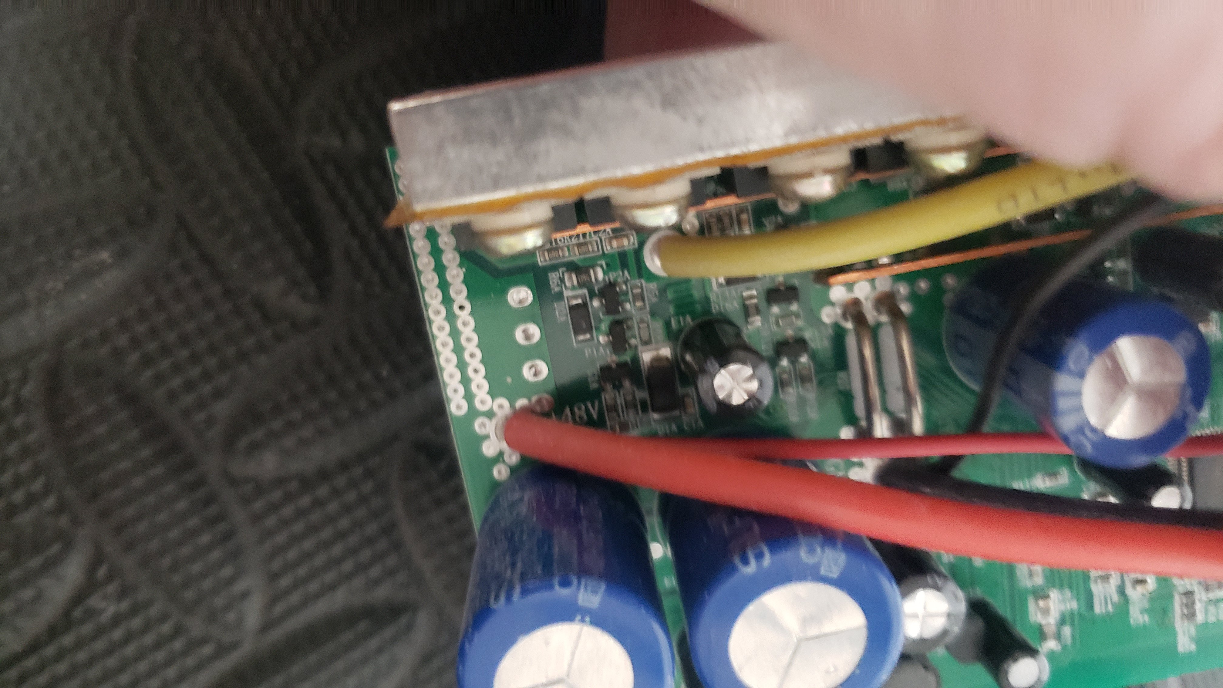

So now im in a pickle. Ive searched the internet for photos or anything to help me where this wire needs to be located on the board. Can anyone help? Heres some pics. The orange wire is what needs to be resoldered and connected. It say it needs to be connected to voltage but do i just connect the door lock wire directly to the battery? 60v battery? Any help would be great. This site is the closest ive found to any kind of answer....
The marker marks where i think it may or may not be, but not 100%.
You are right, the orange wire needs battery voltage to activate the controller, you can run it through a switch or connect straight to + battery connection, but I can't identify where to solder it to the board. Some of your photos are a too fuzzy. Look for a connection marked Lock, LCK maybe?
I will have a look at the spare controllers I have, one I know has a lock connection on it. Next time cut the wires close to the board leaving a bit of insulation attached ;)
