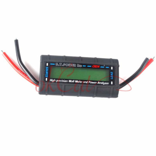

I'm just completing a controller and battery upgrade on my Giant Trance conversion and I've run into a problem.
I'm permanently installing one of those cheap Ebay wattmeters, the GT Power RC.
The 48v battery, BMS S12S sine wave controller, and MXUS cassette motor are all working fine, but the wattmeter is flashing on and off.
When the power is first switched on it starts up ok and shows the figures for a second or so, then flashes the backlight but the display letters disappear.
When it's switched off, the numbers reappear briefly, but then fade away, (as they would when switched off).
I'm thinking that the BMS in the battery is maybe pulsing the output ?

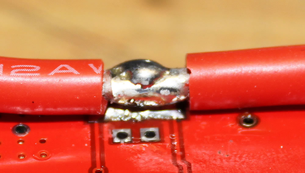

Here's the live solder joint on the power meter that was flashing.
It looks a bit "dry" with flux lines rather than a clean blob. I desoldered it and sucked the solder off, but the meter still flashes when connected to 48 volts, (though 12v and 36v display ok.
I guess as Dave said, there's something else breaking down in there as the voltage rises. (They're supposed to be suitable for up tp 60v 130 amps).
I opened my other GT meter and the solder joints were much better, and that does work ok with 48 volts, so I've wired that one in to my new 48v pannier bag mount, and have ordered another GT power meter via Ebay ( £12.50, delivered). I use that one with a variety of interchangeable leads, and it's very handy for checking how many a/h it takes to recharge after a run.
