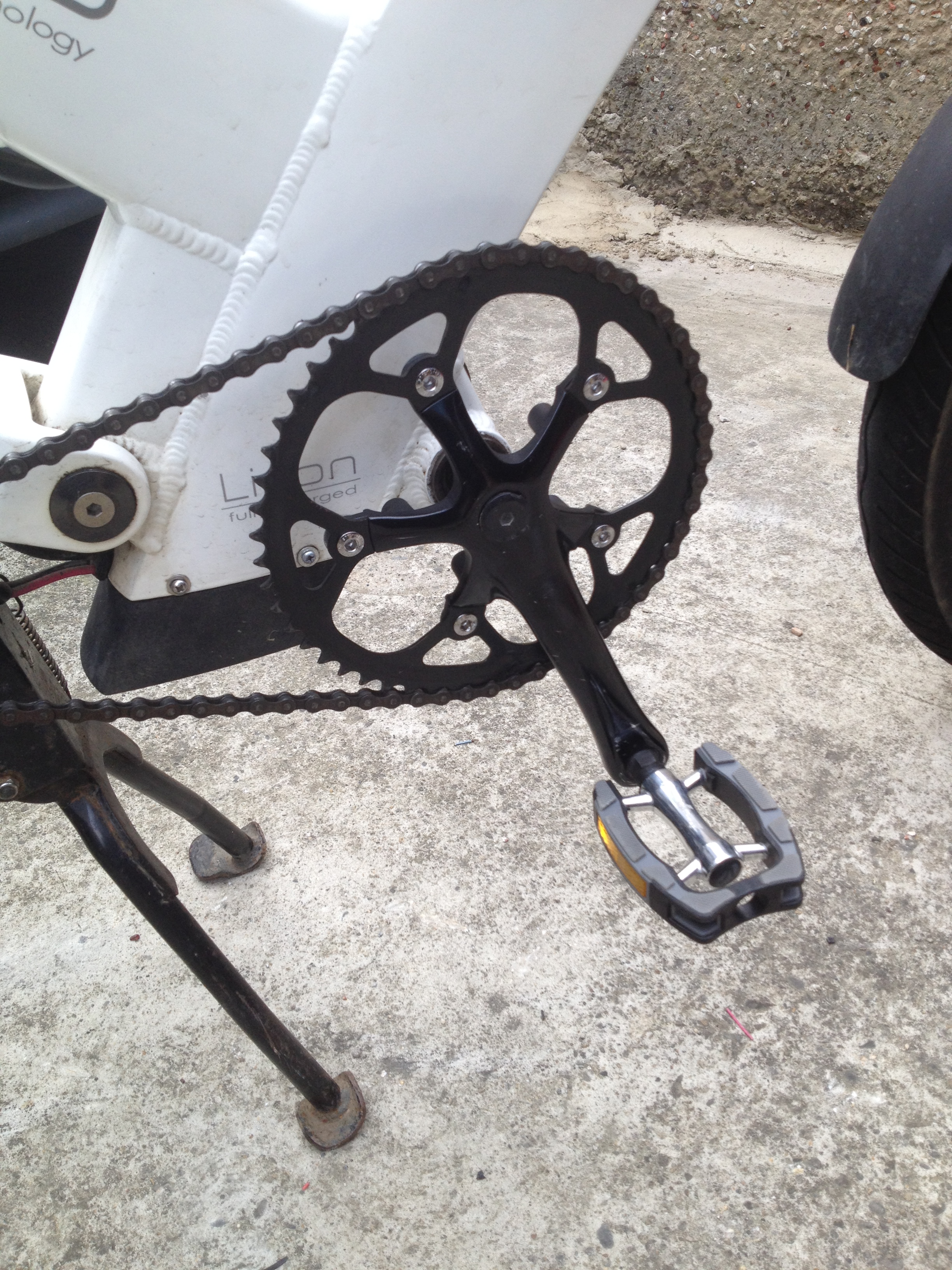

  • The main one now. Upped the stock 42T chainwheel to a 44T, not big enough, then a 48T, still not enough, and finally a 53T (had to change the chainset in order to achieve this. This is the best thing to do with any of these bikes, the performance is 100% better, no more "ghost pedalling", great power delivery for a commuter bike. Just ordered a 53T chain guard now to stop any trouser entanglement!
[ATTACH]8833[/ATTACH]
Goodness! That's a f..jolly big chainring:eek:
Works really well. As it's a heavy bike it really gets some momentum going on the flats, and I couldn't pedal along fast enough. The big chain wheel has made a massive difference. Handling wise it rides like a motorbike, had to learn how to lean into corners properly. But a great solid ride for city centre commuting.
