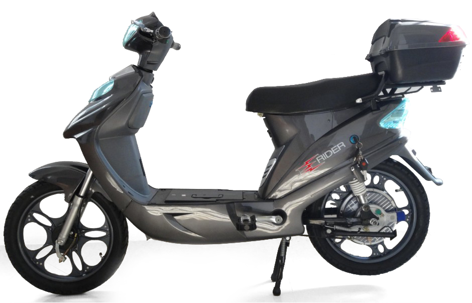

GUIDE TO UK LAW
http://eriderbikes.com/wp-content/uploads/2013/12/Front-LeftE-150x150.jpg
  • Anyone 14 years or older can ride the E RIDER on the road
  • Younger riders may use the E RIDER off road
  • The E RIDER is not subject to Vehicle Excise Duty
  • A driving licence is not required to operate the E RIDER
  • The E RIDER does not require an MOT
  • Insurance is not legally required for the E RIDER
  • The E RIDER does not need to be registered with the DVLA
  • The E RIDER may be used in bus lanes and on cycle paths
  • A helmet is not legally required when operating the E RIDER *
  • The E RIDER is not liable to parking fines or congestion charges
  • An E RIDER is not required to provide a breath or blood sample *
How can any right thinking person think this is a bicycle!
The spec says 39kg and 200W of power yeh!!
Kudosdave
If it has two wheels, usable pedals, a motor of 200W or less, weighs less than 40kg, a speed less than 15 mph, then it's a bicycle regardless of what your paradigms make you think one should look like. The only question is whether it meets those criteria. Whether it does or doesn't is probably not as important as having a plate or piece of paper that says it does as far as the police are concerned, but if an unhappy customer thought it didn't meet those criteria, so went to trading standards, life could be a bit difficult for the seller.
