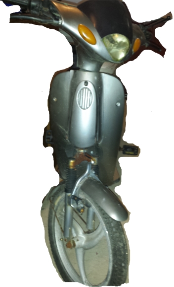

Well i took a punt for the grand sum of.... £20.
Stickers say Bike Easy, Supplied by Broadribbs. It comes with rusty bits that were once chrome. A small topbox held on by some rust.
Guy said he bought it from a police auction and didnt have keys or the inclination to do anything to it. Not even check to see if it was complete.
Removing the locks to the topbox found the original toolkit, removed the lock to the seat and founf 3 x 12v SLA batteries (10Ah) in a strange case.
Checked the voltage to each battery and they are 7 volts. I dont have a 36v charger so will be doing them one at a time to see if they will hold a full 12v.
Anyone help on the ignition switch? 3 wires. Red, Green and white. Do i join all 3 or?
Indicator switches appear to be seized. No switches for the lights so assume they are on with the ignition.
I pedalled it with the switch set to on, But batteries removed and a red light appeared on the display and the horn worked.
So it maybe worth trying to sort it.
Run it on SLA for now whilst i save for some lithium batteries.
Found the controller under the front floor. eek how many wires?

Having a tinker, My CTEK charger seems to be doing its job on the first battery. 12.3 volts so far. At least it didn't flash up dud battery. So hope yet.
Any idea on the ignition wires though? Switch on left handlebar causes a red LED to light when pedalling.
My scooter switch had 2 red and a green the reds were shorted together and the switch connected the reds to green for on.
Can you dismantle the switch to work out the wiring if no one replies with the wiring.
I just found this, a meter would be able to confirm if it is similar switch wise, it's meant to be a typical electric scooter wiring.
http://www.wiringdiagrams21.com/wp-content/uploads/2010/09/scooterwiringdiagram_thumb.jpg

Thanks Geebee, The ignition switch is a plastic block thats sealed with hot melt glue or similar.
I have no idea how many wires run to the motor. Guessing its an old bike and just 2 wires. Not one of these fancy modern motors.
Lights appear to be standard bulbs not LEDs so they will be swapped.
A partially seized slider switch on the left i presume is the indicator. Another smaller red switch. With it on i pedal and a red led on the dash lights up.
No idea what thats for?
Looks like the batteries will be charging for a few days. I dont want to fry them so chose the bike battery option on my charger. And having to charge one at a time. damn..
Battery connector is a standard 240v kettle style plug. Silly i thought. What if someone plugged the battery or scooter into the mains...eeekkk..
Thanks Synthman, I have not looked underneath yet. I do hope its not rotten.
Test meter across the battery plug. One side gives continuity on the green wire and the other gives continuity on the white wire.

The red led will most likely just be the power on led as they often run regen and the bike will just see it as power on.
The regen, if you live some where hilly basicly removes the Peukert effect allowing a 12 amp battery to give an easy 12 ah of power instead of closer to 6 ah. One possible issue is I dont know how the Lipo's will cope with a fairly crude regen, on mine the voltage would almost go off scale on steep hills.
Glad you mentioned that. Ive seen the results of overcharging lipo's. Although i would imagine it would need a fairly steep hill to put that much charge into them.
Just spun the pedals as fast as i can and it only reached 12 volts. But the battery plug received that voltage whether the switch was on or off.

Charged one of the batteries to 12.5 last night and its down to 11.8 this morning so i think they are past it.
If they all get to that at least you can at test the electrics are working and test the motor on the stand.
I have some spare 12Ah batteries i bought for my FIL's mobility scooter. The batteries fitted are 10Ah but appear to be the same size.
I want to charge these a few times to see if they recover first though, before i start cutting cables etc.
Going to have a look underneath and crossing my fingers the frames not a rusty mess.
Was just about to look for a decent charger but thought what if i up the voltage to 48v. I will wait.
So far things are looking good. Tyres hold pressure, It appears complete except the keys. I was expecting to find the batteries and controller missing.

I got bored waiting for the batteries to charge.. 12 and a bit volts only...
IT WORKS!!! well on the stand anyway. Joined the 3 ignition wires together. One puts the lights on and the other is the main feed.
Connected up and nothing. put the little red switch on and the dash came to life.
Throttle appeared to do nothing. But i spun the pedals with the throttle on and LIFE!!!
Seems you need to pedal to kick the motor in, If you hold the throttle power stays on. If you release the throttle then you need to pedal again for the motor.

Tried it up and down the road. Only a short couple of minutes, Not exactly a ball of fire but moving along OK. Will be fun finding finding out if it will manage a hill or not.
Brakes are awful. Noise!!!
Lets see if pictures work.
Bike1.jpg.cfc1a4f3e1e06ad3c8d9ae6ede64df8d.jpg Bike2.jpg.540297562b87990076fdef314f5e6909.jpg
