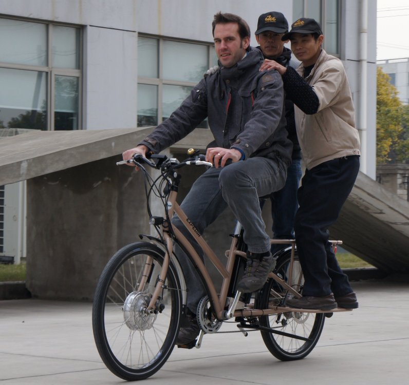

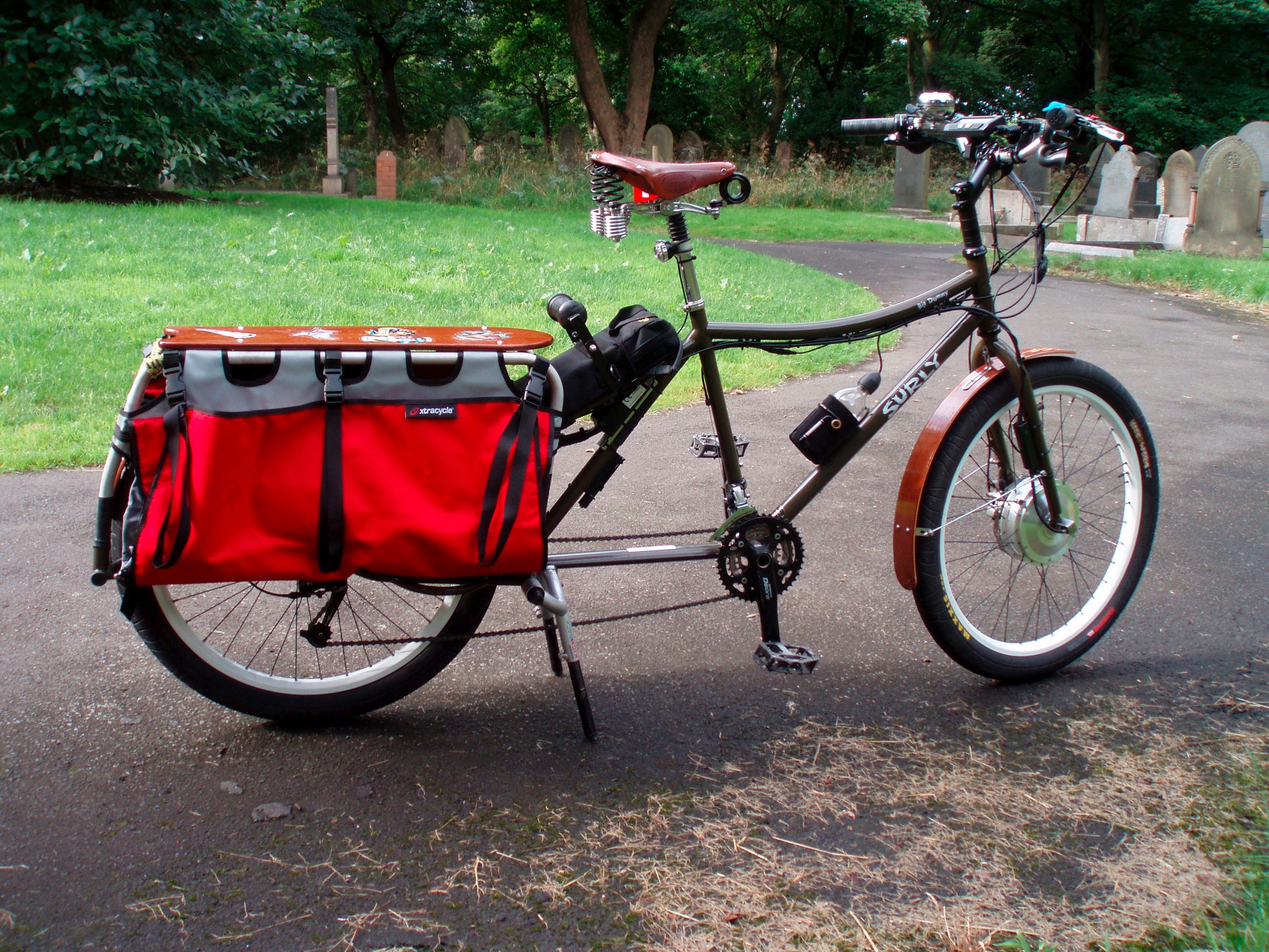

We already have a few customers in Oxford, one of them has an eZee powered Yuba el Mundo that he uses amongst other things to take his kids to school so you don't need to worry about using your Surly conversion.
Yuba el Mundo
Another customers eZee powered Big Dummy
Yuba el Mundo
