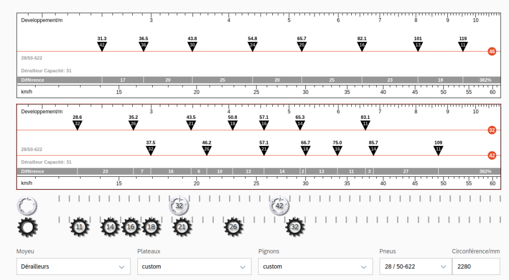

  18. Somewhere in the French postal strike there may be an eight speed shifter/brake lever combo, the nice Chinese man first sent me a 7 speed one by mistake... As soon as it gets here there will be two bikes in bits in the living room: - Alivio 8 speed rear derailleur off the trike (replaced by Deore 9 speed) - 11-42 8 speed cassette instead of 12-32 7 speed - original 46 tooth chainwheel back on the GSM. I will replace with a 42 tooth narrow/wide precialps one if it fails the climbing test out the back of my apartment. Fingers crossed, I want to keep the budget down despite the 46 tooth being boat anchor weight... - new Wippermann Connex chain after somewhere over 4750 km (remember all those km without a speed sensor at the beginning of this thread) I will also open the controller holder box for the first time since I mounted the lights to do a brief checkup (fingers crossed) and look at the headset bearings. Gearing comparison:
