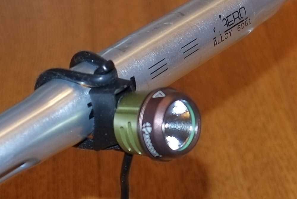

Had this turn up today and just did a 1 hour 45 mins ride in the wood and the light is just fab far better light than my old one, but I may have to get a bigger battery pack, I don't think it will last anymore than about 2 hours.
I will try and take some pics the next time I'm outimage.thumb.jpg.5ccc240b35ff088fa76cbdf360b8dd14.jpg
