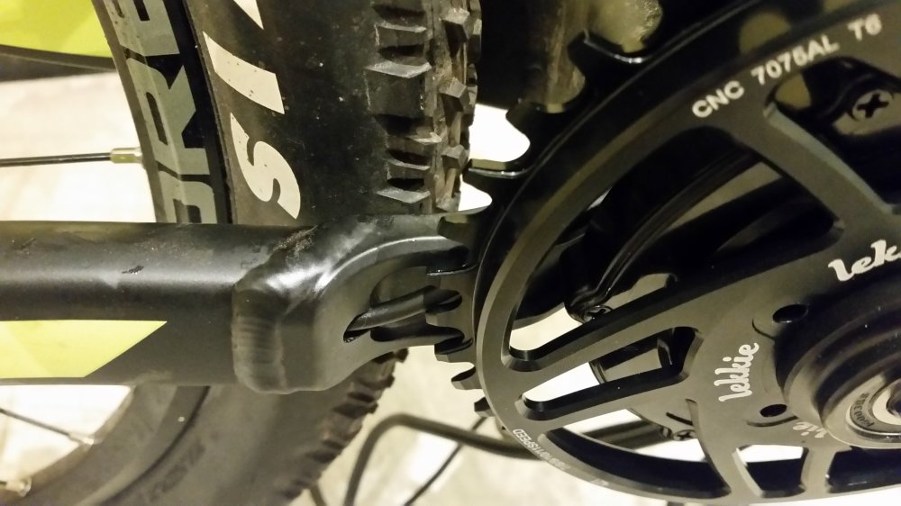

e Day has finally arrived.
Build is progressing after a couple of obstacles avoided. Had to remove chain gaurd mounts and reroute rear derailleur cable.
This e bike build is turning out to be an expensive business. So far have purchased:
1. New chain ring to improve chain line.
2. New chain because old one was too short.
3. New left crank arm because the stock Bafang one (probably to keep cost down ) has no offset.
I sure there will be more no doubt. Haven't even got onto the battery yet!
