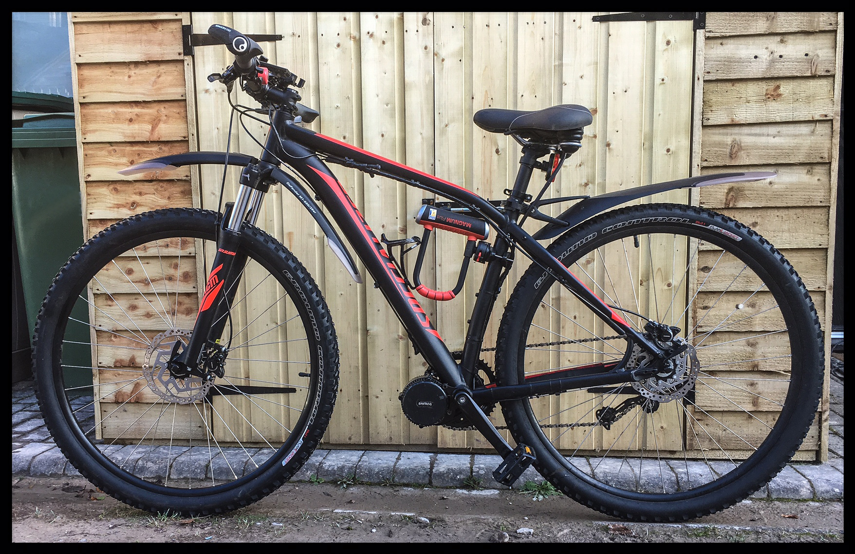

I can recommend the Specialized Rockhopper Sport (2017 model) - I have one and the BBSxx works perfectly - I chose the mid drive conversion because of its torque, weight distribution and aesthetics. I use the bike as a daily commuter and as a 'weekend warrior' mountain bike - it does both jobs brilliantly. You will definitely benefit from the bike's hydraulic disc brakes and possibly consider the optional hydraulic brake sensors that are available for the kit. However, to make a neat job of those, you'll need different brake levers than those supplied either on the bike, or in the kit.
The bottom bracket size states 73mm on the Rockhopper spec sheet, which I thought would mean that I wouldn't be able to use the locking nut. Whilst the bottom bracket itself is, indeed, 73mm wide, the bottom bracket 'shell' is only around 70mm and therefore accommodates the locking nut easily.
The locking nut fits! Note that you will need the longer hex bolts and extra washers to use as spacers.

Also (another happy accident)! with this bike; the supplied Bafang chain ring sits at exactly the right space from the chain stay, so there is no need to worry about having to purchase another ring, or spacers.
Perfect!
The chain hasn't come off once...
