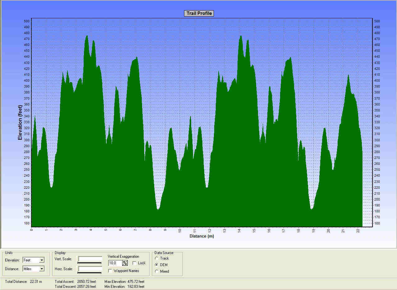

Im back with the medium setting range test, though it has produced some strange outcomes as you will see.
Conditions.
49cm Pro-Connect.
18 tooth rear sprocket modification.
Male rider (much fitter).
5ft 11inch tall.
13stone 7lbs.
Pannier with total weight of 10lbs.
Total weight 199lbs.
Bike on medium power all the way.
Fully charged to dead battery based on 4 identical commutes with a few circular laps around my home until the battery eventually died.
the max hill was a 1 in 7.
Results....
22.31miles which included 2,050.72 feet of ascent.
I am a little puzzled to why i have less range by moving from high power to medium power settings?
These could be the reasons...
1. i am much more fitter now, and therefore the power in my legs is drawing more current from the batteries up steep hills.
2. My rider style has now changed and im finding myself peddling constantly during my commute to work. I do the 5.12 mile commute now in 19mins as opposed to 23mins last month.
3. I have started to have my lights on all the time on the bike now the evenings and mornings are getting darker ( I work the night shift).
All data came from my Garmin etrex attached to the bike.
Data was then uploaded to my PC and compiled by my Fugawi mapping software.
Low (Eco) power setting range in the next few weeks.
Any comparisons?
Regards Bob.
[ATTACH]375.vB[/ATTACH]
Edited by burncycle

Does anyone feel that the reasons I've listed could be lowering the range then?
Feels like its falling on deaf ears.
I did study your post Bob, but I couldn't reach a conclusion due to the variables. As you've remarked, the fitness
variations might account for it, since in a completely like for like test, that wouldn't happen, higher power to do a
job almost invariably leading to heavier consumption.
So as near as I could get is that you are probably right about the reasons, your differences over time.
Thanks Tony for the response.
You dont think it could or might be a battery issue?
I very much doubt it Bob, these bateries normally very consistent, hence their unique guarantee. It may be that
the lights are a bigger factor than we are allowing for, since they use an odd high voltage pulsed system to
produce an average lower voltage for the lights, and that might be a bit wasteful. It's interesting that a recent
photo of a Pro Connect showed it with a front hubdyno like that on the Agattu, so perhaps they've had second
thoughts.
I don't know if it's viable for you to do some more running without the lights to see what difference that makes,
though obviously please don't take any risks on that account.

I did notice your first test was 1 in 10 max on high power and your second 1 in 7 on medium
so the different climbing might account for some range loss?
The main thing I notice is that your journey is over 17% faster, so more power is coming from you & bike combined -
the range loss is quite low for the speed gain though, so I'd be happy with that and if you want more range
just increase your fitness & pedal speed and/or cut your road speed. :)
