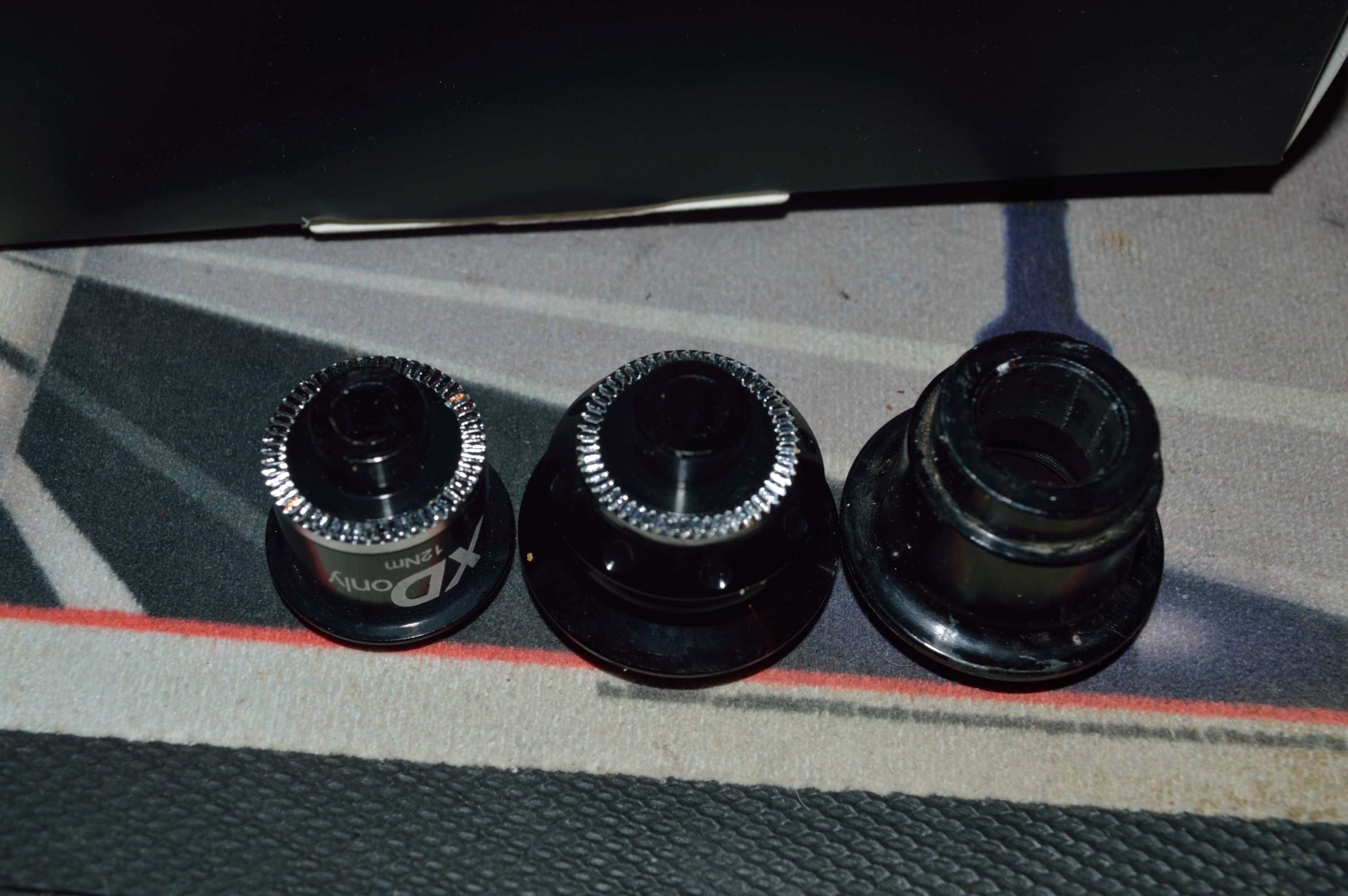

[ATTACH=full]18108[/ATTACH]
axle is the one on the right, 2 left are qr ;)

The wheels are set for axle so I have to pull the carriers out and replace them for the QR ones shown in your picture?
Just pliers and pull ?
Could not find a youtube video to show this bit being done.
The axle and spline is already fitted, do I need to remove that to grease it before fitting the gears.
i thought you got the ones you gave in the link as dont come with any fitted none do.
end caps just pop on and off.
if the hub has been fitted then it is ready for the gears to be fitted.
