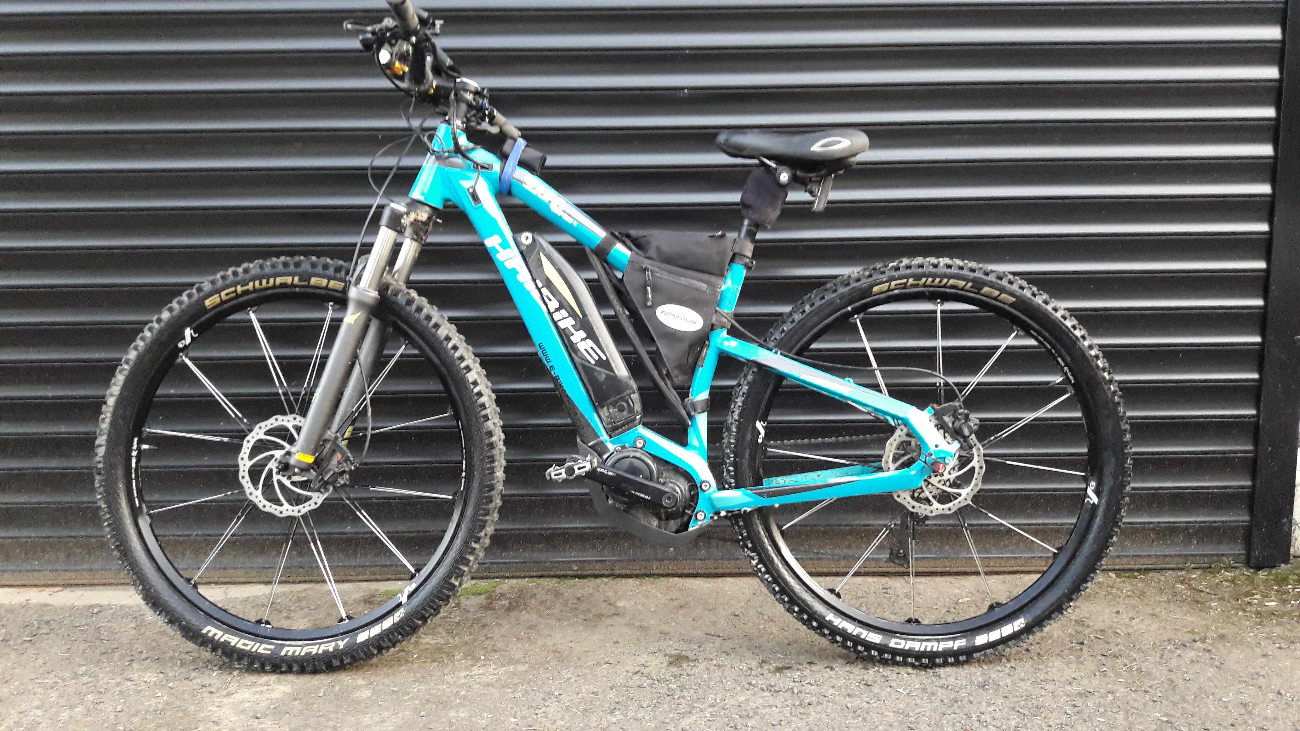

April 1, 20179 yr Author I am finally 50% of the way there. One tube one tubeless. The HD is so tight it inflated with my normal tyre pump. If anyone else fancies a second set of wheels to make things easy DON'T, buy a second bike, nothing fits! It has taken me ages to get everything together. Adjust this, change that, get another of those. It was too nice this afternoon to take the Mary off the front so went with what I had for a nice trip out in the sun. The HD is a good off road tyre, but a PITA just like the Mary to fit. Had to try a bit of off road once I was sure the brakes worked and the wheel was not going to fall off and the speed sensor was fitted and the brakes realigned and the sqewers tight ( sorry to keep going on about it being a PITA ).

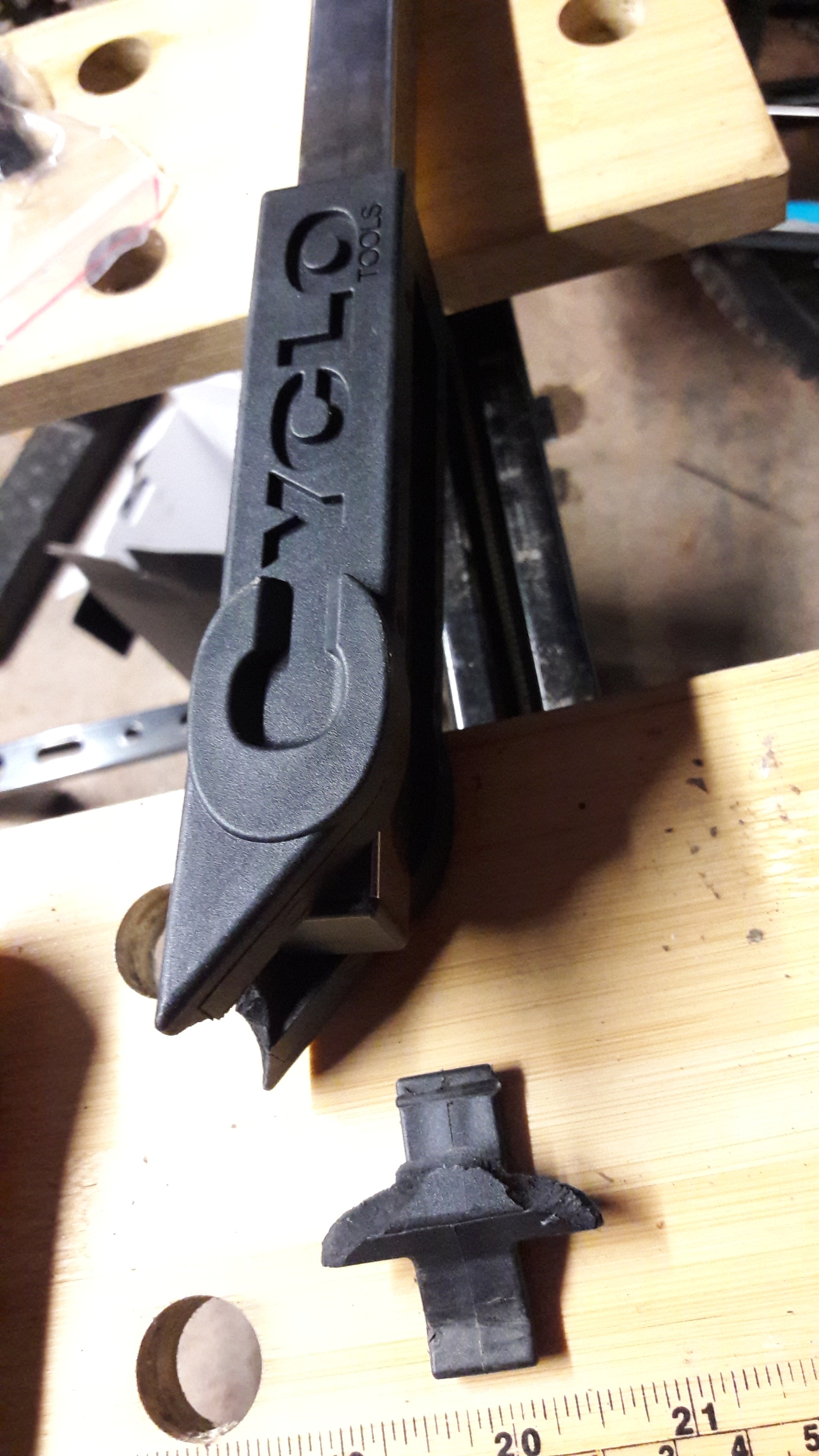

April 3, 20179 yr Author SG Magic Mary or Hans Dampf, no easy way to fit at all. Watched the video on fitting difficult tyres by pushing the tyre into the well of the rim to make fitting sooo easy. In reality once you have the one side in there is no room in the well for the other side, another urban myth. Specialist tool I hear you say ? For anyone interested the tool does not come in two parts, but ends up that way after trying to fit a HD ? I did say Money pit. So back to a great big screwdriver wrapped in tape and just heave again. I used baby powder to lubricate the tyre rather than fairy liquid as I thought it might contaminate the slime? Read the sealant instructions and found nothing about lubrication. So building up courage to remove the Mary and refit on my front rim. In all seriousness if I had a broken glass or ring pull cut puncture there is absolutely no way you would ever remove the tyre to effect a repair in the field. To put the slime in I used a big syringe on the valve once the tyre was fitted and it worked well. If I had put it in the bottom of the open tyre before fitting there would be none in the tyre but plenty on me and the floor at the end. I am not looking forward to removing and then refitting the Mary at all. And bloody yes there are nasty scratches on my new rims..... self inflicted !
April 3, 20179 yr man that is some huge scratches get a permanent marker pen n fill them in then you wont see them maybe take the tyre and rim to halfords hand over 5 quid and make them suffer pmsl then bet them if they cant fit it in 30mins its free or if they can extra 5 quid

April 4, 20179 yr Author So what do you think with 50% of the job done ? The Mary was a lot easier to get back on than when new, no fairy liquid but a big screw driver taped up. So it can be done, maybe the Kevlar ones loosen up after a bit. Had to roll the wheel and tube a bit to coax it to blow up with the foot pump but managed it easily enough without too much stress or mess. Went out for a ride to just check nothing fell off, ran the Mary with 40 psi in all seemed well. Still to reduce the pressure right down for proper TL riding. Next is the decision of what to put on the original rims ?
April 4, 20179 yr So what do you think with 50% of the job done ? see looks like a different bike but what do you think of the lighter wheels to the stock old ones? you still need a fox front shock and some blue peddles and blue grips to finish it off
