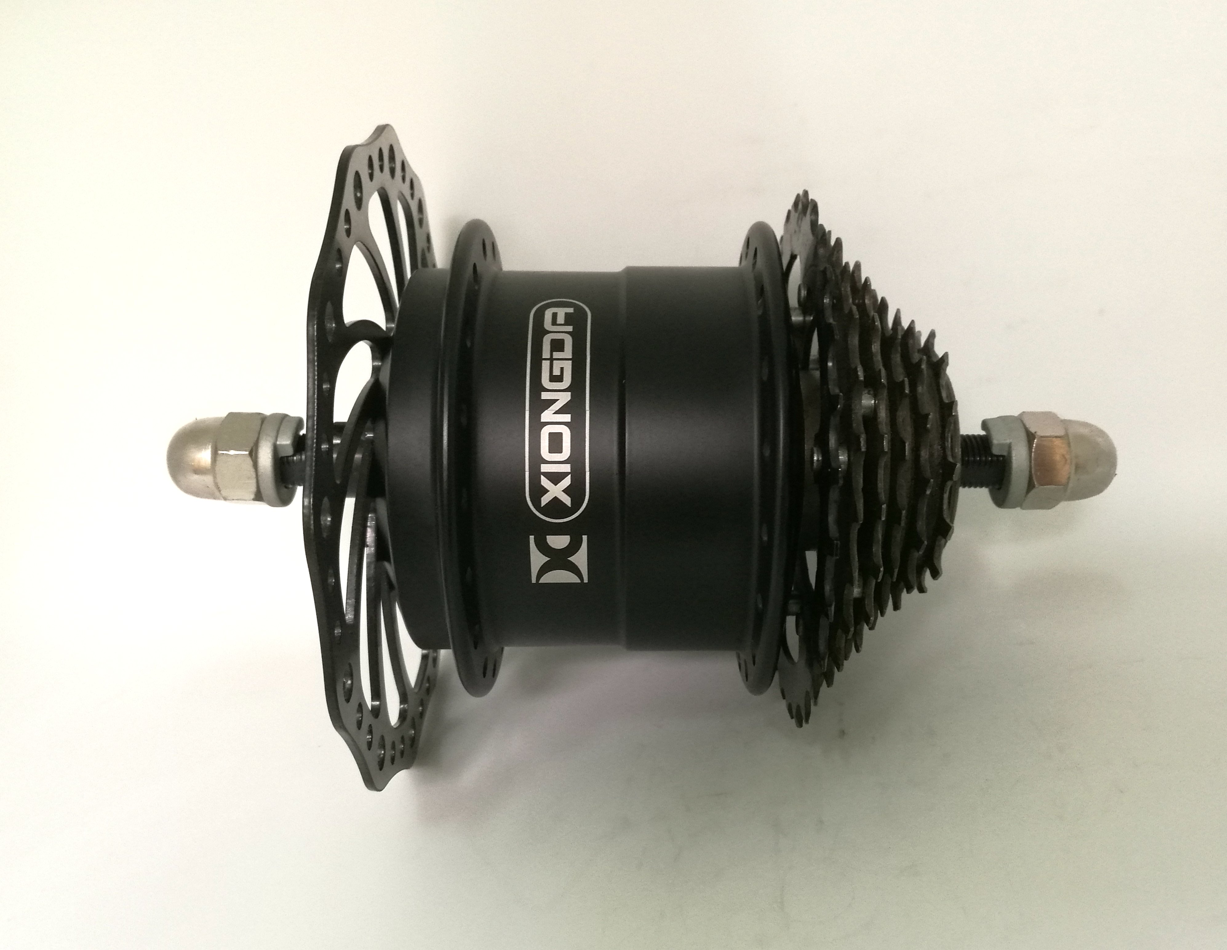

June 3, 20178 yr I got the info about these motors from Xiongda today. 1.4kg is significantly lighter than a Q100. I've ordered a couple for testing, but I expect only to use the front one. If anyone wants to call first dibs on the back one, send me a PM: YTW-06碟刹外变速外形图.pdfYTW-06碟刹前驱外形图.pdfYTW-06曲线.pdf

June 4, 20178 yr 1.4kg is significantly lighter than a Q100. [ATTACH=full]19542[/ATTACH] That's a very useful weight saving D8veh. I shall be interested to read in due course how it performs. Tom

September 28, 20178 yr Hi Have you tested this motor yet? If so, how does it perform compared to other small motors like the Q100h or the XD? I'm considering this motor as a lightweight build, but I'm concerned about the low weight might have compromised the durability of this motor, so any info about that as well is valuable, as the motor is not tested thorougly anywhere on the net. Bard I got the rear motor above but I can't compare it with a q100 or XD as I haven't got them to compare it to. It doesn't have bags of torque but for it's size it is really good. My wife uses it occasionally when we potter about on the bikes but I am planning on putting it on a good-weather light commuter bike for next year as I think it will be ideal for that. I think it's a bit noisier than a q100 would be. At 36v top speed of about 17mph and at 44v top speed about 21mph if unrestricted. Front version thread - http://www.pedelecs.co.uk/forum/threads/lightweight-trekking-bike-build.28276/ Rear version thread - http://www.pedelecs.co.uk/forum/threads/small-rear-xiongda-motor.28353/
September 28, 20178 yr The motor is very good. it has plenty of power even at only 11 amps. The controller lets it down. The motor is sensorless, so square wave controller only, which makes it very loud compared with what we're used to now. Also, there's a bit of a delay before it responds to the throttle or PAS while the controller sorts out the motor's position so that it can get the timing right. I might try it with another controller when I get around to it. From a power to weight point of view, it's excellent, but you can get a much better control system and much quieter running with a Q100 because you can use a KT controller with one.

September 29, 20178 yr Yes, i did ask her why they didn't have hall sensors. she said it's not possible to fit them because of the design of the motor. The delay isn't too much of a problem. you soon get used to it. it's just that the KT controllers are instant and I've got used to them. The 2-speed can be accommodated in most bikes with a bit of stretching. It was great when I was much heavier. it could winch me up some very steep hills when I was loaded with shopping. The Q-series motors spin faster than most, which is why they make such good power for their size. If you want to buy a Xiongda motor, they make a fair range of them, and they're all very cheap. I reckon that any slowish wound 26v one at 48v would go pretty well, or any 48v one that will go at the speed you want. Not only are Xiongda very helpful when you want to buy things, but also their backup is exemplary, and the cost of spare parts is very low. they really are a nice company to deal with.

November 1, 20178 yr Hi just a little word: It seem that the ytw06 controller is a sin wave one. Bonnie talled me twice.
